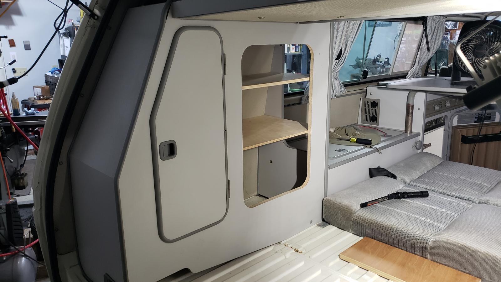

Took a deep breath and cut a new opening in the coat closet. The hole is sized for a fridge door, but I have a roll-up tambour door I’ll be installing. Also added two shelves to maximize use of the space.
I’ve ordered the trim from Bus Depot, does anyone know what size router slotting bit is needed?
More info on tambour door you are going to use please. Also a follow up when done. This is on my list of thing to do.

PostPosted: Fri Aug 01, 2025 2:56 pm    Post subject: Re: What did YOU do to your van today? Reply with quote
I saw a post a while back from someone who did this. I showed it to a buddy of mine and he made one for his van, and made one for me also.
Here’s a pic of what he gave me. I’ll start a new thread when I get the tracks and begin the install
‘88 2wd Auto Westy project

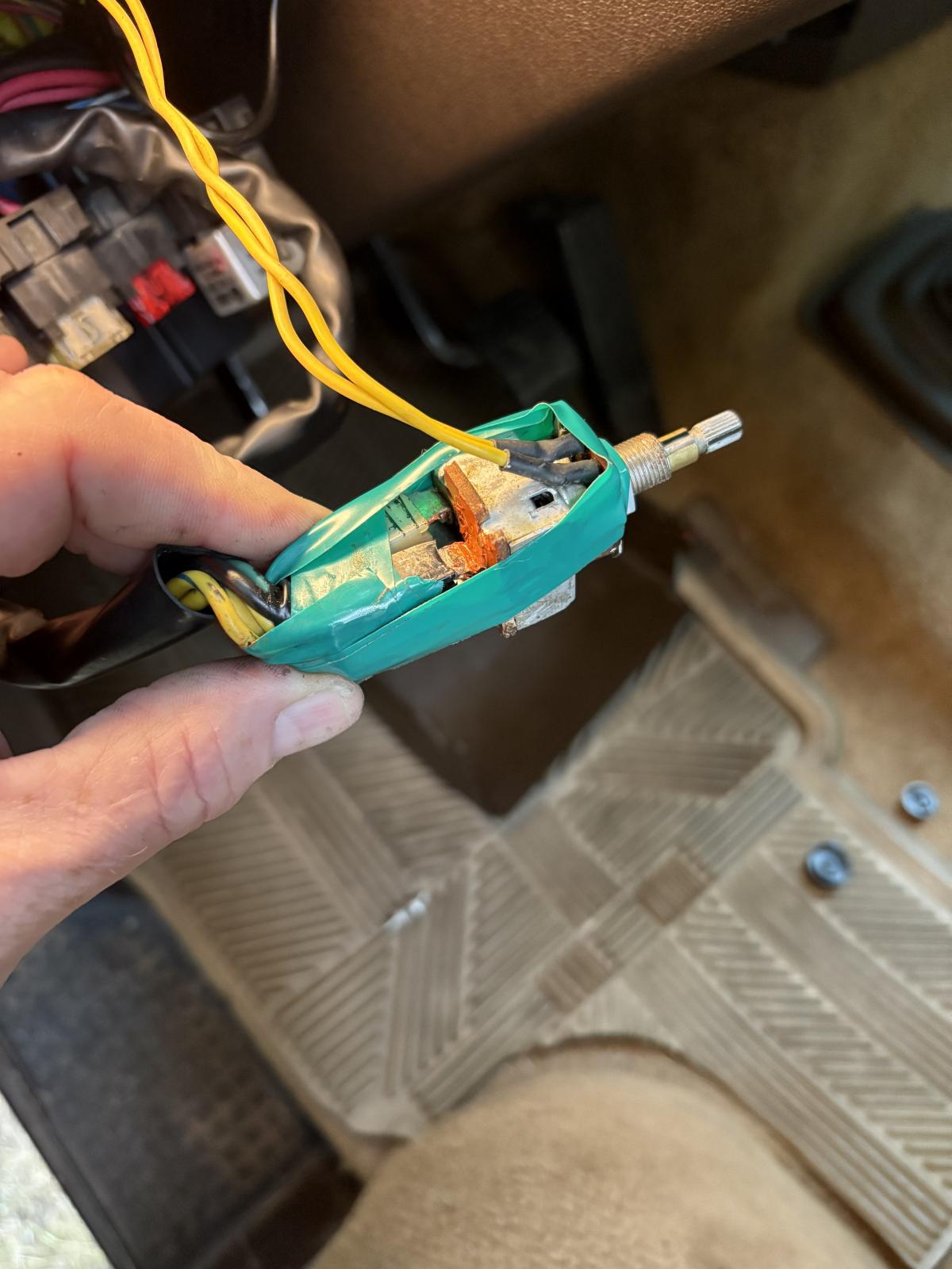

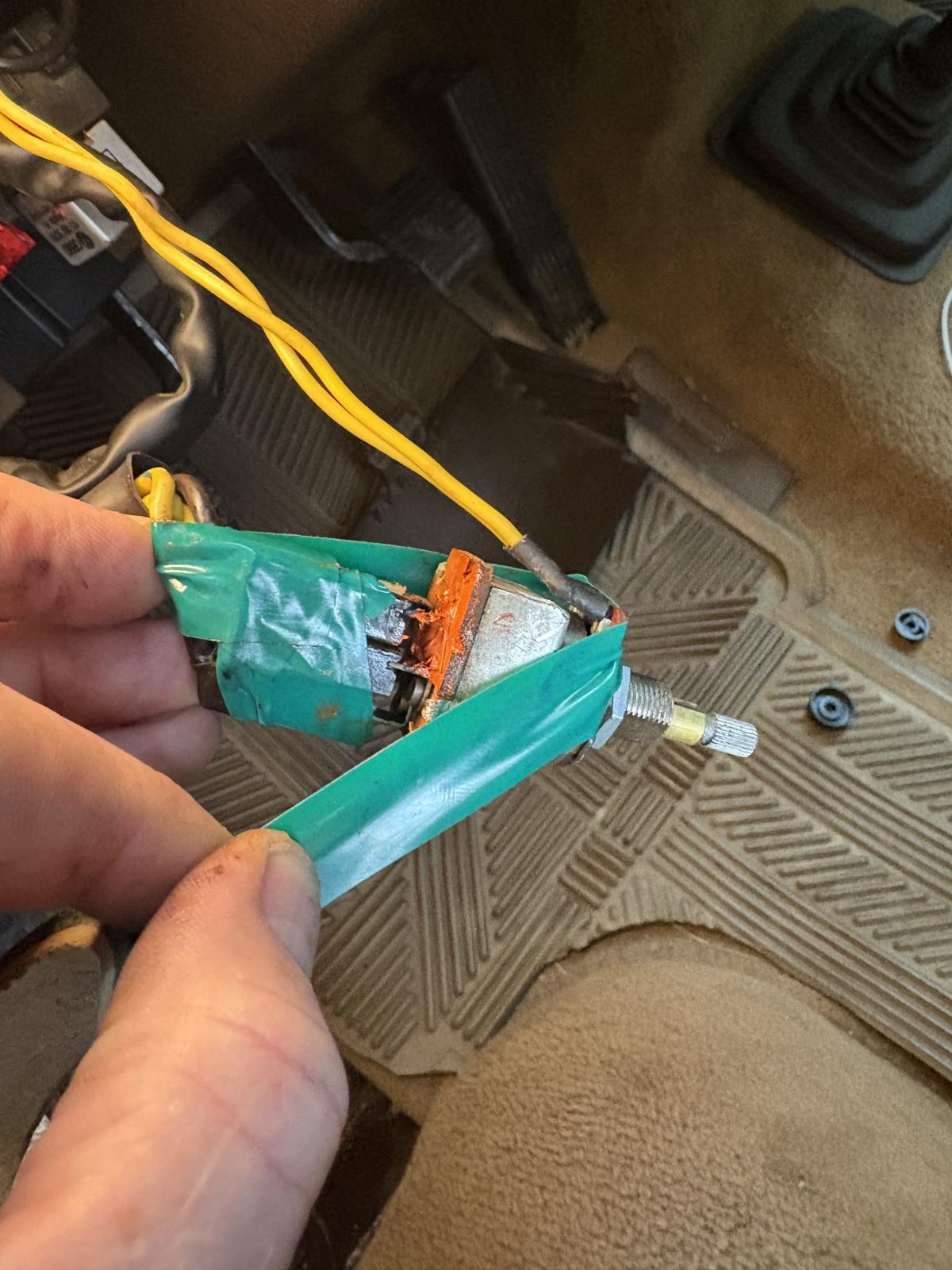

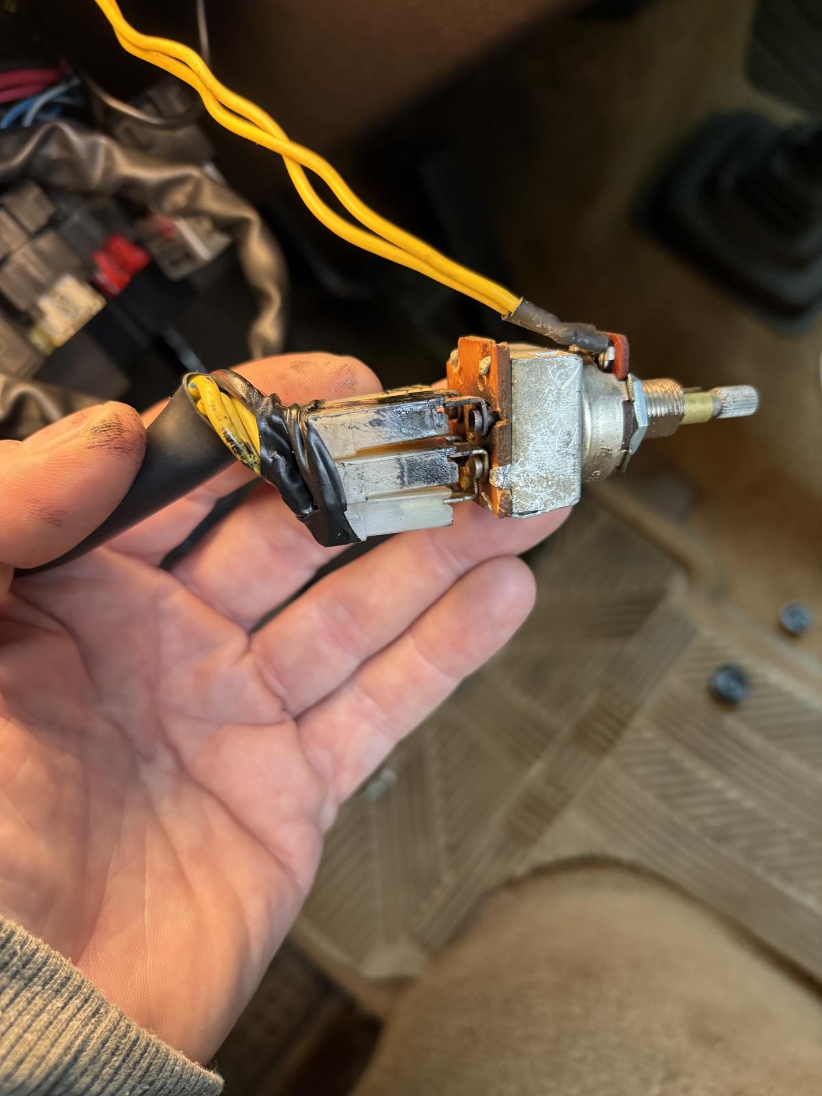

Dealer installed air conditioning switch repair.
Just a bit of a road hack repair on the a/c switch. The ground overheated itself off over time so after taking the switch apart and cleaning it up I’m using some copper RTV and some creative electrical tape work to hold the ground in position until I get the proper GoWesty switch.
