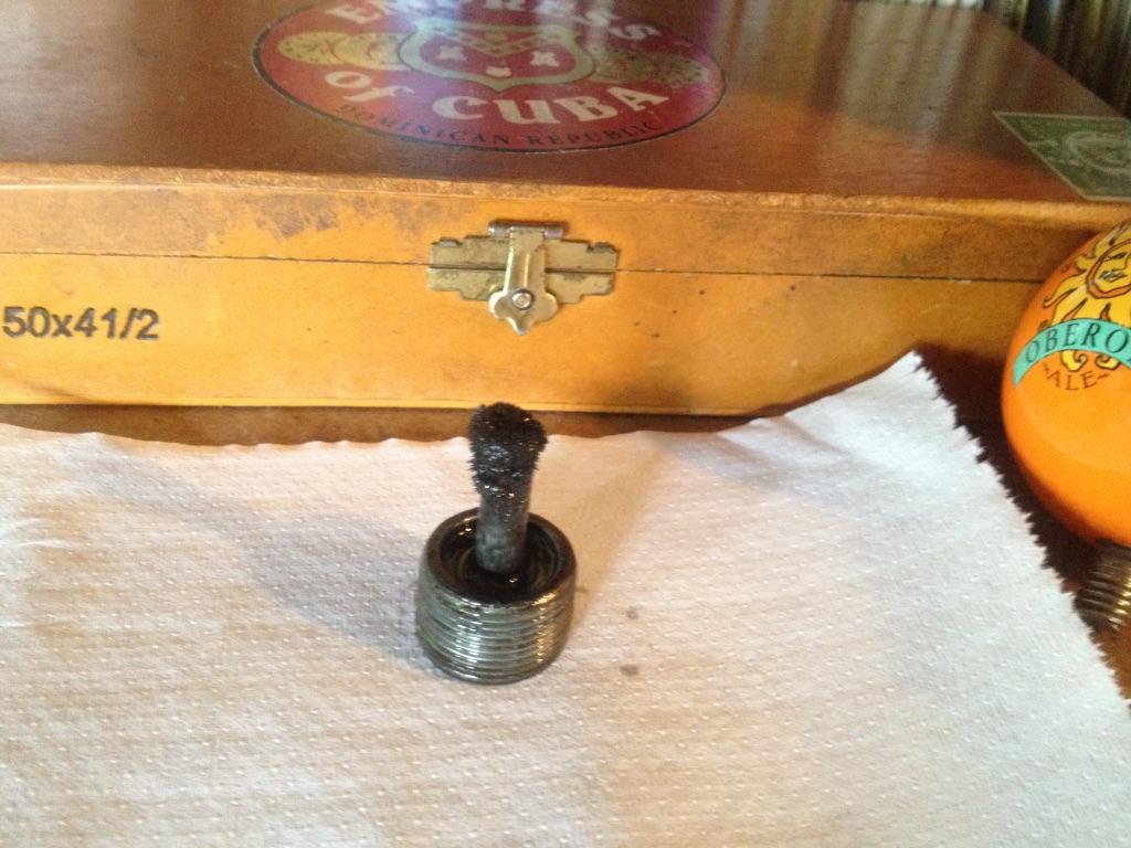

riceye wrote:
...in 2012 at 172,000 miles after some really negative comments about Redline here on our forum. A little over 50,000 miles. This was the plug at that time:
....Anyway, here is the plug yesterday. I've accumulated about 65,000 miles since the 2012 fluid change.
Knock on wood!
so you use that 50x41/2 box to knock on ;-P
what's the story on that box, you've had it a while. a little more patina over the last 13 years.

vanis13 wrote:
Knock on wood!
Haha! Yeah, it was my father-in-law's. He used to love a good cigar.
It's just the right size to contain my evening chilling-out fun supplies.
