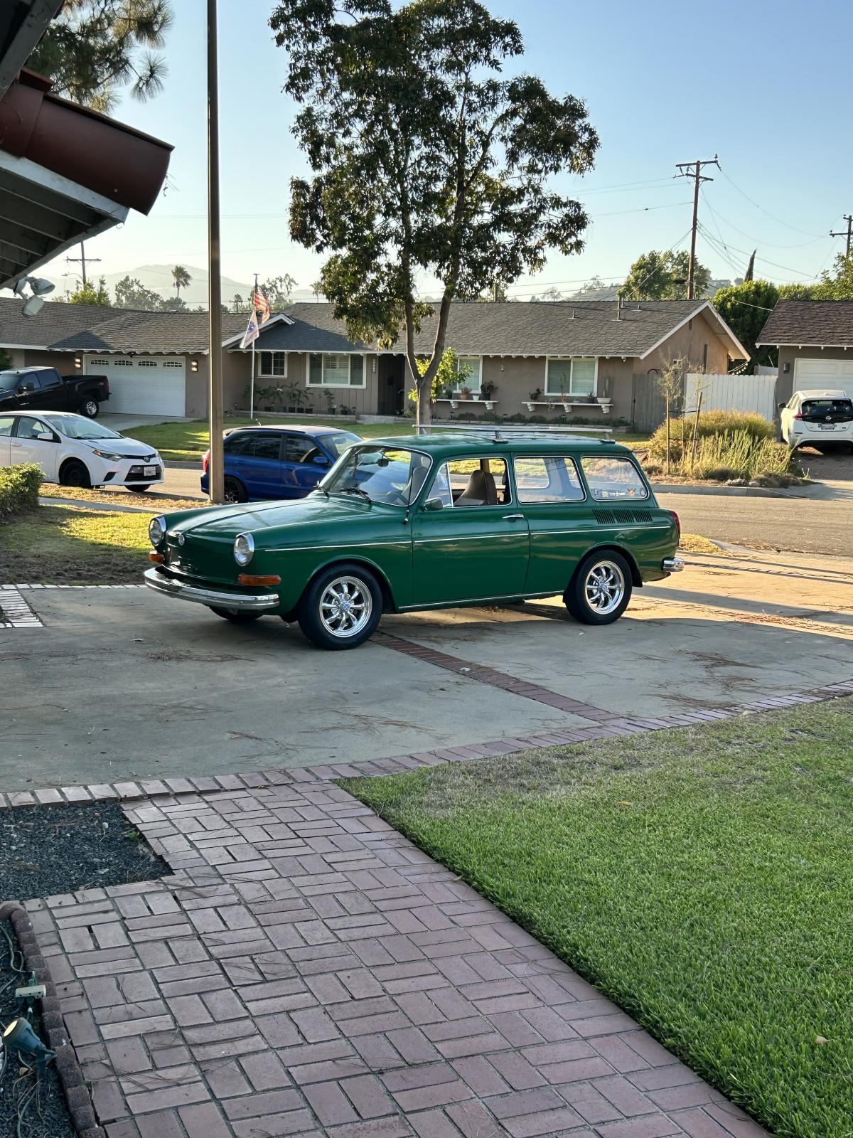

PostPosted: Sun Jul 13, 2025 3:25 pm    Post subject: Re: Another Pickle Post - 1973 Squareback Reply with quote
Reinstalled the air cleaner with some fresh oil, and reconnected the starter/ignition cable (after removing the remote starter). Turned the key, got the fuel pump going, she started right up and idled nicely. Went through the gears lightly while up on Jack stands in the driveway. All of them work Very Happy
Now down to the FLAPS for some fresh oil. I’m going to replace the solid cover plate that came on the ‘73 and replace it with one that has a drain plug. Just seems cleaner/easier for future oil changes.

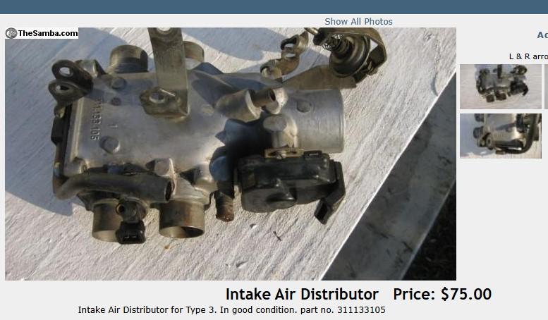

I found this photo of a spare IAD that I am pretty sure came off of either a 72 or 73 type 3.
The tube bending around from the back cover of the IAD is where you will connect your crankcase vent valve. Pay no attention to the TVS that is installed in that photo, it came from a Volvo and I was seeing if it fit for a custom application. You can also see the threaded hole for the temp sensor in front of the intake runners. I believe that location should be the same for your year. I hope this helps!

Thanks for the pic, I’ll look again when I get back from Portland, but I’m pretty sure that tube doesn’t exist on my IAD.

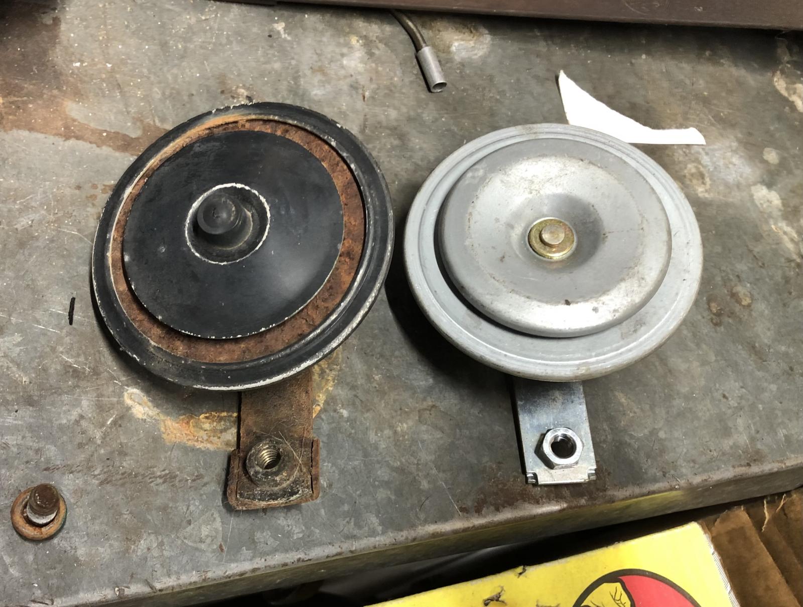

Meanwhile I’ve gotten her one step closer to road-worthy by installing a functioning horn. Meep Meep.
