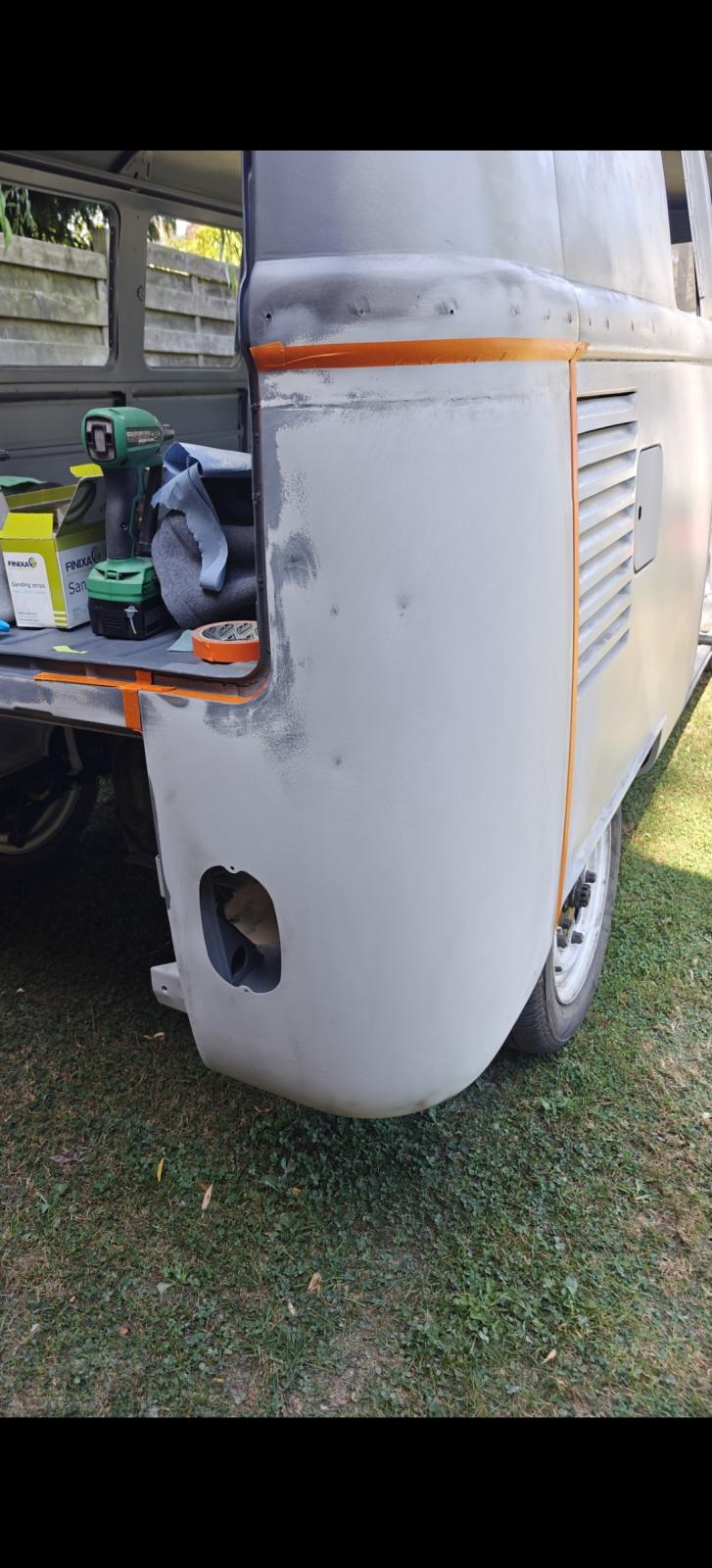

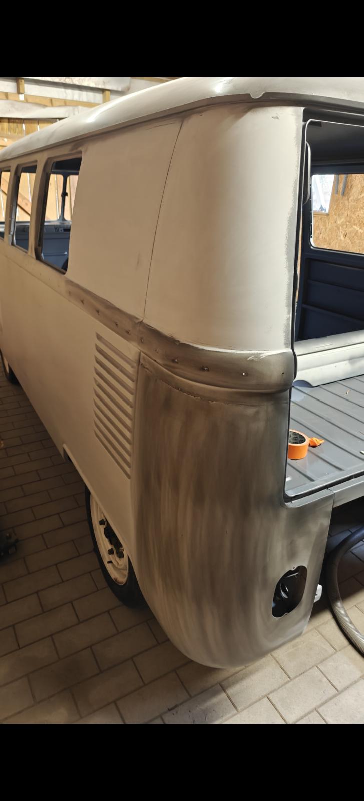

PostPosted: Tue Aug 19, 2025 6:56 pm    Post subject: Re: 11 window 1966 full resto Reply with quote
No real exciting updates..
Bodywork stage has began!
Also painted my engine lid in Titan red but got a lot of orange peel!!
Don't know what caused the problem.. temperature? Spray gun settings? Rolling Eyes
