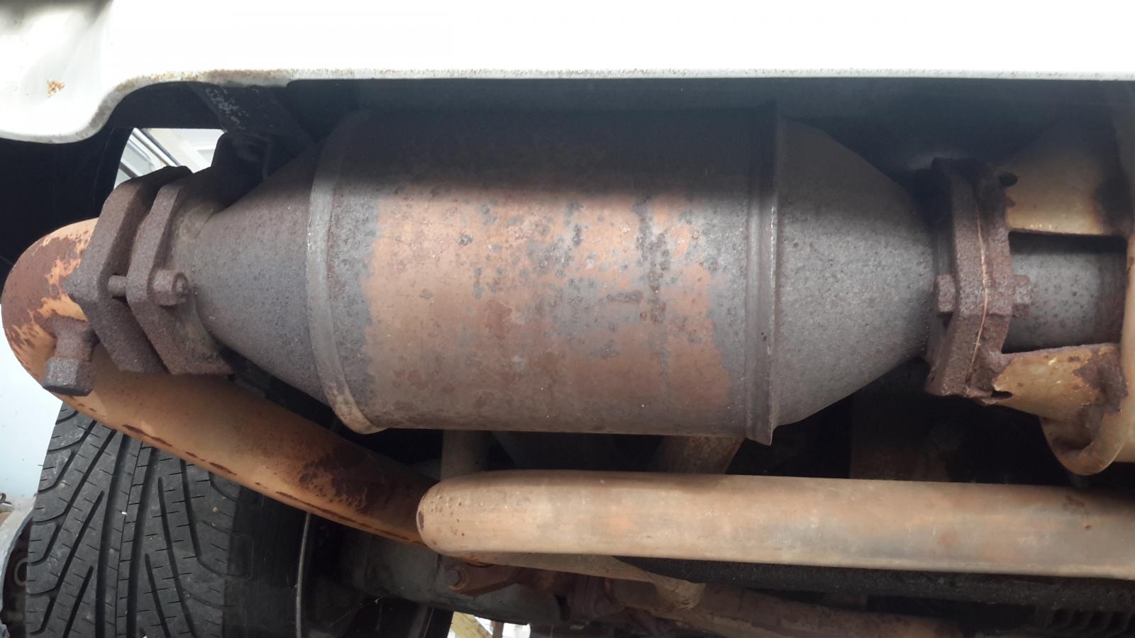

Removed my CAT today, with the muffler. Easier to get to the bolts on the outlet side of the CAT whilst out of the car. Had to remove the muffler brackets to get it out. It appears to be the original equipment.
Visual inspection on the inside of the CAT looks like there is nothing wrong with it. It's intact, and I can see through it. Two years ago my '88 2.1 did not pass smog. I replaced the oxygen sensor , and the coolant sensor II.
My smog guy said " next time you need a smog check, replace the CAT."
Does this look like it needs to be replaced ? It looks clean, and you can see through it.
Can the CAT be bench tested ? d'oh!
Original muffler looks like it's seen better days. I'm thinkin, stainless !

PostPosted: Sun Sep 25, 2016 8:20 am    Post subject: Re: CA Catalytic converter - Magnaflow 339918 Reply with quote
a cat can look fine, but be dead. I know of no bench test, you put it on the car and test to see if it passes the smog test or not.
a new cat will last a long time if only bolted up for the smog test and promptly removed to a safe space in your garage between test dates. Twisted Evil
