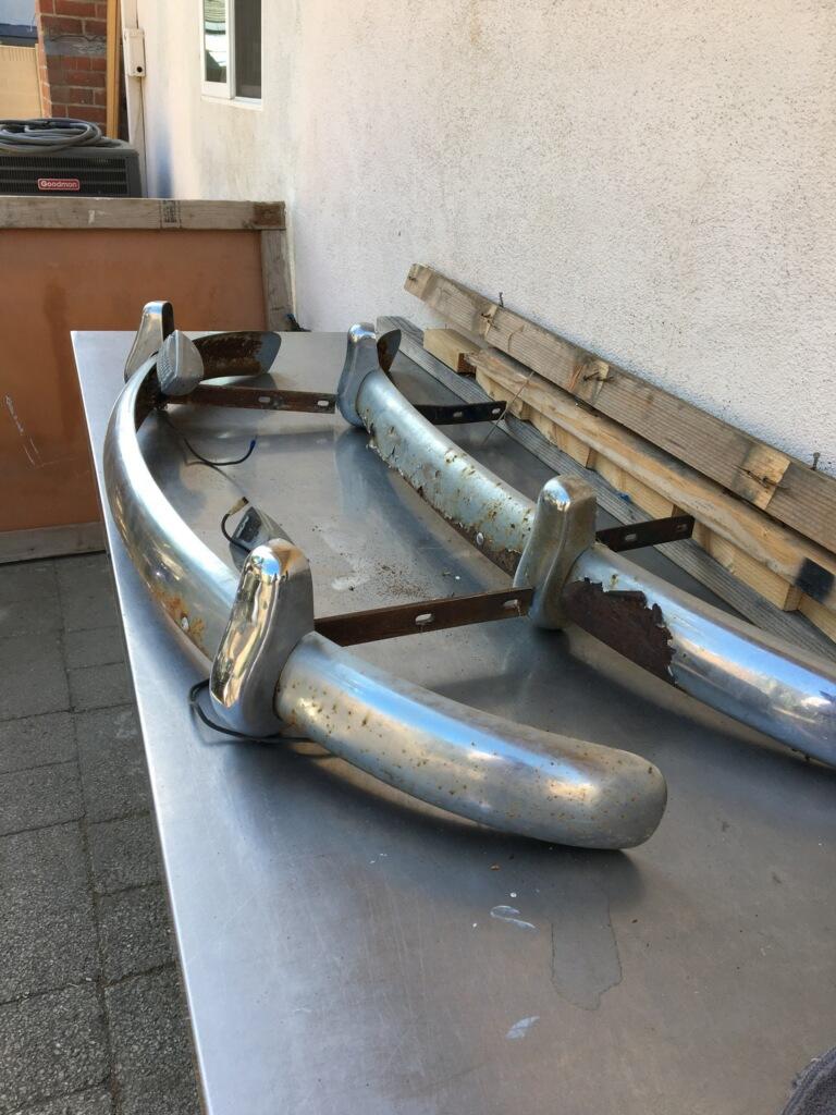

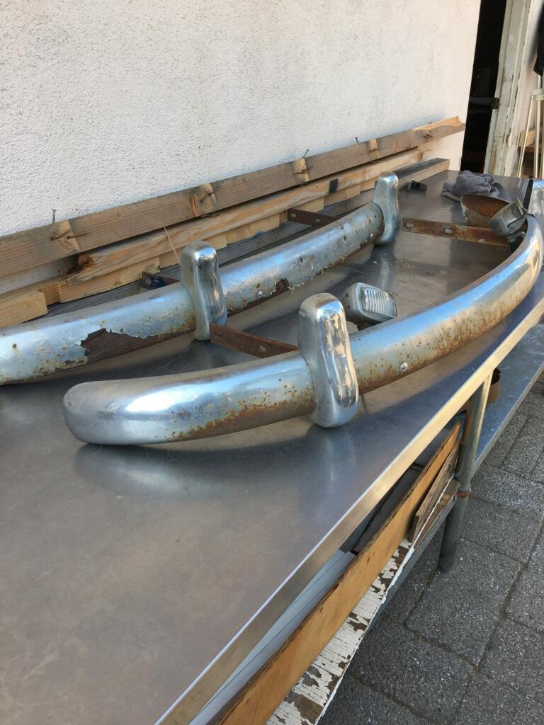

Good morning,
I found some euro bumpers that were on a 1959 bug and when I started cleaning them i noticed a stamp on the back “made in Brazil” along with 4 characters numbers. Would anyone know if they are original I can’t seem to find any other ones to compare to.
The original bumpers on a '59 would be German, especially if it is a European car. They would have a VW stamp or LMB stamp.
I suspect that the fenders have just been replaced at some point in the car's life.

PostPosted: Thu May 22, 2025 8:03 am    Post subject: Re: '58/'59 Beetle Discussion Reply with quote
TERGAL was a brazilian aftermarket bumper brand back in the 80's and 90's.
