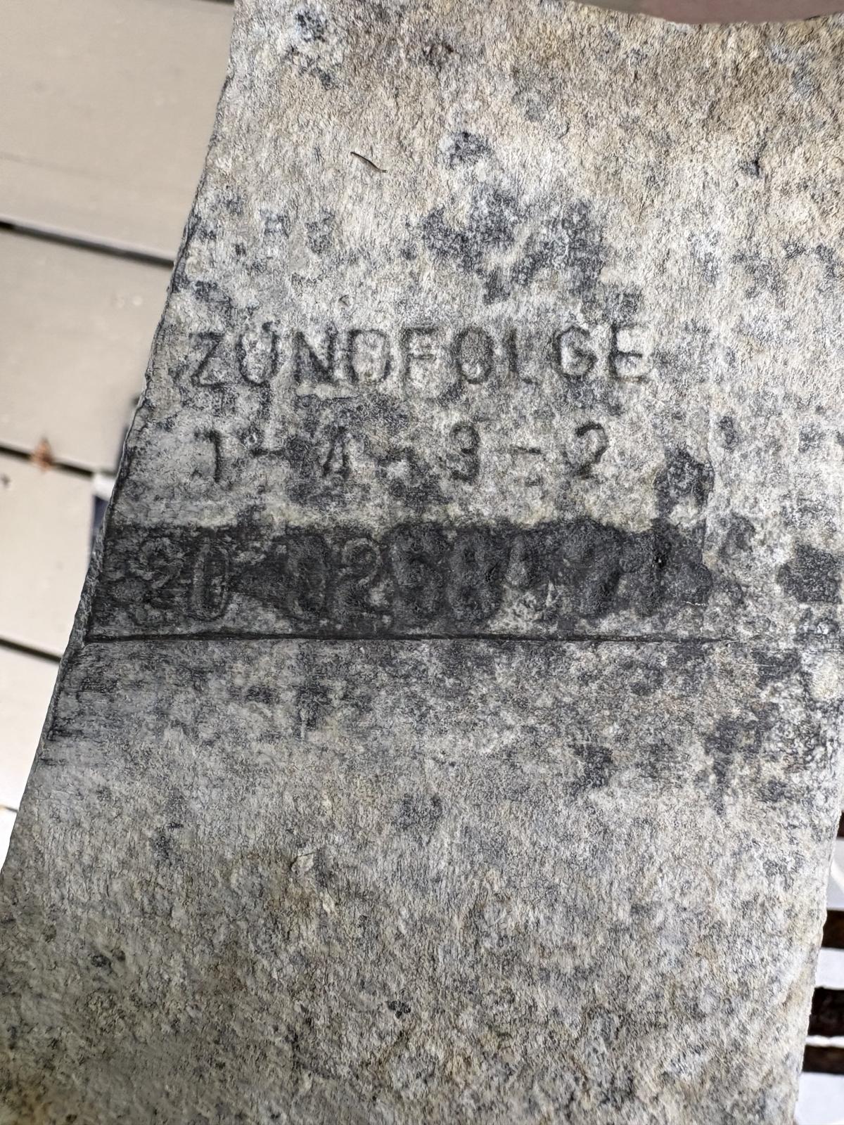

While taking a photo on vacation, I happened to see this half engine and a complete gearbox. Could this be a very early engine and gearbox? Unfortunately unusable!

dec 1950 engine number?
Posts: 71610
PostPosted: Fri Aug 01, 2025 11:18 am    Post subject: Re: Could this be a very early engine and transmission ?? Reply with quote
What is the engine #?
It looks like -20-0258???
This is from Dec, 1950
Do you have any photos of the numbers on the left side of the generator stand?
The transmission is Barndoor Bus too but I can't tell if it's super early.

PostPosted: Sat Aug 02, 2025 11:49 am    Post subject: Re: Could this be a very early engine and transmission ?? Reply with quote
Looks like it.
20-0258521 ?
2nd to last digit is the most difficult.

The other number on the generator stand is -264586-

PostPosted: Thu Aug 07, 2025 9:26 am    Post subject: Re: Could this be a very early engine and transmission ?? Reply with quote
There are not normally numbers on the right side of the generator stand like that.
Are there any small numbers on the left side?
They would be in small circles, like this:

PostPosted: Fri Aug 08, 2025 11:44 am    Post subject: Re: Could this be a very early engine and transmission ?? Reply with quote
ok, here they are

What do these numbers mean? I'm only familiar with Beetles and VW 411s.

PostPosted: Fri Aug 08, 2025 3:49 pm    Post subject: Re: Could this be a very early engine and transmission ?? Reply with quote
Ooops, I thought I had posted the Forums thread about the numbers.
Engine Case Production Date
https://www.thesamba.com/vw/forum/viewtopic.php?t=380362
13 11 20 = 13th of November, 1950
2 means 2nd shift in the factory

PostPosted: Sat Aug 09, 2025 1:58 am    Post subject: Re: Could this be a very early engine and transmission ?? Reply with quote
ok, thats an early one. thank you.

PostPosted: Sun Aug 10, 2025 3:52 am    Post subject: Re: Could this be a very early engine and transmission ?? Reply with quote
I wonder if the second number stamped into the side of the generator stand is/was the body number or VIN of a bus.
Even if it's no barndoor era bus VIN# it could easily be a beetle or early Wolfsburg VIN, that the engine may have lived in later on.
it's not impossible that some countries may have mandated the VIN to be included on the engine case and/or it could also just be a refurbishing number.
