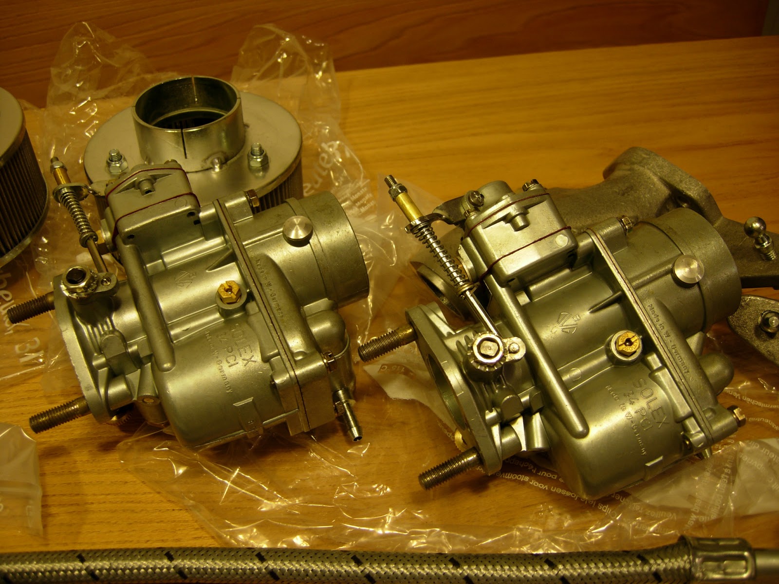

[email protected] Samba Member
Joined: June 24, 2015 Posts: 935 Location: Rialto. CA
Posted: Thu Aug 07, 2025 2:58 pm Post subject: Re: Solex 34 pci parts and info - someone in germany? |
| Does anyone know if the top of these 2 34 pci carbs are interchangeable..looks like i have a NSU version.. but i like the bmw top since it has the treaded fuel line .. at first I was like hmm I have plenty of the solex 28pci carbs let me try one of those and nope the solex 28pci top is shorter / dont match....so im on the look out for a bmw solex 34 pci top for my nsu carb but thats if they are interchangeable....anyone have an extra bmw solex 34 pci top ??? |
