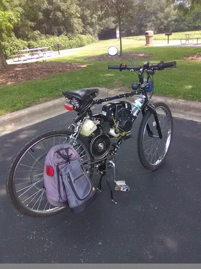

Good news.
My brother (the one in the Artic Circle pic, who has driven to Dead Horse twice and once to Inuvik on his motorcycle but for the last 5 years has given up/sold his bike and taken to watching Maury) is now putt-putting with me on day-trips. We load the putt-putts onto his pickup, go out to a destination, putt-putt down slow country hard roads to another destination then return.
Finally, not so many circles. Smile
PP1=1st putt-putt, PP2=2nd putt-putt
After 1000 miles PP2 is doing remarkably well. No major issues or failures...but
Clutch shoe lining is about 1/2 gone but the drum shows very little wear (harden steel). It looks like I should get about 2000 miles on a set of $8 clutch shoes. Not bad when you consider this is a weed-wacker centrifugal clutch and engine ment to spin a plastic line not haul me around.
I did have to work on the clutch shoes spring tension. Initially, the clutch would start to engage around 5000 rpm, too high. I stretched the spring until there was a little light between the coils. Now it starts engaging around 3200 rpm. (the 4 cycle engine has a rpm range from idling around 2600 rpm to 6000+)
Both engines like to run a little rich. There's a mixture screw hidden down the center of the carburetor's throttle/shaft for adjustments.
To start them cold I set the choke, pump the priming bulb 12 times and both will usually start on the second pull. Idle to full throttle and back is steady and smooth. Whether it's hot or cold outside the Lifan 139f performs well. There are many 139f's out there. I can only testify to the two I bought a couple years ago from Home Depo (supposedly with cast iron cylinder sleeve).
Due to my legs and knees, it's easier for me to ride PP2. My brother, who can pedal more, rides PP1.
Pro PP1:
1) Mostly a pedal bicycle with 14 gears.
2) A more pleasent riding experience; noise, smell, heat from engine are behind me.
3) Able to start engine while on bicycle pedalling.
4) Simpler drive train with good drive belt life.
5) Removable engine assembly; to flip bike to repair rear flat.
6) Deadman feature; let go of the clutch lever and it disengages.
Con PP1:
1) Harder for me to get on/off and ride.
2) Need to pedal to 7-8 mph before fully engaging clutch.
3) Back end is top heavy; harder on spokes, tire and tilting bike while mounting.
4) Having to work a manual clutch.
5) Poorer distribution of weight between the wheels.
Pro PP2:
1) Easier to get on/off tilting the bike.
2) Good life on centrifugal clutch assembly and drive belts.
3) Can start from 0 mph with or without pedaling.
4) Automatic clutch; easier to start/stop and signal while riding.
5) Can remove rear wheel while PP2 is upright on its stand.
6) Good distribution of weight between the wheels.
Con PP2:
1) More putt-putt than pedal bicycle.
2) Noise, smell, heat and a bulky engine between my legs.
3) Sometimes harder to pedal-assist (uphill) with only 1 gear.
4) Belts and pulley/ratio drag makes it difficult to pedal with engine off.
5) Can't start engine without a pull cord.
6) Has 3 v-belts instead of 2.
