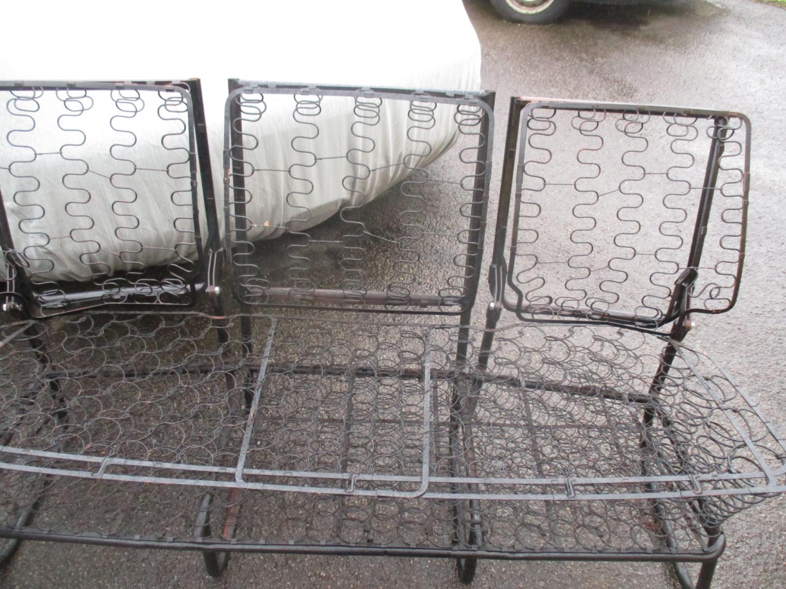

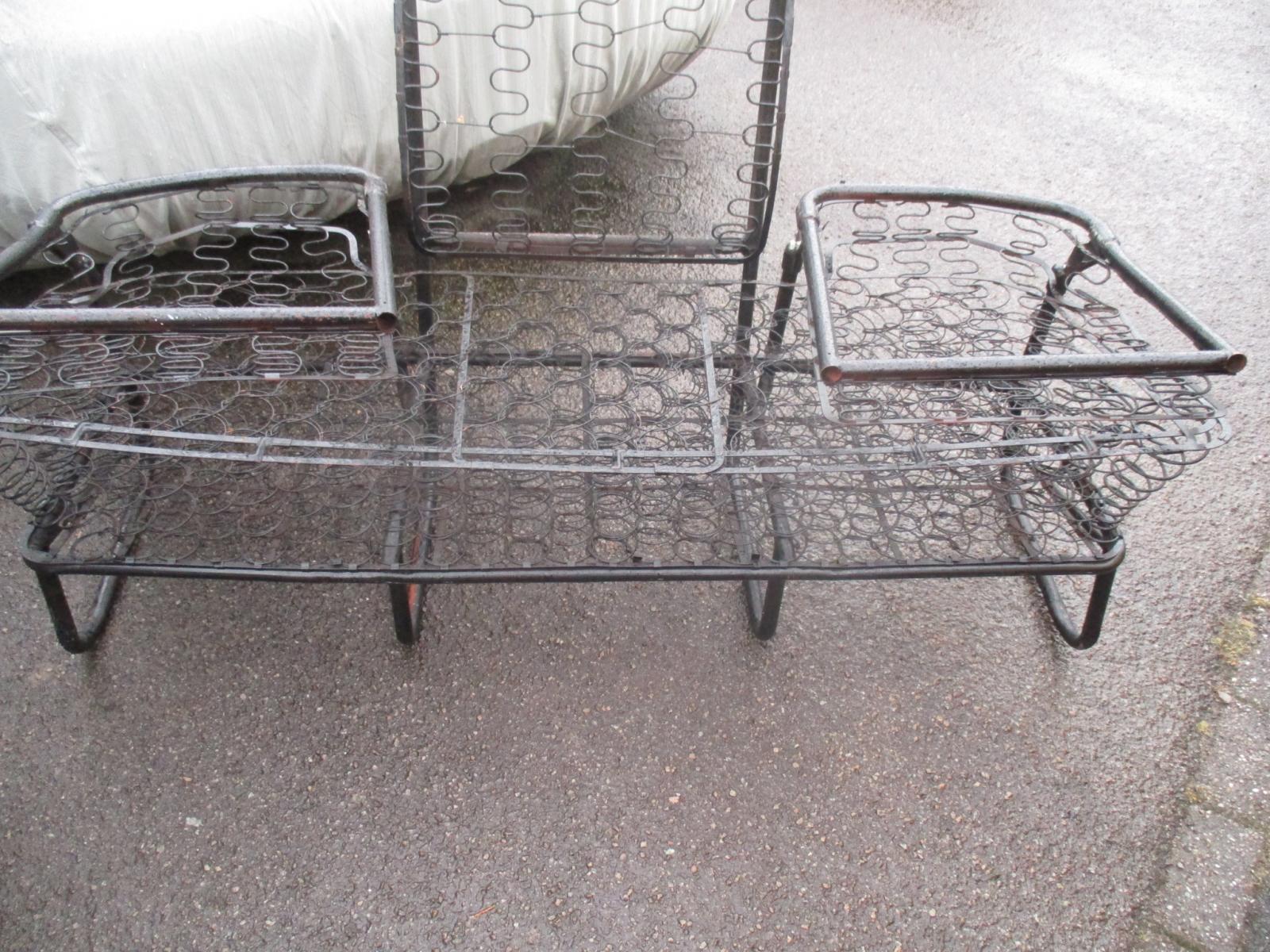

I have the original Microbus seat frames (inc the double flipper middle) so that is a possibility...
I also have an original Dormobile Interior (with seats) with metal units for the rear, the favoured option repainting units to match body colours...
a sticking point in both is the interior panels and front sets were nicely retrimmed in a hardwearing vinyl that looks ok.... I could match it I am sure it is still made...
Do I retrim everything in Original materials? inc both sets of rear seats...

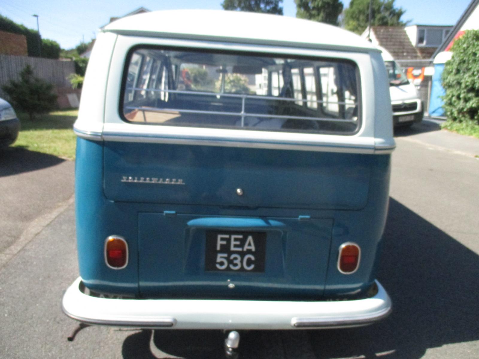

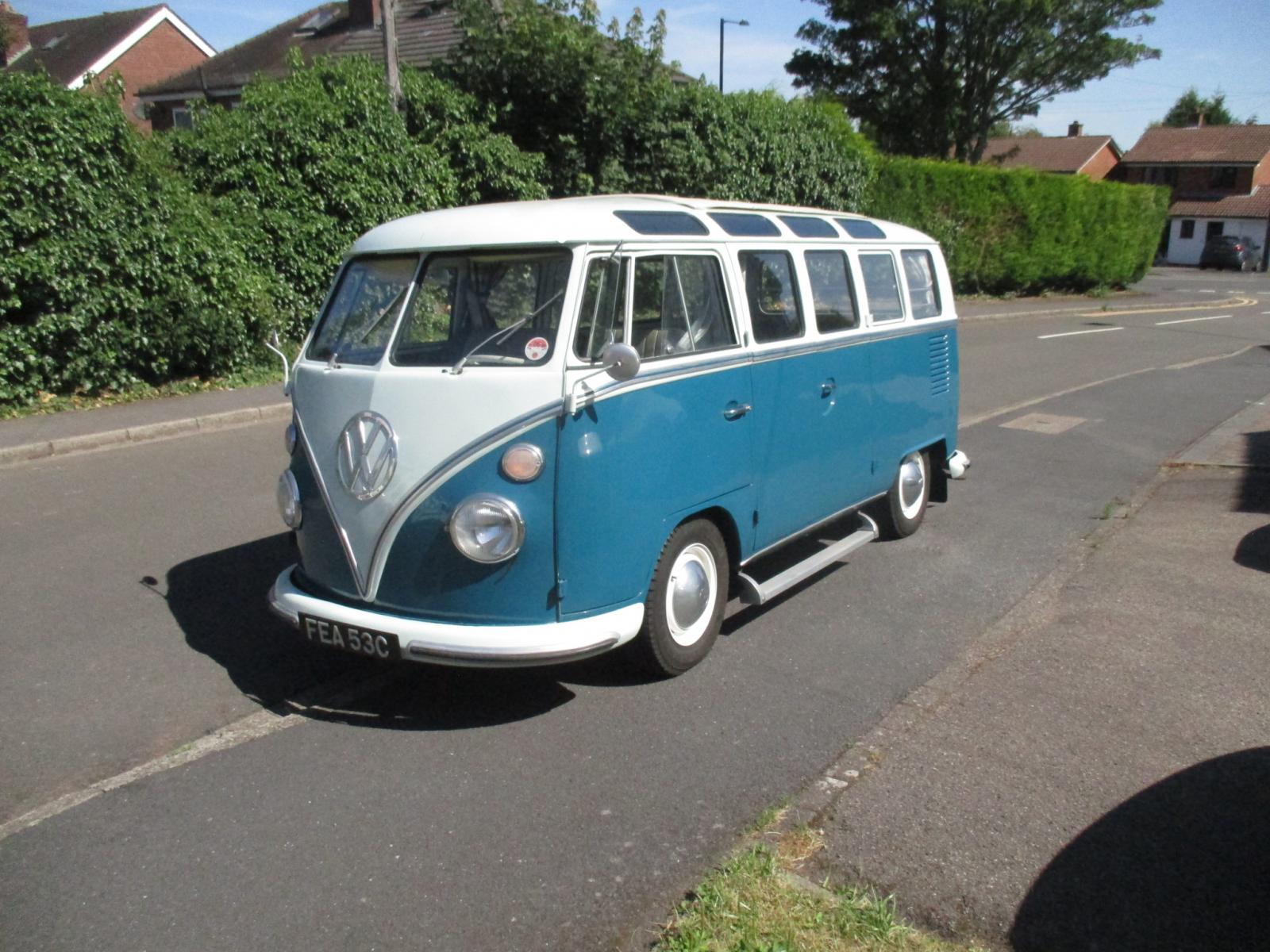

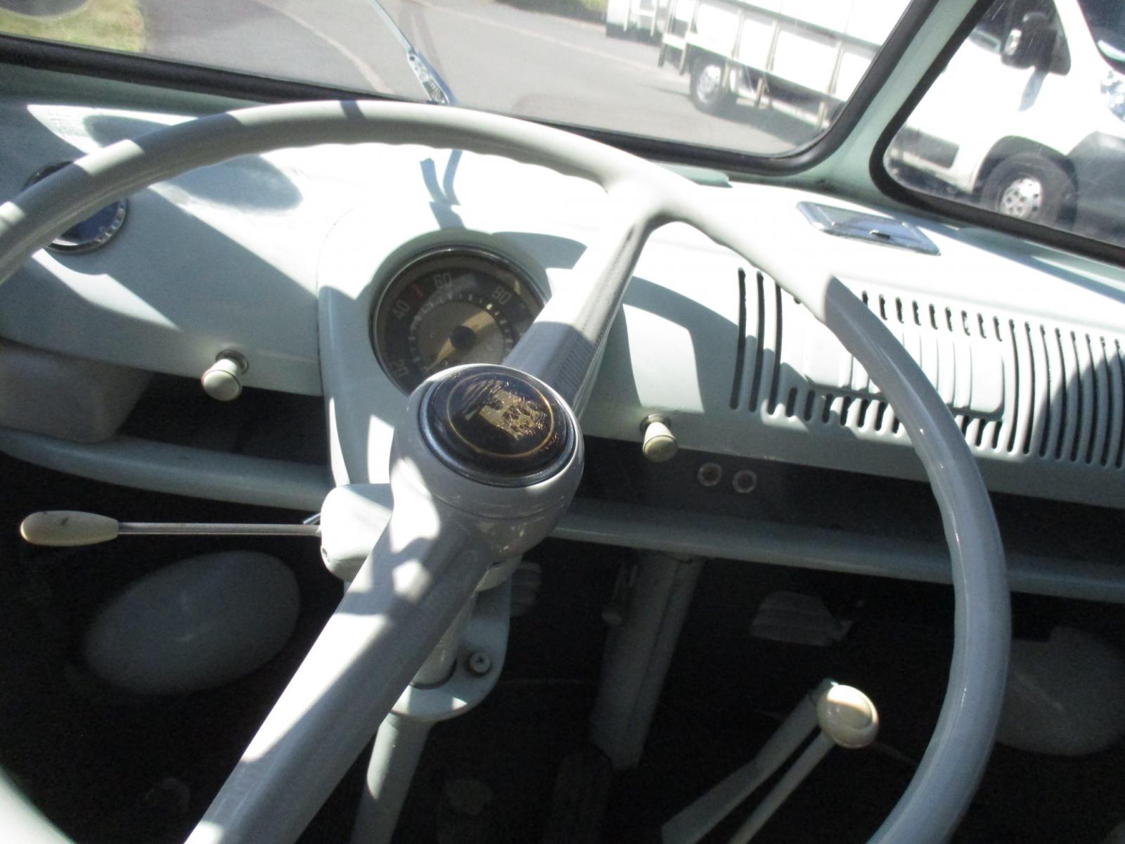

I have added a few images to the gallery

PostPosted: Tue Aug 12, 2025 5:02 am    Post subject: Re: Samba double door out of hibernation Reply with quote
Can’t tell for sure from your pics but, typically, at least here in the states if you say you have a double door that implies you have passenger doors on both sides of the bus. In other words four doors plus the two cab doors. They were quite rare. The middle seat being unobtainium. If you have just the two passenger area doors-either side, it’s not called a double door.
A double door panel

PostPosted: Tue Aug 12, 2025 11:32 am    Post subject: Re: Samba double door out of hibernation Reply with quote
opps missed the other picture out... but yep it is a Double door!!!!

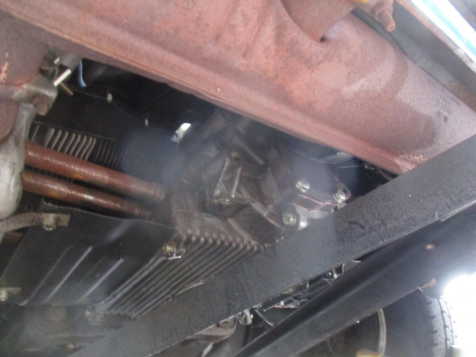

PostPosted: Tue Aug 12, 2025 12:59 pm    Post subject: Re: Samba double door out of hibernation Reply with quote
BigVTwin wrote:
Nice bus!! Definitely get the spark plug clips into the fan shroud and the cables into those. Having the clip holes open is wasting cooling air and the cables do better insulated from metal parts of the engine.
Needs the hose clamps on both ends of both fresh air tubes. When either of those tubes pops off the head on that side goes way in temperature, and the engine runs much hotter....
Also suggest a proper year German carb and matching vacuum advance distributor, it will make your bus run much nicer to drive when doing back roads and about town.
This thread might interest you:
https://www.thesamba.com/vw/forum/viewtopic.php?t=395732

Looking at the engine tin some more, think you might be missing the right side rear of #2 cylinder tin piece. If missing, not good for long term of that cylinder.
When you can, please post images looking up underside of the engine. Just forward of the muffler, showing the rear of the engine case and rear of the # 2 & #4 cylinders.

will do, but I am quite sure mechanically he brought everything, the guy who restored it did do a few trips from the UK to Germany via Belgium and all was well...
but more than happy to put things right that are not correct or would benefit the vehicle...
things like teh clips etc you pointed out were missing some pics of what I need etc would be good...
Really busy at the mo with other stuff but will see what I can do at the weekend...
All help advice etc is greatfully recieved many thanks..
Also things like the air tube clips.. are they specific VW ones ?
quick pics of underneath engine
and a couple of pictures of that elusive stuff unobtanium...

Those two rear pieces of cylinder tin are prone to falling off when the screws loosen up from engine vibration. Guess how we know... From your inside the engine compartment images it looks like the left screw is missing for that right side lower rear tin. The hole for the screw is just to the right of the oil filler down draft tube where it passes thru the horizontal tin.
Noticing that the DPO used Allen headed bolts instead of the stock cheese head screws. Not stock, but not totally a dumb idea. The stock tin screws are hard to get the 6 Ft Lbs. of torque on them to fasten them down properly. Still for 90% of the places the stock screws work fine even if one does not torque them down properly. With the exception of those two lower rear tin pieces and the removable rear half of the sled tin that attaches to the right heat exchanger.
Here is an image from the 24 mile from factory 65 beetle engine showing 2 of the 3 spark plug clips.

The hose clamps?? If so, those did have a nice VW stamp on each, but main thing is any hose clamp will work to keep the air hoses from popping off.
BTW your heat exchangers are modern cheap repros. You should seek original German VW ones instead, even a pair that needs some welding to fix up. The Dansk repros you have do not recover heat off the exhaust well to heat the interior, but more importantly they do not cool the engine very well in warm/hot weather.

Here is a really good image to see the internal difference between OG and repro heat exchangers:
Much more on how the heat exchangers work:
More on how the whole heating and cooling system works:
https://www.thesamba.com/vw/forum/viewtopic.php?t=434051&highlight=heater+tutorial
Sure it is more beetle orientated, but the engine is very much the same as bus. Air cleaner and muffler is the main difference between the two.[/url]
