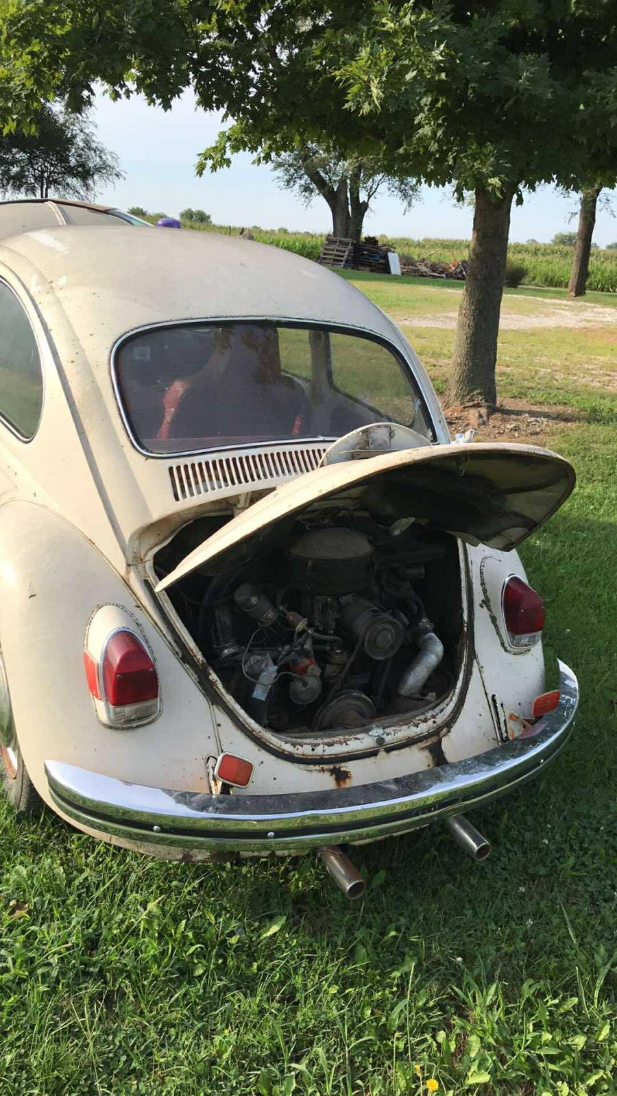

I'm looking at a 1970 T1 and the guy admits it won't start/run.

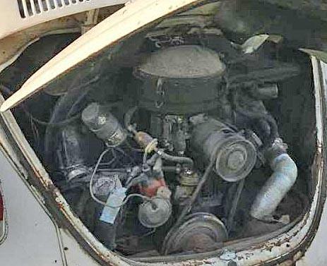

He sends me a pic of the engine and the first thing I notice is the filter is on backwards!

If you can post the picture that was sent to you, more "faux pas " may be revealed.

Not a very good pic, but have at it!

Hard to see any detail on that photo. I can see the left side fan housing tube to the muffler is either missing or not connected which if run like that for a while is not a good sign. Kind of surprising to see the one year only reflectors on brackets from the bumper still there. Alot of those are long gone.
Posts: 71611
PostPosted: Sat Aug 16, 2025 4:15 pm    Post subject: Re: Consequences of a reversed fuel filter? Reply with quote
It looks like maybe the vacuum line came off the carb.
I'm not sure that would affect idle but it could drive like crap with the distributor not advancing

That vacuum line has definitely seen better days.
