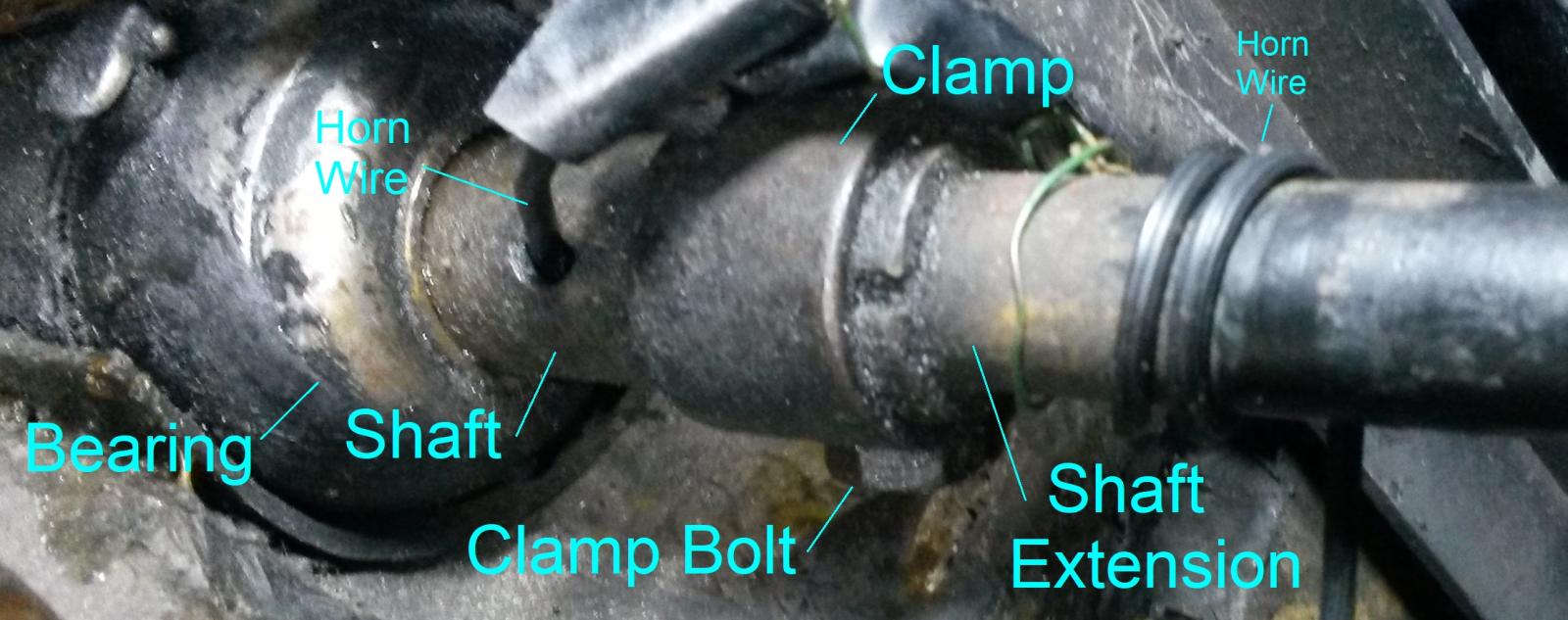

Mine's wired as Dale describes. It's a 1965 and does have a hollow steering shaft, into which I've clamp'd a solid extension:
