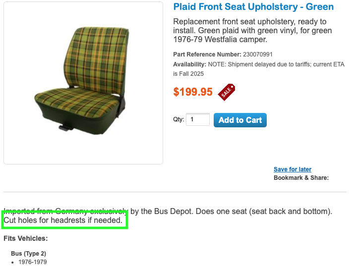

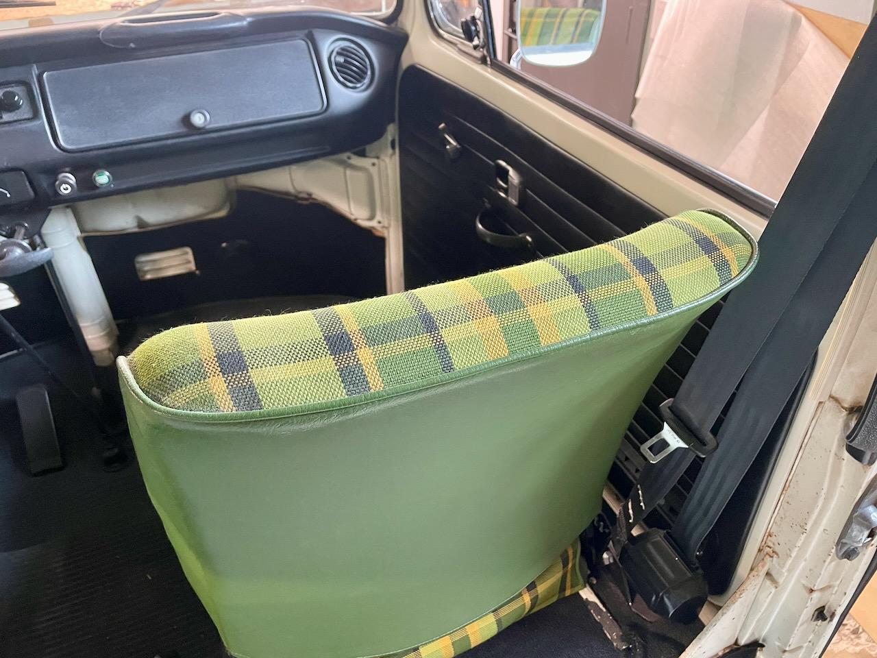

I too am very interested in adding head rests to my 1978 bus. While my bus was originally 'Canyon Brown' the front seats were previously reupholstered in Westfalia Green (which I am a big fan of).
I have 'pressed' on the back of the seats and confirmed that the 'tubes' are indeed in there.
I have discovered that these exact covers are sold 'as-is' by Bus Depot, so I assume the PO purchased them there.
I also see that their description simply says "Cut holes for headrests if needed", so I was wondering how difficult this procedure is, and led me to a few questions:
- Does one simply cut circular holes through the material at the relevant locations?
- Does one do this with the upholstery installed? (to ensure the holes are in the right location?
- Or, do I need to mark the holes and remove the upholstery in order to cut this?
- What stops the material from stretching or tearing any further at the hole location?
I would love to hear from someone that has already done this procedure successfully so that I can do it right.

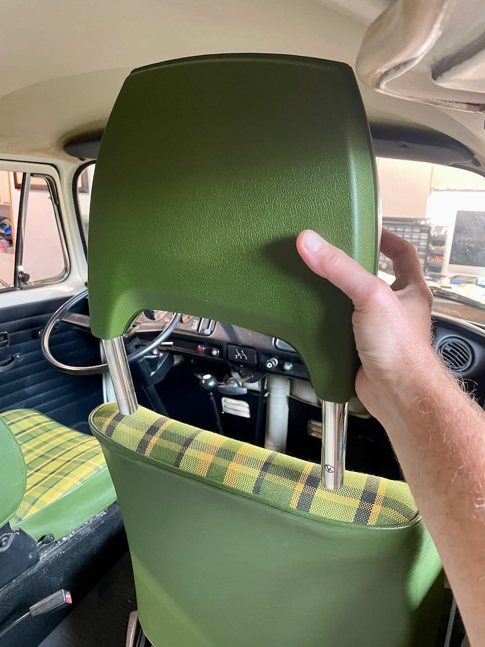

My bus did originally come with head rests and I can feel the supports inside the seat (similar to the first picture in this thread).
jrasi wrote:
If you have the headrest with you, could you measure the outer diameter of the leg, that goes in to the seat? I don't have headrests yet, but I need to fabricate the supports.
Here are all the dimensions, however, you also need a pair of headrest guide sleeves (Part: 211-881-861)
Headrest Leg: 22mm
Headrest Guide Sleeve (Inner): 22.5mm
Headrest Guide Sleeve (Outer): 26mm
Headrest Guide Sleeve (Flange): 40.6mm
