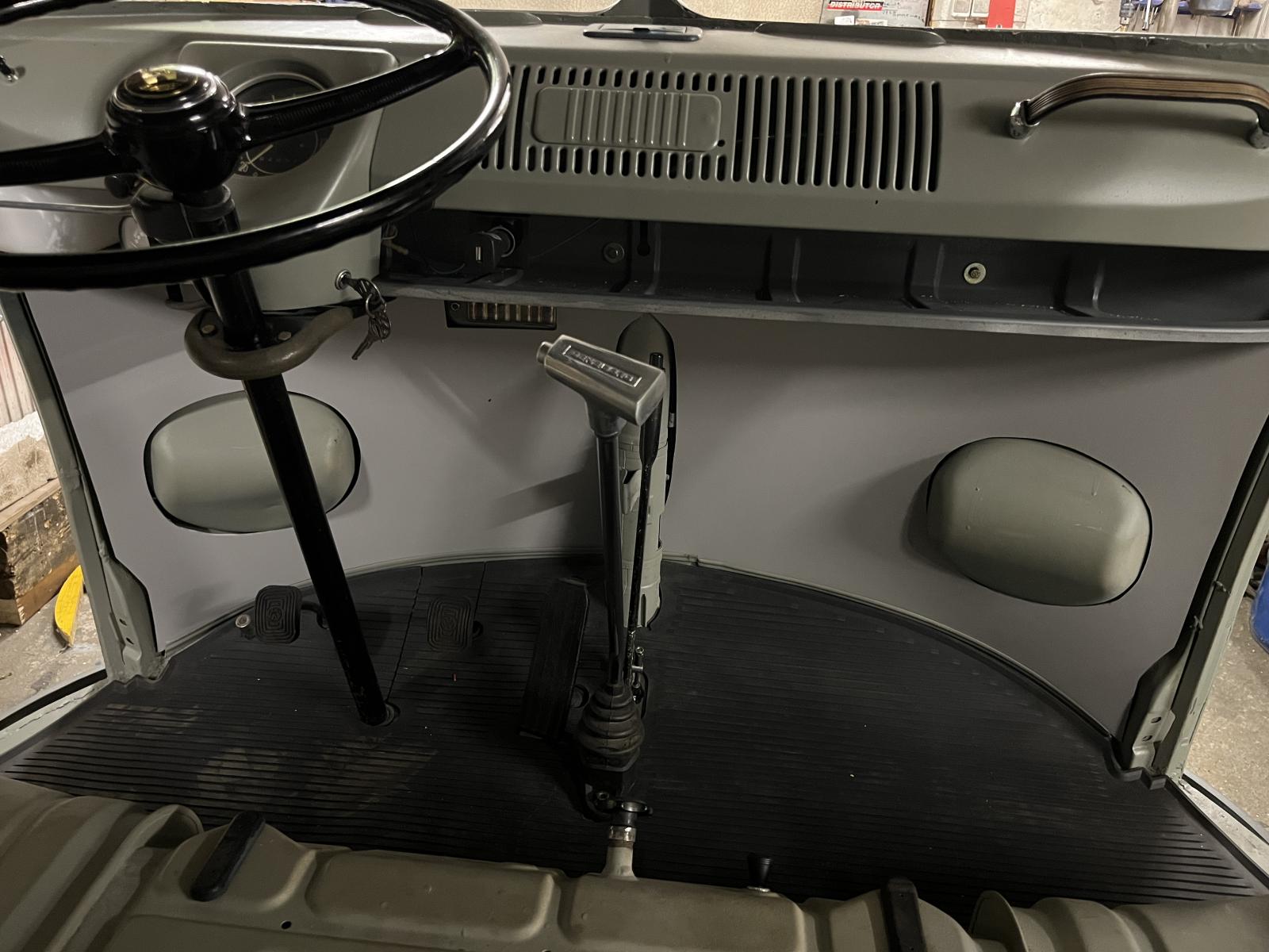

karl h
Joined: October 10, 2005
Posts: 653
Location: austria
karl h is offline
PostPosted: Mon Feb 17, 2025 12:41 pm    Post subject: Re: My 61 panel (and a 66 panel digout) Reply with quote
trial fit of the kickpanels i made of hardfoam board

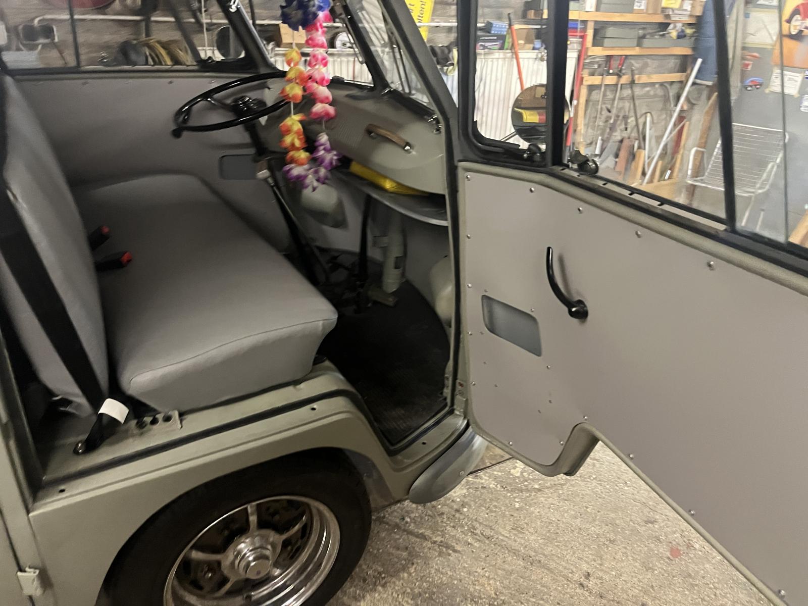

karl h
Posts: 653
Location: austria
karl h is offline
PostPosted: Thu May 29, 2025 7:30 am    Post subject: Re: My 61 panel (and a 66 panel digout) Reply with quote
all my selfmade interior panels are installed now

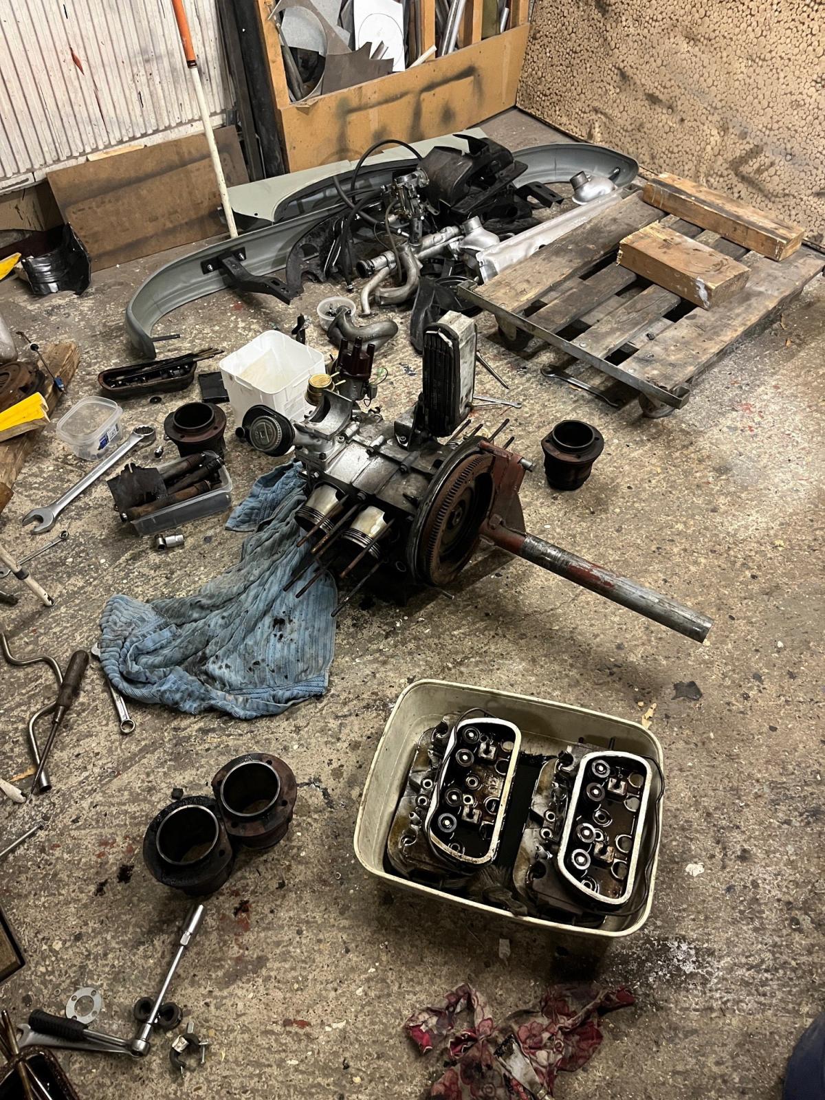

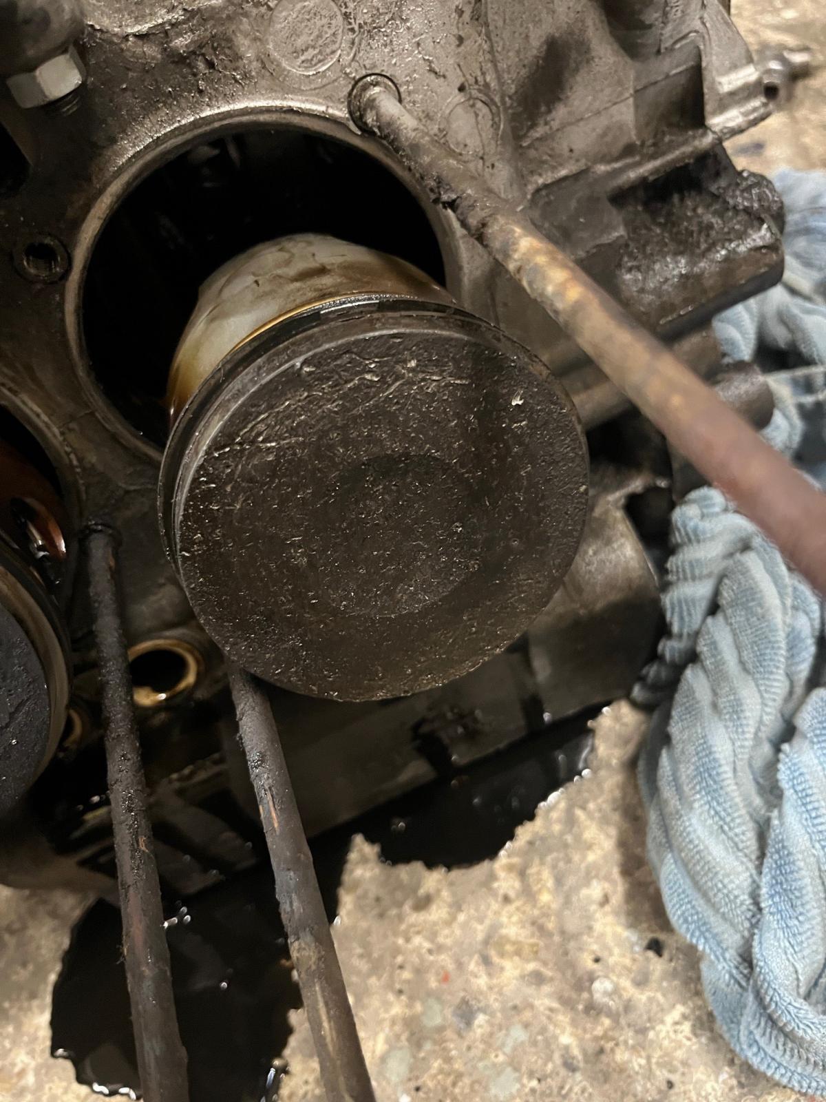

PostPosted: Tue Oct 28, 2025 12:28 am    Post subject: Re: My 61 panel (and a 66 panel digout) Reply with quote
well it didnt run very long Crying or Very sad
driving back from getting it licensed, luckily only about 25 meters from my garage, there was an awful metallic sound in the engine. like a stone getting thrown around in a metal bucket d'oh!
thought first i broke a lifter. opened the rocker covers, but everything was tight there. pulled the engine and got the first head off....
seems a nut or something similar had been in the no 4 chamber.
only metal crumbles left. at least the bottom end was fine

karl h
Posts: 653
Location: austria
karl h is offline
PostPosted: Tue Oct 28, 2025 12:29 am    Post subject: Re: My 61 panel (and a 66 panel digout) Reply with quote
piston is shot (litterally), the chamber can be smoothed, the plug has the electrode bent, so that has to be replaced

karl h
Posts: 653
Location: austria
karl h is offline
PostPosted: Tue Oct 28, 2025 12:33 am    Post subject: Re: My 61 panel (and a 66 panel digout) Reply with quote
pulled all of the guides and while at it, cleaned up the ports a little bit
waiting on some new lifters and valves. i have a set of nice stock pistons and liners that i will use
still cant imagine where the metal part came from. i drove a couple of miles before it happened Think

BarryL Premium Member
Joined: November 01, 2004
Posts: 15414
BarryL is offline
PostPosted: Tue Oct 28, 2025 6:09 pm    Post subject: Re: My 61 panel (and a 66 panel digout) Reply with quote
You would have remembered if a 10mm nut from the intake was missing and you had to grab another to finish the intake.
