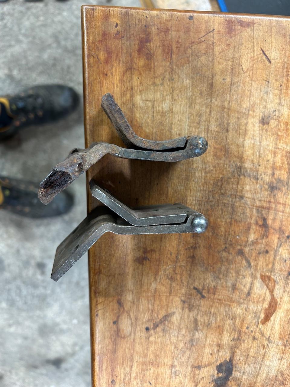

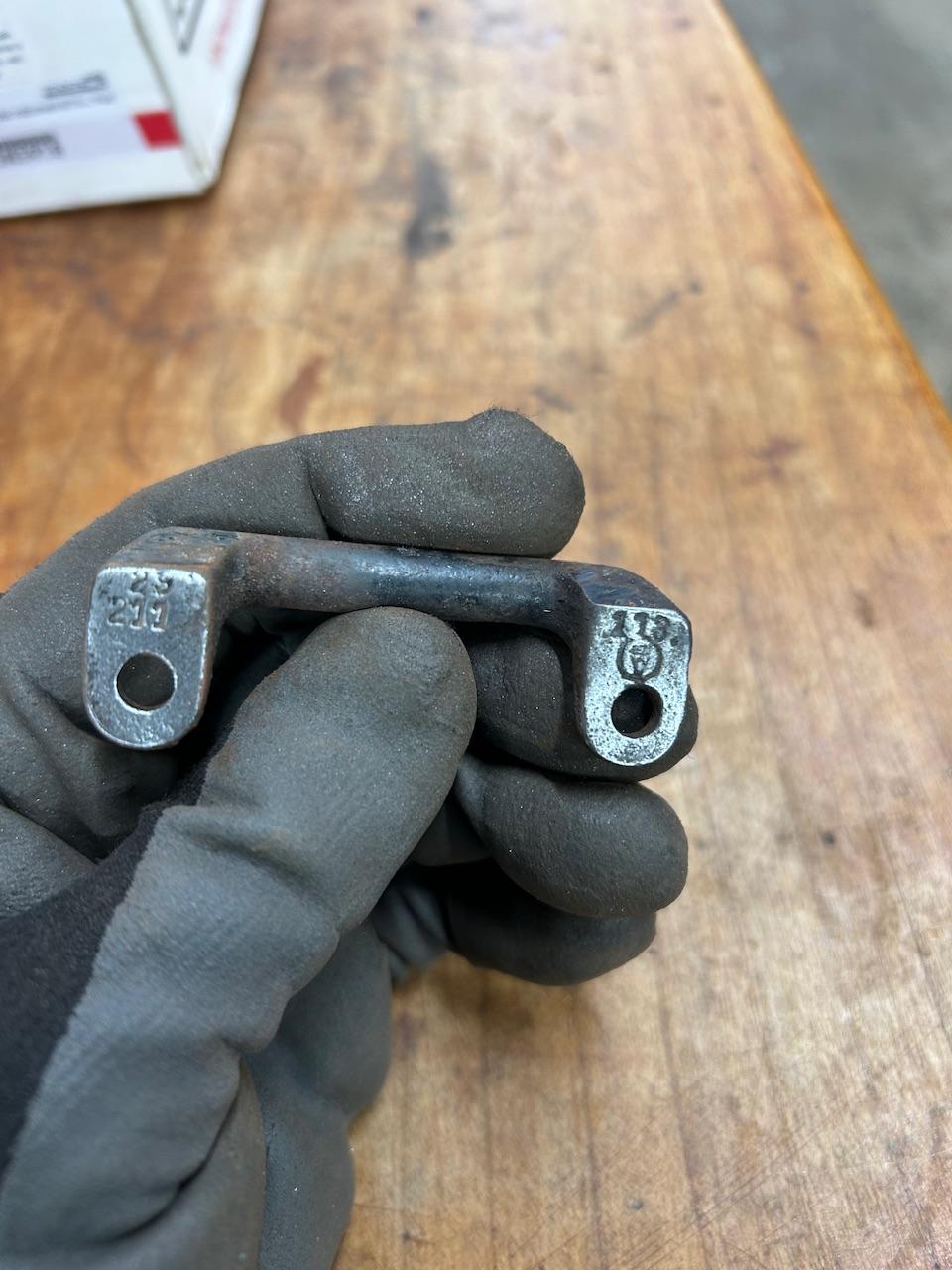

PostPosted: Mon Jul 28, 2025 2:14 pm    Post subject: Re: 52 panel repair from Austria Reply with quote

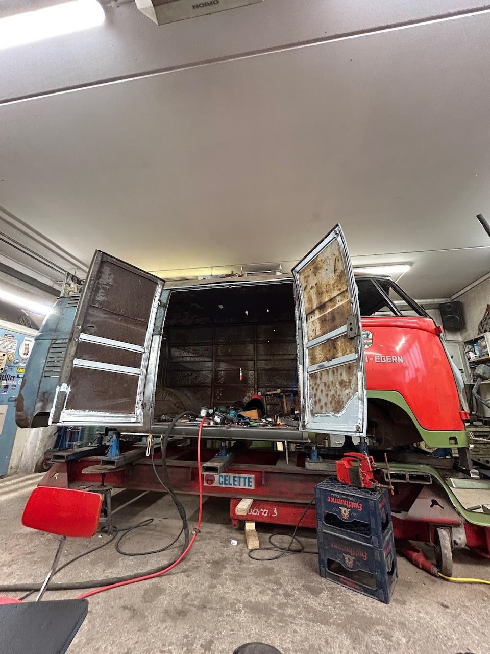

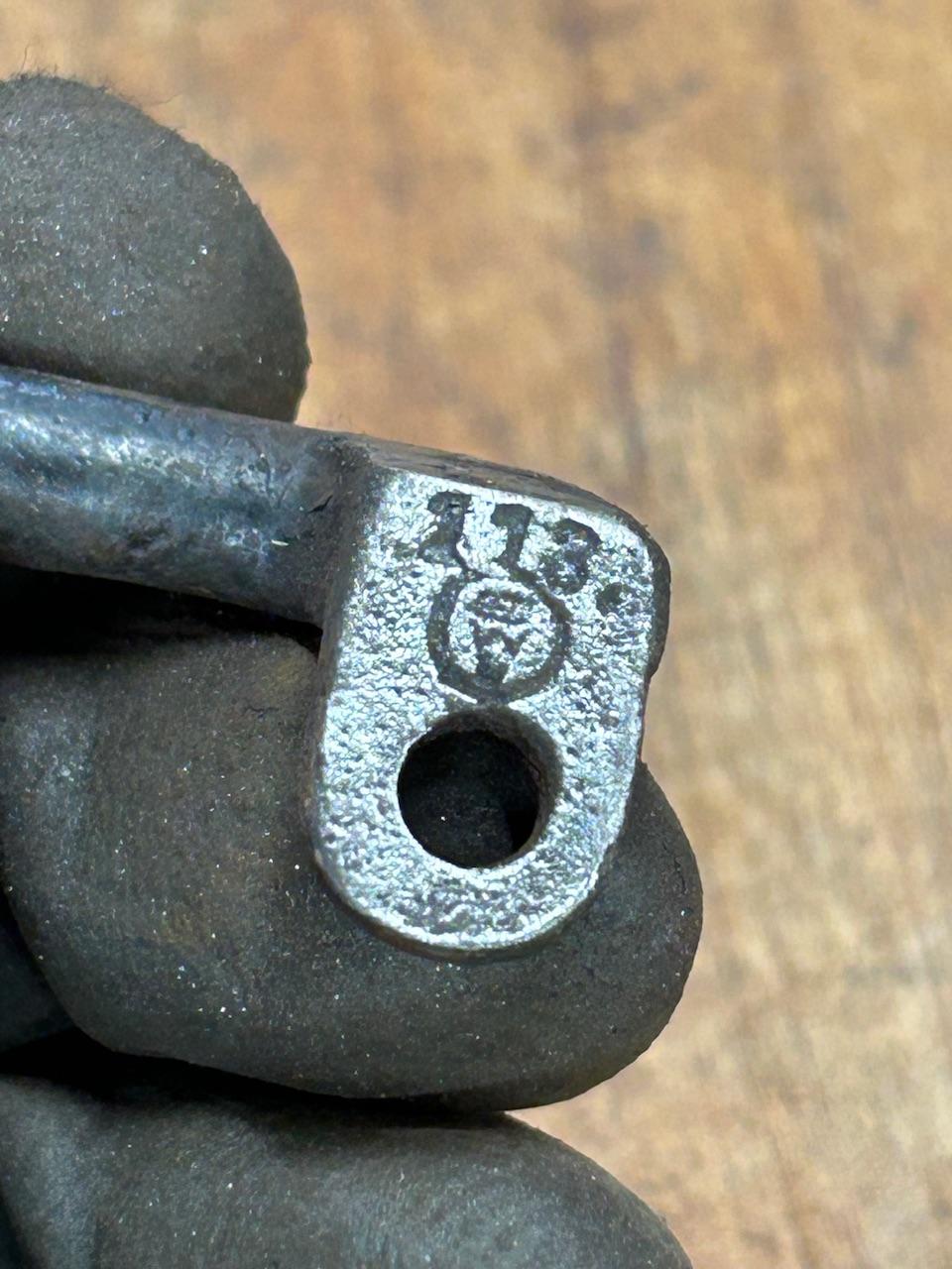

Back on that doors, I continue the work on the recreation of the inner frame.

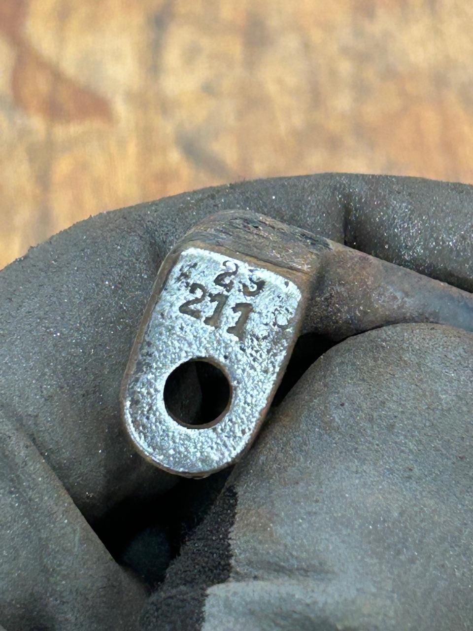

Anyone else see this one part when they changed from 29 to 211 part number? Laughing

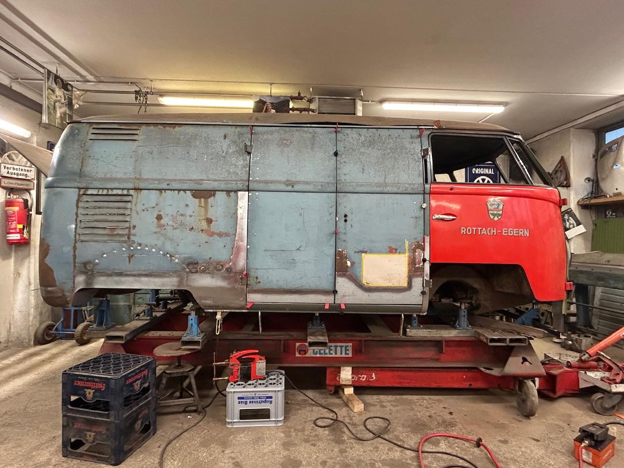

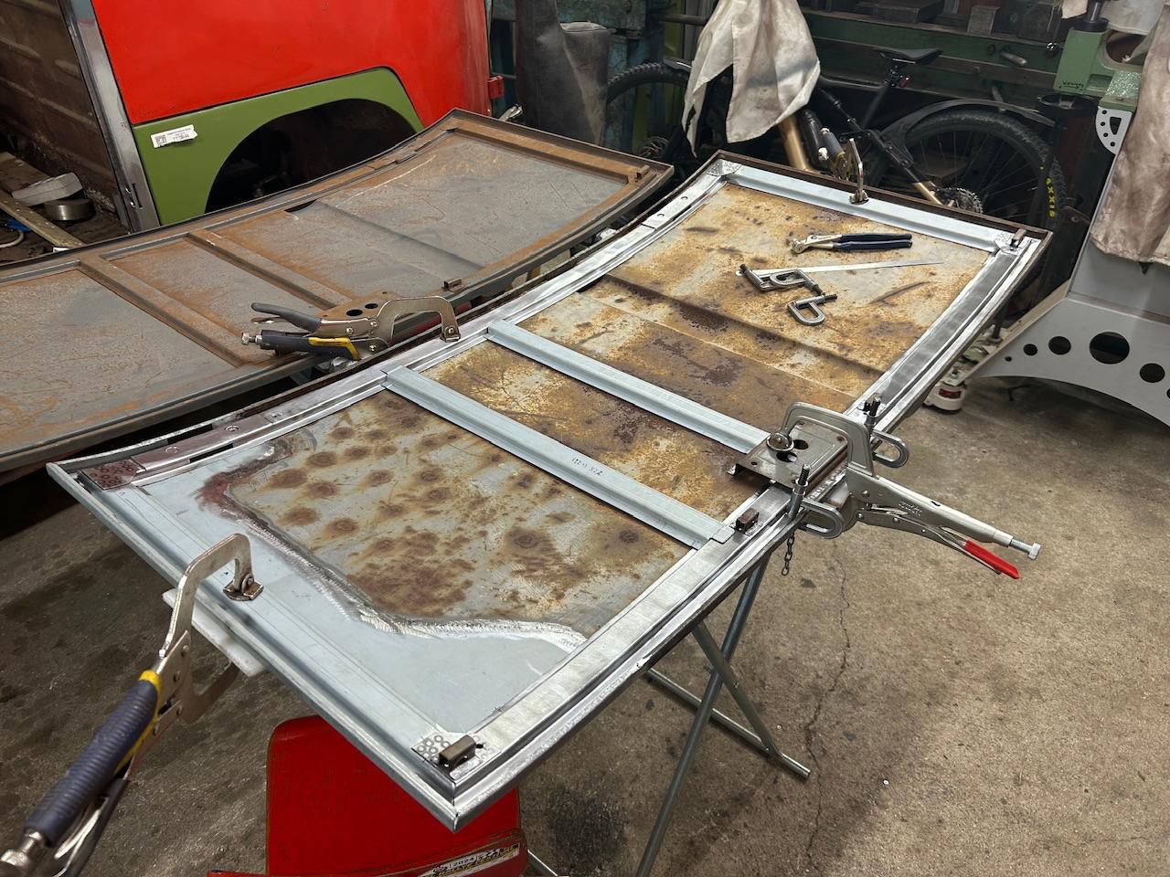

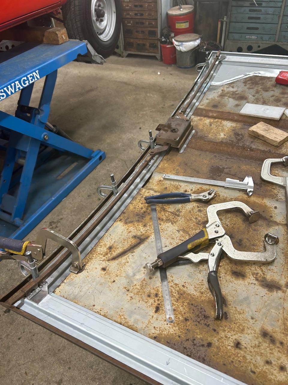

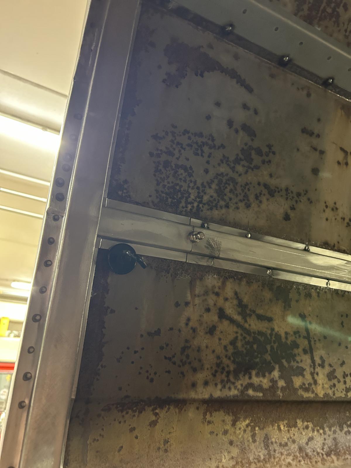

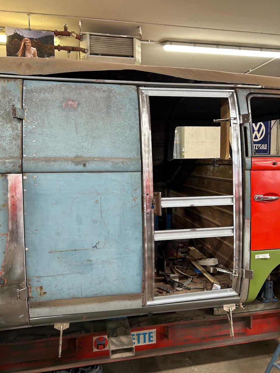

PostPosted: Tue Sep 30, 2025 4:54 am    Post subject: Re: 52 panel repair from Austria Reply with quote

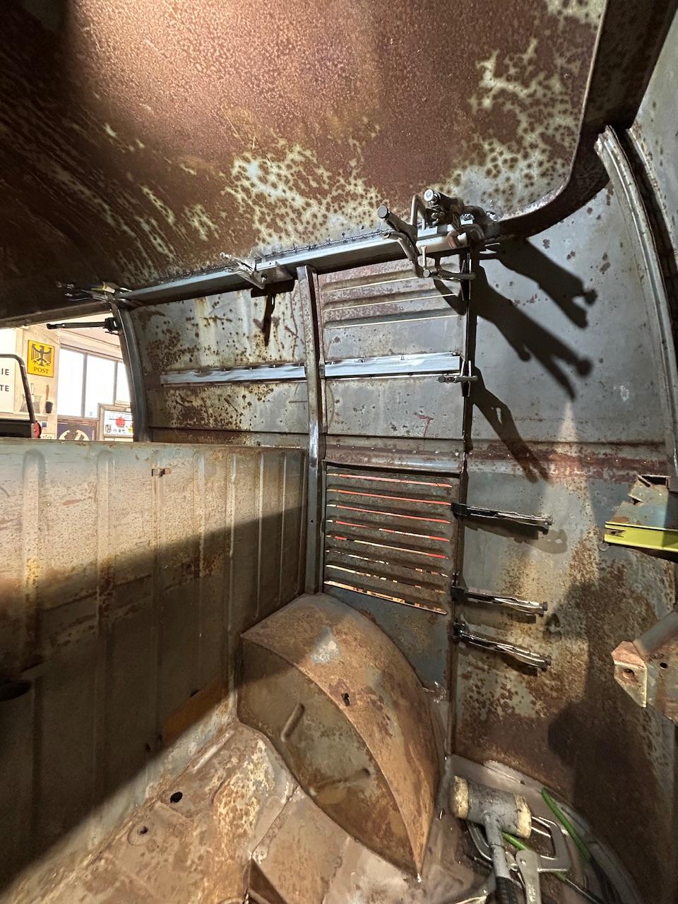

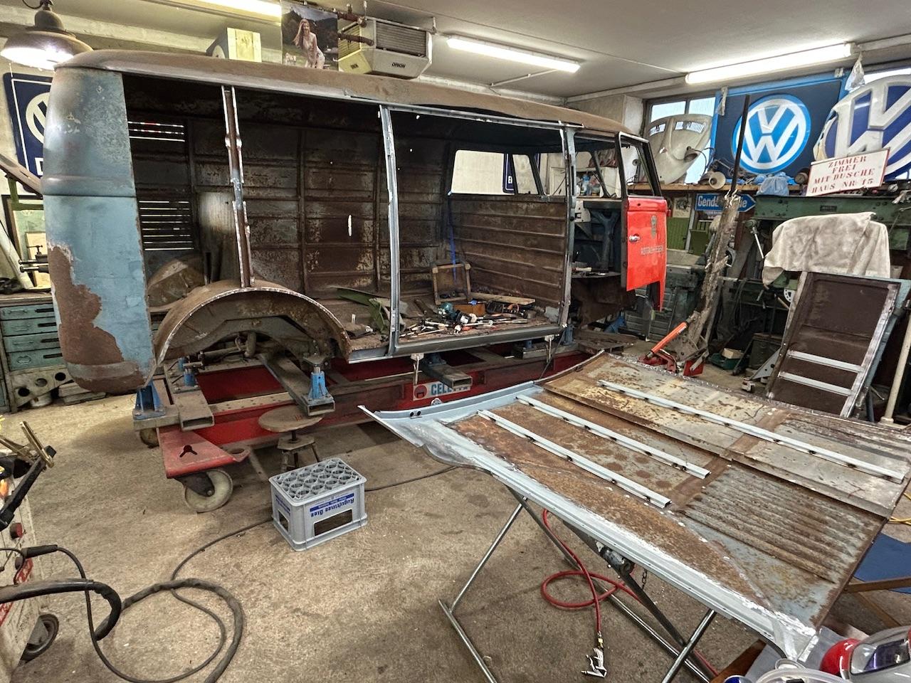

After I repaired my “new” bay window camper and did a 3-week testdeive/ road trip — 9 countries through the Balkans (Austria, Slovenia, Croatia, Montenegro, Albania, Greece, North Macedonia, Serbia and Hungary) — and drove about 4600 km, I’m now back on the Barndoor project.
I finished the work on the cargo door frames and put the doors back together.
Then I repaired the B-pillar and, with a lot of bending, twisting and pulling, I welded it back to the car.
After that, while still pulling on the roof, I welded the rear side panel back in.
A lot of detail workarounds are still necessary, but the door gaps are looking better every time.
Still a long way…
— Christian

PostPosted: Fri Oct 17, 2025 5:55 am    Post subject: Re: 52 panel repair from Austria Reply with quote
Thank you guys! Glad you like it!

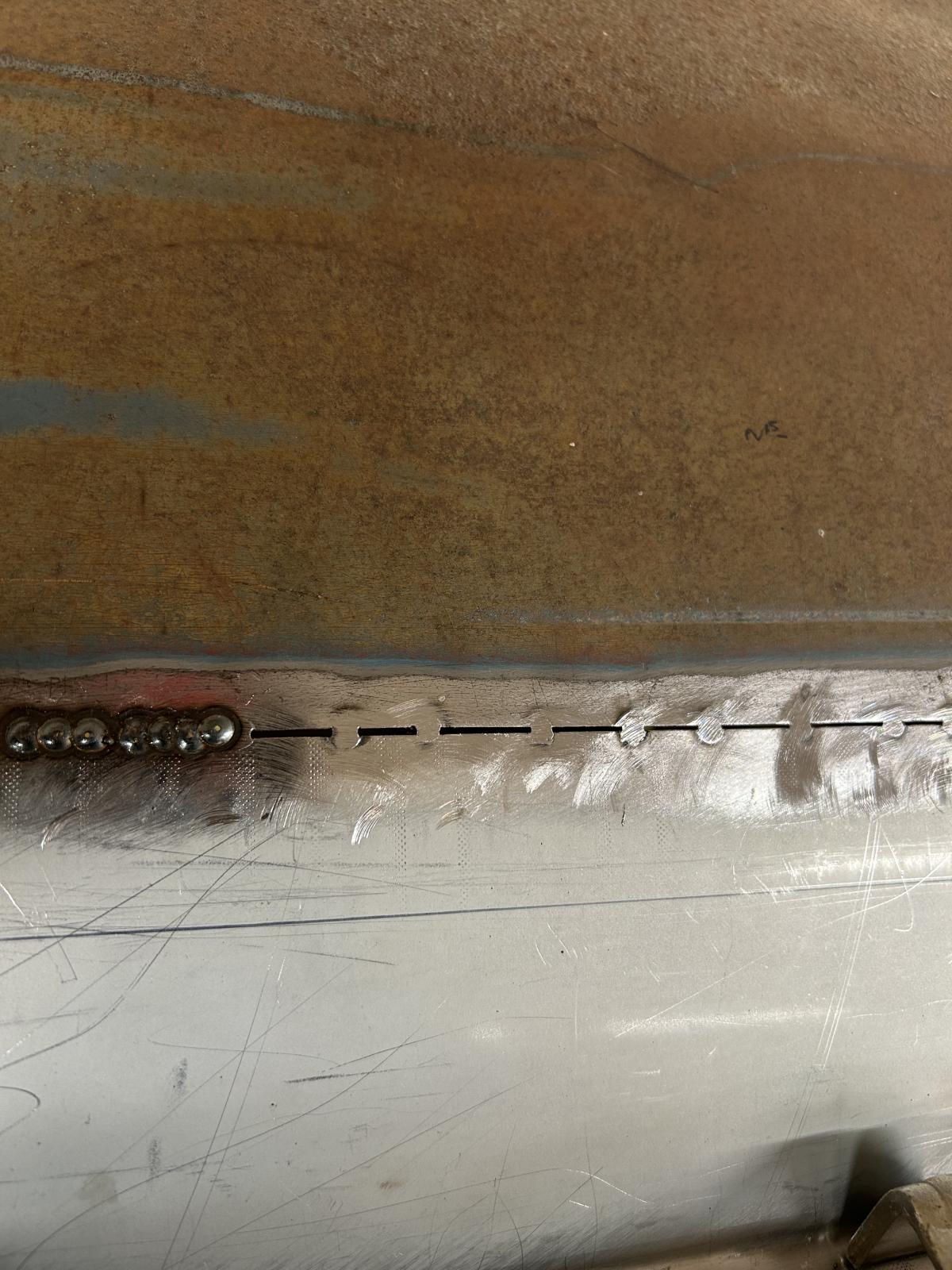

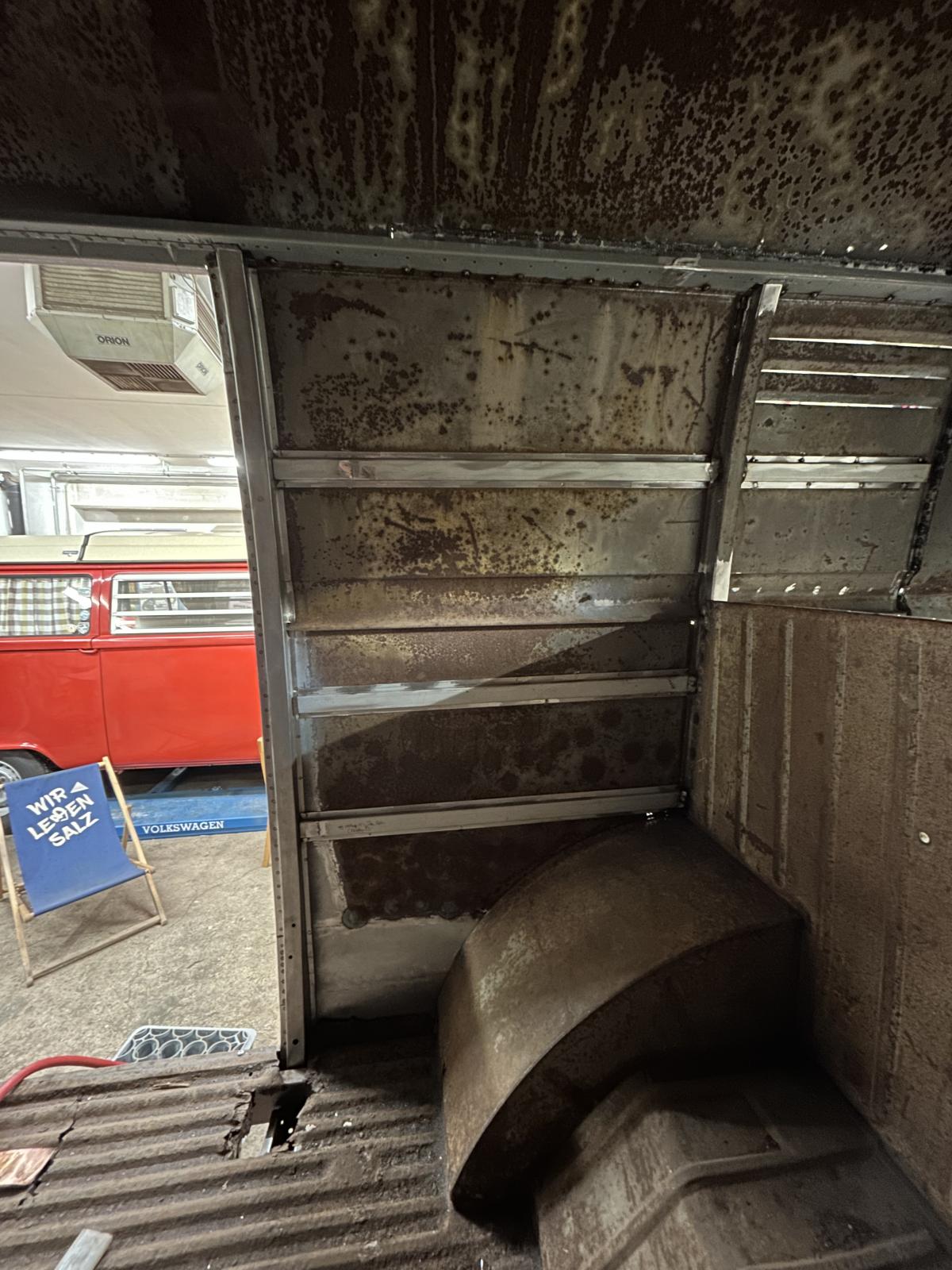

I’ve been working from back to front on the right side, on the inner parts of the sidewall and the B-pillar.
Still not finished, but it’s getting better and better.

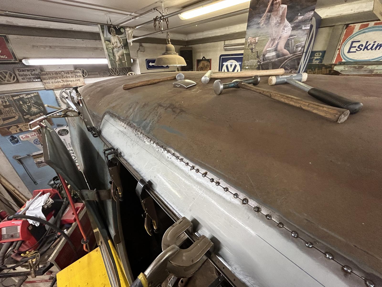

The big folds in the roof are getting smaller the more I pull on the car and work with the hammer and dolly wherever I can reach with my short hands.
So I decided to fabricate the next meter of repair panel for the roof and weld it in place.
— Christian

Huetti_1989
Joined: February 13, 2011
Posts: 1350
Location: Austria
Huetti_1989 is offline
PostPosted: Fri Oct 17, 2025 1:35 pm    Post subject: Re: 52 panel repair from Austria Reply with quote
Some hours later:

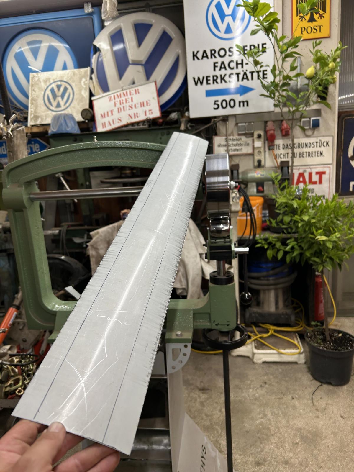

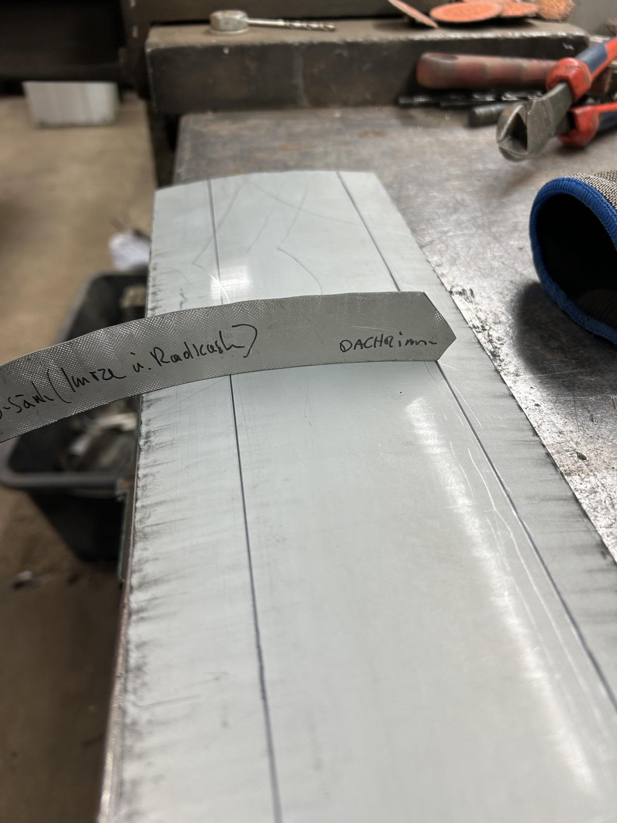

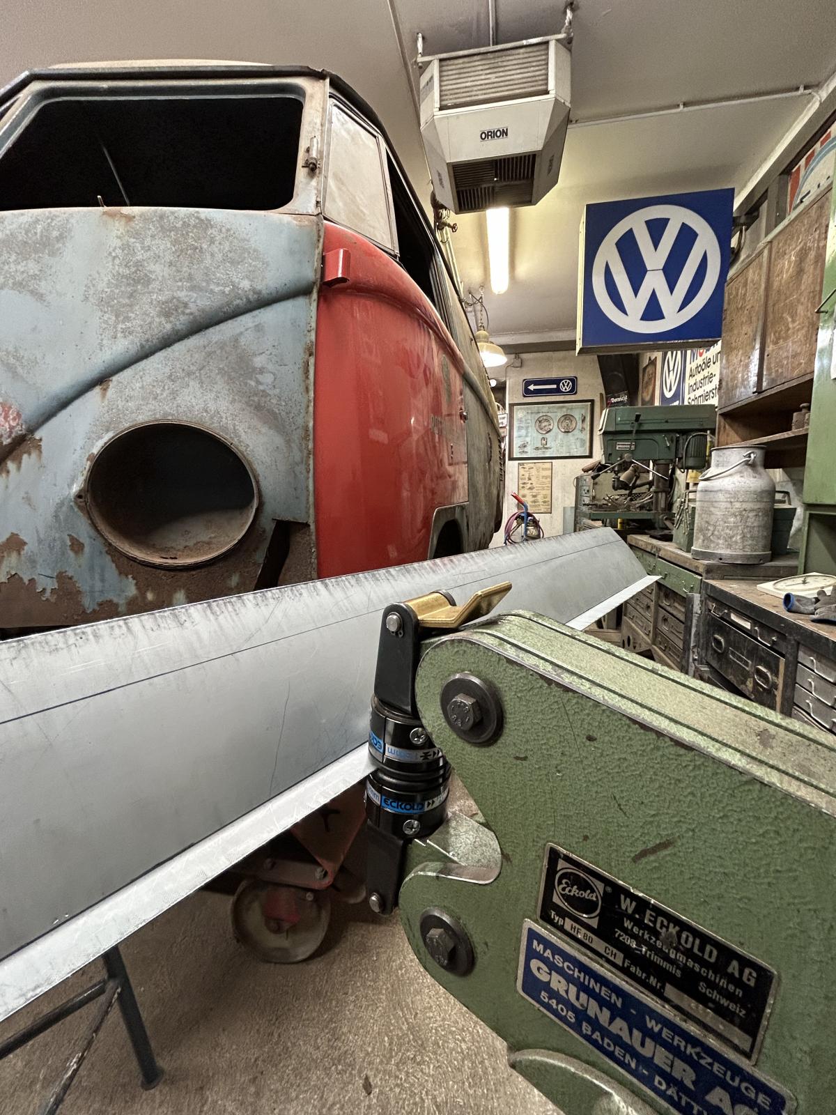

PostPosted: Mon Oct 20, 2025 12:22 pm    Post subject: Re: 52 panel repair from Austria Reply with quote
Next little step forward:
I used a piece of the left cut-out roof section from my Sparsamba build for the next part.
With a lot of wheeling, it slowly took the shape I wanted.
-Christian

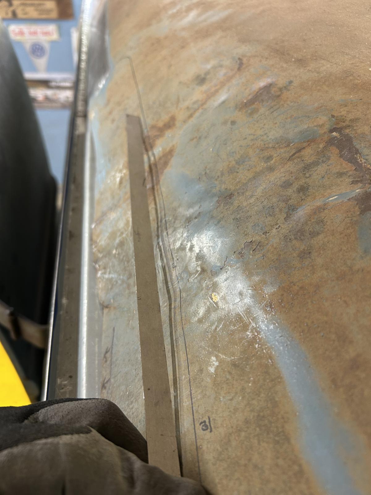

PostPosted: Fri Oct 24, 2025 1:09 pm    Post subject: Re: 52 panel repair from Austria Reply with quote
It took me a lot of time to shape that front roof section the way I wanted it — pay attention to that slight crease above the B-pillar!
Then I welded it in place.
Now the gap and the bend in the roof are closed and mostly straight again.
Once the tinnitus from hammering on that drum goes away, I might continue with some hammer and dolly work on the roof.
And of course, the other side of the roof has its problems too…
— Christian

PostPosted: Tue Oct 28, 2025 1:45 pm    Post subject: Re: 52 panel repair from Austria Reply with quote

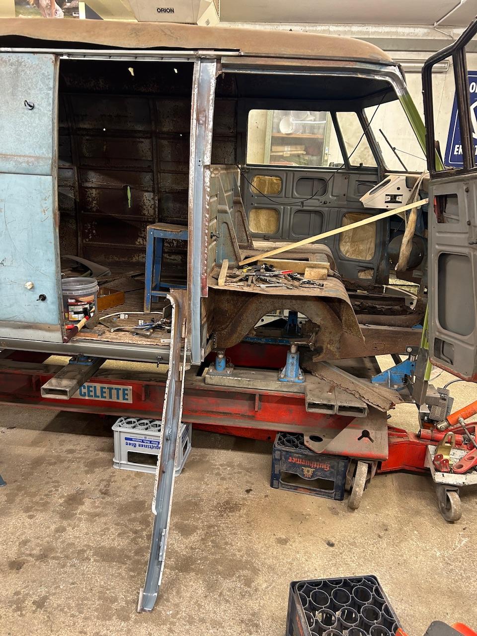

For the next step, I made the dogleg longer in some areas that I had shortened a few weeks ago.
Amazing how much the measurements changed while pulling the car on the bench.
— Christian

PostPosted: Tue Nov 04, 2025 1:26 pm    Post subject: Re: 52 panel repair from Austria Reply with quote
continued the work on the passenger side dogleg.
Using a later NOS part as a template and a lot of bending, I welded the outer part in place, then fitted the inner section.
What a time-consuming job!

PostPosted: Fri Nov 07, 2025 7:29 am    Post subject: Re: 52 panel repair from Austria Reply with quote
D-train wrote:
amazing skills!
The tools doing all the work, not me Laughing
Passenger dogleg is finished now!

PostPosted: Sat Nov 08, 2025 3:32 pm    Post subject: Re: 52 panel repair from Austria Reply with quote
Finished the patches on the lower front wheel arch and fitted them together with the NOS floor part to get a good fitment.
Unfortunately, the wheel arch with the X-section is far beyond saveable...
I think I’ll need a KlassicFab panel here…
— Christian

PostPosted: Sun Nov 09, 2025 2:50 pm    Post subject: Re: 52 panel repair from Austria Reply with quote
Today I tried to make my own repair panel for the wheel well instead of ordering a new one.
Spent the whole day fighting with it, and it’s still far from finished
but I hope I can get it close enough to weld it into the bus.
Hopefully…
- Christian

sgellis
Joined: July 06, 2016
Posts: 2217
Location: SW Nova Scotia, Canada
sgellis is offline
PostPosted: Sun Nov 09, 2025 3:39 pm    Post subject: Re: 52 panel repair from Austria Reply with quote
I as going to say you could just make one. Haha
Did you press the X? I 3D printed a die for mine.

Huetti_1989
Posts: 1350
Location: Austria
PostPosted: Thu Nov 13, 2025 2:46 pm    Post subject: Re: 52 panel repair from Austria Reply with quote
Yes, you were right!
I used the X-section from an old part. I was thinking about your die, and I want to order a printer, so maybe for the next piece I’ll try it with your help, please!
After many hours of cutting it apart and welding it back together to make the new sills fit to the old panel, it’s getting closer and closer.
-Christian

sgellis
Posts: 2217
sgellis is offline
PostPosted: Fri Nov 14, 2025 7:10 am    Post subject: Re: 52 panel repair from Austria Reply with quote
Sure.
Quick suggestion on printers. An enclosed printer form Bambu Lab will work out of the box without needing to learn a new skill. We have a X1E at work and it does a great job at production parts. A P2S would probably do everything you want at 1/5 the cost. I have a cheep ender3 at home and as with most cheep printers it can be quite frustrating at times.
If you don't have a CAD preference try Autodesk Fusion. It has a free Fusion for personal use license. It is extremely capable but you can ignore that and work just with simple part modeling.
Feel free to contact me directly.
