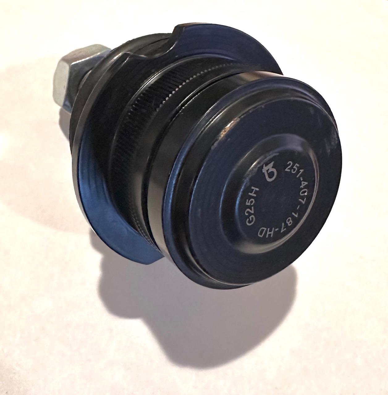

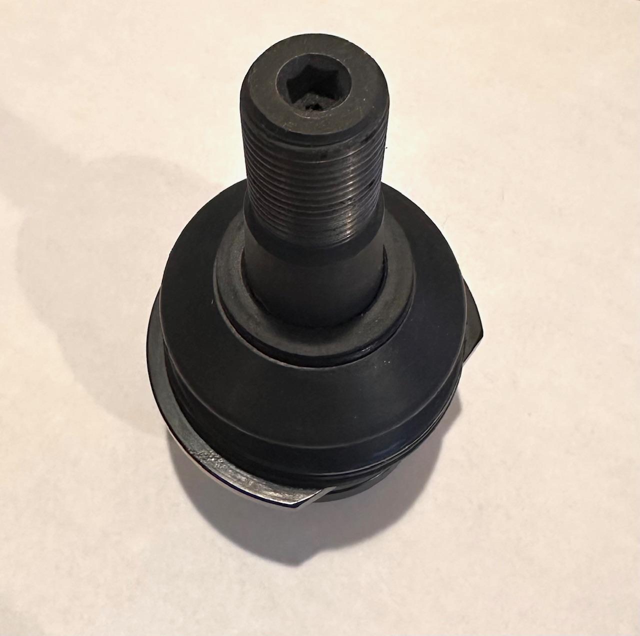

Thanks for the inquiry, Larry. The new run of upper ball joints (both standard and tall) is expected to be available in 3-4 weeks.
Below are two threads that track the timeline, development, and introduction of the T3 ball joints.
https://www.thesamba.com/vw/forum/viewtopic.php?t=...;start=100
https://www.thesamba.com/vw/forum/viewtopic.php?t=759321&highlight=t3
But, for the backstory on the long delay of the upper ball joints, we have to go back to the beginning of the inception of the T3 ball joints. Over the years, I had seen the quality of ball joints getting worse and worse with nearly every stocking order I placed. Back in 2020, I decided that I had had enough of the garbage ball joints that were available for the Vanagon and decided to do something about it. But where to start?
There were a few false starts, but a chance meeting with the right people at the right time led to a relationship with a major suspension component manufacturer. Being the charismatic (I guess) person I am, they agreed to take on my project and produce high quality ball joints for me. This worked out great. They were awesome people to work with.
However, this manufacturing company ended up getting sold, and all but one member of the team that I was working with got let go. We will call him Tony. The timeline here is right after my first run of ball joints was delivered. At the time, I wasn't sure if I would even be able to have them produce a second run of joints, but luckily, Tony went to bat for me and convinced them to continue on with my joint program. As long as Tony was around, things went reasonably well. But, eventually, Tony got fed up with the way the new owners were doing things, so he left.
Once Tony left, things with this new company were rocky...really, really rocky. The quality of the joints has always remained very, very high, so that wasn't a problem. The problem was the lack of communication and the lack of the ability to make improvements/changes to the joints over time to make them the best they can be. It simply came down to: placing a purchase order, trusting they received it (because it could take months for someone to respond), then waiting...and waiting...and waiting, just to wonder when exactly the massive amount of money was going to be withdrawn from my bank account. Again, little to no communication. Just... one day there's money in my account, the next day there isn't. And weeks/months later, a truck shows up unannounced with pallets of joints. Fun!
To be clear, the quality of the joints never suffered, thank goodness. It was just all of the internal operations, communication, and administrative things that suffered greatly under the new ownership.
Then, one day, about a year and a half ago, I placed a purchase order for a new run of joints. I received an automated notification that the products I ordered were no longer available. Wait, what? These are MY products...exclusive to ME. What in the world was going on? After several inquiries, it finally came out that they had sold off a portion of their business, and along with that were my ball joints. But where did they go? Who now has the designs, the history of my joints? So...now what?
Through a massive amount of time, effort, and, of course, money, I was able to find a new manufacturer to produce my ball joints. This meant creating all new relationships, all new discussions about the requirements for the ball joints, all new drawings, all new samples to test fit, etc. There was lot's of miscommunication about the requirements necessary for the new joints. Building a new relationship with a suspension component manufacturer is difficult. It has been a very arduous road to say the least.
But I am very happy to say that we persevered, and we now have joints that are better than ever. Actually, that's a bit hard to believe, even for me. The previous generation of ball joints have been excellent. Other than some installation difficulties, we haven't had a single lower ball joint failure, that I am aware of. And other than just a couple of boots that split early on in the production, we haven't any upper ball joint failures either. That said, I still saw a few places where things could improve.
All of the new joints all have boots that were slightly redesigned and made from a more durable material. Internally, the upper ball joints are of a similar construction to the original, but with improved materials to increase the lifespan. I'm not sure that going to efforts to increase the lifespan of the upper ball joints was necessary, but I figured that, since we were in a full redesign anyway, why not make as many improvements as possible.
The real news is with the lower ball joints. In addition to the aforementioned boot redesign and material improvement, we have the following changes/improvements:
    1) Chromoly, one-piece bodies for increased strength and durability. The original joints had a two-piece body that was made up of the main body with a solid cap that was crimped onto the end. The new version has a body that is all one piece, no more crimped cap. As a result of the one-piece body, testing shows the the maximum push-out force before failure is over 26462 lbf (12003 kgf). That will do nicely.
    2) The new version of the lower ball joints, as well as the new upper ball joints, have improved corrosion protection for all components.
    3) For the new lower ball joints, I have reduced the diameter of the knurled section just slightly to make them a little easier to install. While the previous joints had dimension that were 100% the same as the stock OE VW joints, people were having a hard time getting them installed without damaging the flange. The revised knurl dimension, as well as the stronger chromoly body material, should eliminate that issue.
    4) I changed the end of the shank on the lower ball joints from an extended "spade" to an internal socket arrangement. This prevents the tip of the shank from hitting the steering knuckle on a 2wd when the suspension is at full droop (for lifted 2wds) and gets rid of that "spade" hanging down on a Syncro application.
So, that's the latest update on the T3 ball joints. As I mentioned, both version of the new upper ball joints will be here in 3-4 weeks, and the new lower ball joints will be here a week or two after that.
