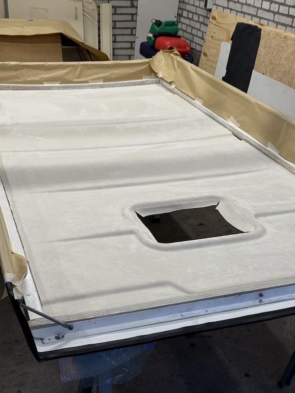

Upholstering the headliner of the poptop unfortunately didn’t go as planned. The stretch headliner fabric didn’t stretch evenly around the roof vent opening, leaving too much material on one side.
I glued the fabric in four sections (about 1.9ft each) applying spray glue to both the foam and the roof, waited the recommended time, and then pressed it down with a roller. First three sections went perfectly but it went wrong on the last section where the skylight opening is. I had pre-cut the hole for the vent before gluing, which might have caused the problem.
Any idea what went wrong here or tips on how to fix or redo it properly?

My experience is that the liner is laid on the surface and then pressed onto the surface from the middle out. No stretching except where there are bumps.
It looks to me like it was stretched where it didn’t need to be. I’d pull that whole section off and start over.

Good luck with that. In my limited experience gluing a new headliner into a vehicle- once it’s adhered there’s no “pulling” without ripping the headliner and making a worse mess of things.
As long as the op isn’t a perfectionist, I would suggest using a very sharp razor blade to slice the creases/bubbles and try to reset them into place to eliminate the creases that he has now. It’s an iteritive process so make small adjustments till it looks good to you.

Gaining experience can be a bitch at times. Likely contact cement was used, that doesn’t really give you a second chance. I do recall one contact cement that gave you some working time but don’t recall the brand.
I like the idea of surgery to carefully remove the excess and butt the new edges. I’m lucky I can’t see the detail any longer with my eyes alone. Give it the 10 day rule. If after 10 days it still bothers you, rip it off, remove the glue, prep and redo. Otherwise plenty of other stuff to obsess over.

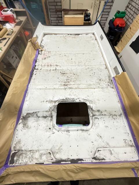

If the material does not react to lacquer thinner, you can wet the headliner where you need to lift it and it will soften the contact adhesive allowing it to be pulled up. I believe lacquer thinner will not stain your material and will evaporate completely. Do this outside with lots of ventilation. Ya I would probably have waited on cutting the hole. Good luck

I think my next step will be to completely remove the old headliner and clean off any remaining foam and glue. I’m planning to use acetone for that.
After that, I’ll redo the headliner installation from scratch. Are there any particular tricks or methods that professional upholsterers or headliner installers use to get the best results? Things like how to apply the material smoothly, or ways to avoid wrinkles and uneven stretch?

But when I do things like this I start from the middle centerline and work my way to the sides.
Do not stretch the material at all on the flats. It will naturally stretch to form over the bumps and ridges. If you stretch it you can end up with uneven amounts again.
When I did the NAHT I started by putting cement on one side of the top and the material. Then gently laid it on to top then went over it with my hand and then a roller. No stretch on flat surfaces.
Then I exposed the other side and did the same routine.
Final result.

As an upholsterer I find foam backed headliner easy to work with because it's so stretchy. Yes, pre cutting the hole is what got you into trouble. Lacquer thinner has no place in doing headliners or laminate work because it leaves a residue, yes it does. I'd worry about using it on fiberglass and soaking into it causing the headliner to release. In my early years of upholstery work I made the mistake of doing a final prep wipe down of a car roof interior with lacquer thinner. I knew better but was in a hurry and wanted to avoid a trip to town for denatured alchohol which is what you should always use prior to contact cement projects. I was using a high quality pressure pot spray glue. The install went fine. A month later the headliner was failing. This was foam backed headliner like you are using. In your pics the drivers front corner could've been pulled diagonally out and likely remove all the excess but your cutout wouldn't have been within the hole. Acetone for cleaning old glue won't leave a residue.

this is a thing.
it's made specifically for dissolving contact adhesives.
it's tinted red so it may stain lighter colored fabrics, but i have used it to remove contact adhesive from my clothing and it did not discolor or stain the fabric.
it also does not harm paint or your fiberglass pop-top as lacquer thinner or acetone might.
if the red worries you, SEM makes the same stuff, but it's clear.
since you cut the hole in the wrong place, unfortunately you're going to have to start over.
cut the hole last thing.

After some searching, I’ve learned a bit more. Removing the old foam residues from the old headliner can partly be done using a stiff brush attached to a cordless drill. Any remaining glue residue can be removed with thinner/acetone or by sanding I guess.

This upholsterer basically lays the fabric onto the surface first and then presses the shapes into the cloth.

Started today by pulling off the old headliner. Then I removed the glue residue with acetone. Tomorrow I’ll take it outside and continue working on it.
After that, I’ll choose a nice new headliner to install.

So today I finished cleaning the rest of the pop-top and removed all the final glue residue. I used white spirit and a scraper which worked out pretty well.

You almost had it on the last try. Being told to lay it in there and just start gluing it down is bad advice IMHO. That's not what I was taught in upholstery school 35 years ago. Not alot of foam backed headliners back then but the concept is the same. If it worked for people here im glad. I won't go into how you apply glue and whatnot. Basic premise is affix it in the centers of the front, back and sides while stretching it a bit. How much? Front to back maybe 6 inches, side to side maybe 2 to 3 inches. It will be suspended over the roof. Start in the center sticking it down along the middle Front to back. Work your way outward and toward the sides doing quarters at a time while pulling the corners outward diagonally. Not stretching it is what will cause trouble.

So today i started the job again, this time i worked in 3 parts. Took me around 3 hours (including preparation etc.). Pretty happy with the result. I like the 'alcantra' look. The foam is about 4 mm thick so cutting the sides was a tricky job. There’s a bit of space left on the side but i think the gap will be sealed by the canvas + tacking strip.
