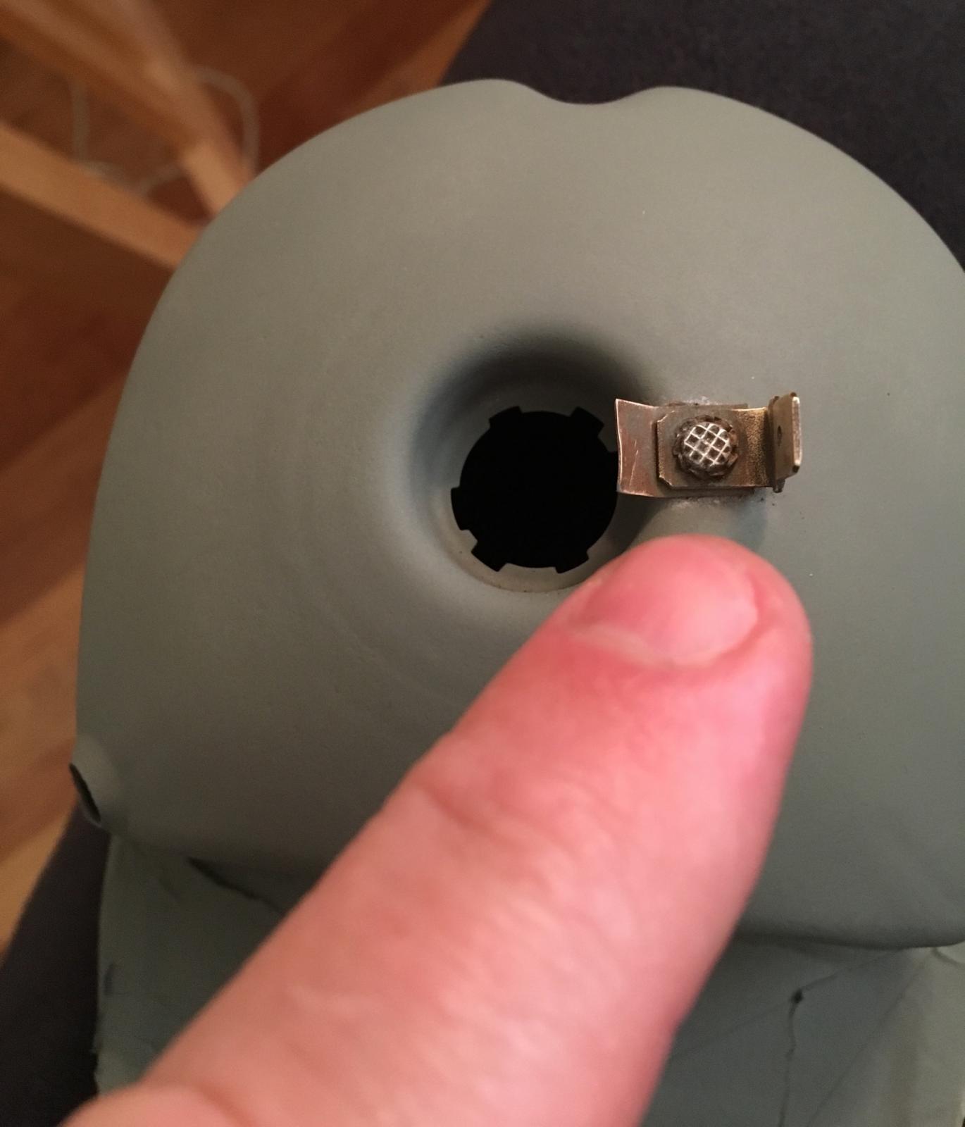

PostPosted: Mon Nov 17, 2025 11:55 am    Post subject: Re: Taillight Issue Reply with quote
BonTonRoulet wrote:
we'll continue our main across and down to the other tailight assembly for our final small ring terminal we'll zip into the back of the tailight with a #2 sheet metal screw to finish the job.
The only thing we will disagree with this is that the sheet metal tube that is flanged into the taillight reflector is another place that corrosion will get into which causes another voltage drop. VW finally dealt with this with the 1970 & 71 bus taillights when they first installed ground wires for the taillights from the factory. They not only added a ground electrical terminal, and another piece of brass to be spring loaded against that tube that the bulb resides in. Which between the two pieces of brass is another place to cause a corroded connection. The below image shows these connections, but is missing the bulb tube.
Personally for the 1970-71 taillights just solder a short wire soldered from the brass clip to the tube the bulb is in will do the trick to removing these last few ground connections there. You will need a very hot bigger soldering iron for this.
For the 1962-1970 taillights have soldered brass slip on terminal to each reflector and solder the short wire from brass tab to the bulb tube. Brass while it does corrode, does not do this as badly or quickly as the steel of the bulb reflector.
If you have a burnt out sealed beam headlight bulb, de-solder the brass tabs of of it. Those tabs are a bit wider than the regular size of connectors in the VWs, but a few minutes of filing can make those fit the narrower connector.
Yes, for the Euro 1962-71 and the standard 1958-62 small round taillights that are cast pot metal, will drill, install two nuts with a bolt (brass or SS fasteners), and the brass terminal tab. Have yet to try a pot metal solder for this setup yet, those are out there, but rather nasty chemistry.
Prefer the brass tabs instead of the ring terminals due to when pulling a taillight it is a quick slip off, and when cleaning that ground someday it again is an easy slip off to do that.
