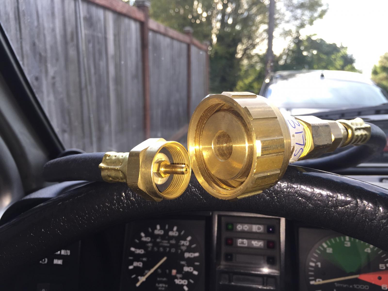

I had a similar adapter made to transfer 1 lb bottles to the Westy propane tank in case I ran out. In 10 years I’ve primarily used it to test the concept but I’m ready if need be. Laughing

I went with this setup years ago, allows carrying a mini tank for backup when winter camping and using Propex heater:
I don't try to refill the stock tank, just use as a passthrough to the onboard system. We keep the hose and adaptor in the camper all the time but only pack along the mini tank if planning extended trip.
So the donor tank is con8nected to the fill of the stock tank.. And this just creates extra capacity? What's a mini tank?

Looks like a 5lb tank.
