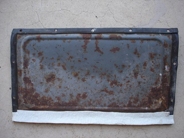

I went to Napa but didn't like the Butyl stuff. First it comes in 2 thin strips where the original stuff is one wide strip. And it seemed sort of nasty. Price at NAPA was $11. They have it at Kragen/Checker/Schuck's too in a boxed roll.
The old school guy at Checker's took one look at the original stuff and directed me to local RV/Boat place for "strip caulk". It seems like a better match and is $4/roll. I went with that.
Installed on cover:
Plate installed:
It squeezed out a little when I installed the plate but the excess rolls right off with your finger.
I used new screws and re-tapped out all the screw holes.
Installed on cover:
Plate installed:
Butyl is nasty stuff!. AND, it is always nasty to work with, old or new. Kind of like roofing tar (really!). Sounds like you found the "right stuff", or close to it. Cool .

Installed on cover:
That's pretty hardcore patina. Shouldn't you have removed the rust before you installed the plate? Wink

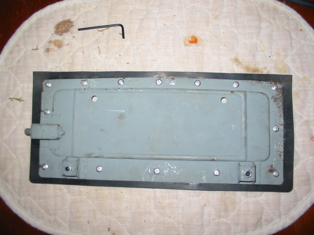

The OG cover seals are a little different than friction tape, but it will work. I media blasted the whole inside area, above the visors, and disassembled the flap, installed new seals, etc. I was tired of the chinese water torture! Surprised
While you're resealing, be sure to seal the whole air vent box and any areas the factory might have missed. The water rusted out a section Above my windsheild on the driver's side. It looks like condensation gathers above the visors and rusts the pillars/windsheild frame from the inside out. Made a nice little drain hole through the roof, and runs around the windsheild seal.Mad
I also replace the set screws and locknuts. I used Allen head set screws so they don't strip out as easily in the future.
More pics in the gallery.

Braukuche wrote:
Installed on cover:
Maybe... it's lighter than it appears though. Most of it came off with some steel wool.
