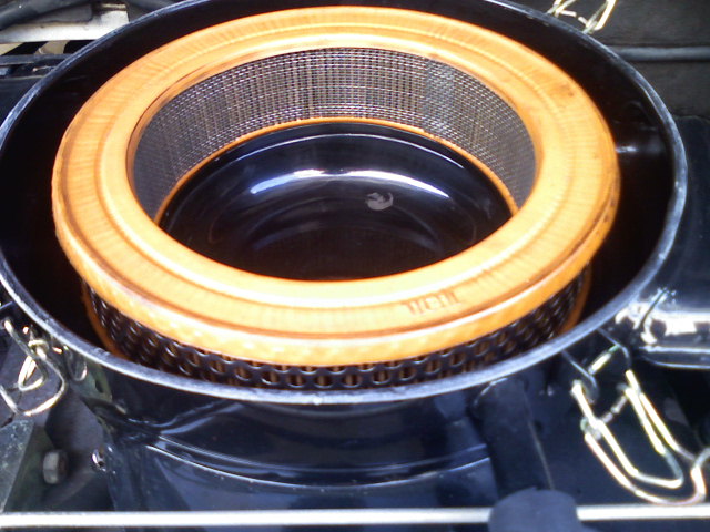

Hey all! Long time lurker first time poster with a question for the type 3 gurus! Is this air cleaner correct for a 65? Where would I find an air filter for it? Yeah I know the fuel pump is off a type 1 but the original one hardened up and I needed something quick to keep driving! I have 3 type 3 pumps and they all need to be rebuilt...
Any help would be very nice!

That's a brazilian type air filter - normally you would have an oil bath type
BTW that's a later engine:
- dual port manifolds - late style breather - late style dynamopulley cover - late oil cooler etc.

Before I retired from Mahle Filters, I tried to run down a source for those air cleaner elements. I had no luck. They are no longer in production.
Your best bet, is to take it to your local parts store, and see if they can come close. I think at one time, someone said that a Pinto one worked.

Yeah the PO said this is the third engine in the car, he gave me the other one he had for it a 1776 with 40 dcnf's. The one in it is a 1641 with solex's.
Maybe pepboys didn't have a filter for the right pinto when I was there becuase I spent three hours taking every filter out of the box and comparing! I'm gonna take the size of this one and see if I can find a K&N that will fit.

The VW part number on the element is
041.129.619.1

If you can get them in the US, Rover Mini (old model, not the current BMW one) filter elements fit pretty good.

Putting this on all the topics about the Brazilian air filter housing for future reference.
The K&N filter for the Rover Mini (i think) is E-2601. Bought one, and it fits! It's a little smaller in diameter than what I assume is the original Brazilian stock air filter. However, it will definitely work.
