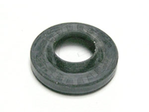

PostPosted: Wed Jul 22, 2015 3:55 pm    Post subject: Throttle body shaft seals Reply with quote
Here you go, perfect fit!
Dave

PostPosted: Wed Jul 22, 2015 4:05 pm    Post subject: Reply with quote
Source?
djkeev
Joined: September 30, 2007
Posts: 32988
djkeev is offline
PostPosted: Wed Jul 22, 2015 4:50 pm    Post subject: Reply with quote
Harwal (That's why I included the package in the photo, company ID and item description)
This office was in Vermont but they have others. You do need to purchase from a distributor.
In my case it was Motion Industries in Teterboro NJ.
Harwal will tell you who is nearby if you call them.
The OG VW/Audi product is single lipped too.
Fact is......
These are better, a single lip with a shaft tensioning spring.
