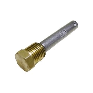

My guess is that small amounts of stainless steel does not present the same galvanic problem as the long great area SS coolant pipes. And keeping the pipes insulated from the body may help as well as electrical conductivity is one of the three requirements for galvanic corrosion.
A zinc bolt bung sounds like a great idea. Maybe get a couple people to test them out. Or perhaps a zinc anode in the coolant pressure tank would work.
Or how about this: Flex-a-lite 32060 Zinc Anode Drain Plug Kit
