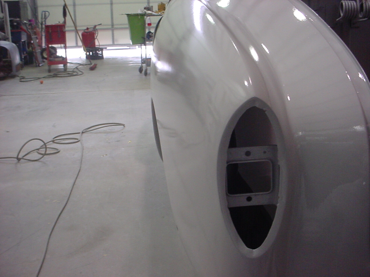

I saw this one in the flesh last week at Mike's body shop.
Really impressive metal and body work, no cut corners. It's going to be a beauty. Can't wait to see it with color on it.
Yes, Mike does exceptional work....the nose on this ghia looks like a virgin nose...its remarkable.

awesome work guys.
What are you planning to do with the old nose? I know it isnt perfect but its 10 times better then the one on my 69.
The65ghia
Joined: July 14, 2008
Posts: 54
Location: Oregon
The65ghia is offline
PostPosted: Tue Dec 28, 2010 11:10 am    Post subject: nose Reply with quote
Well, its pretty cut up now we used bits and pieces from three different nose sections to make the one you see:)

Well, we primed it the final time with high build and we are blocking it everywhere a block will fit:) After its blocked we will seam seal all the joints inside and out. We are fitting the doors, hood, deck lid, and all the other parts making any adjustments that are needed. It is coming together better then I could have dreamed when I started, and should be in color by the end of the month. I will post more pictures after its painted. Also here are some pics of all of the metal it took to build what Mike and I call "The Apache" Smile

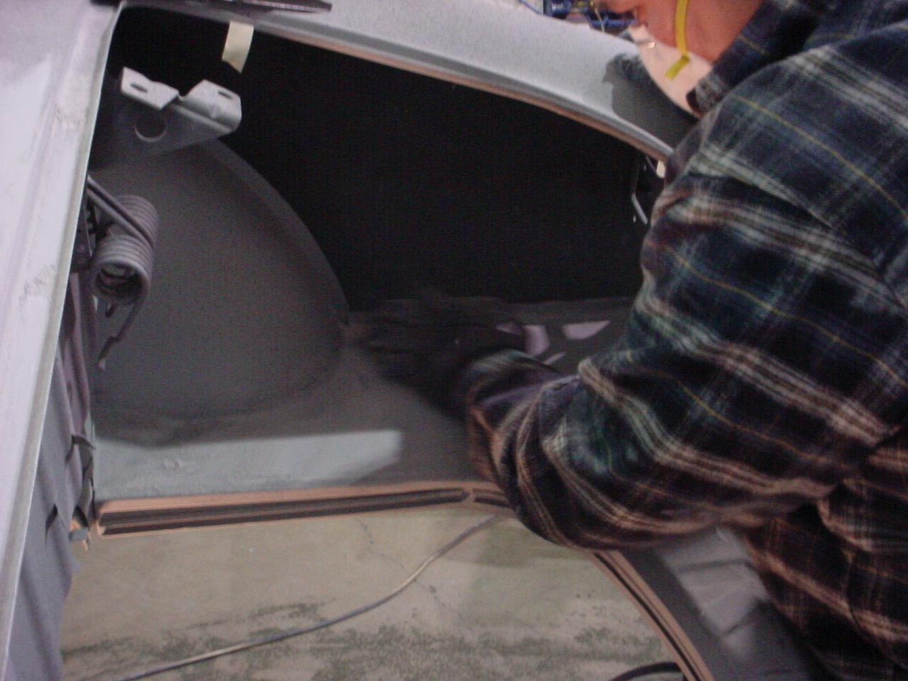

Well, Mike sprayed black rubberized undercoating on the inside of the car below the carpet line. He also sprayed tinted bedliner in the fender wells, and everywhere visible underneath the car. Mike has been teaching me alot about taping and masking to help prep for him to do his majic Smile Mike also painted color on all the inside stuff dash, inside nose, jams, engine compartment, etc. Anyhow here is some pictures of our progress, and we hope to have the rest of the car in color by the end of the week, and then its cut and buff so I am looking forward learning another step of the process.

Ahhhh.... More Ghia porn. Thanks so much for my fix Cool
By the way, I'm not sure if it is exactly the same product but I've very happy with the chip guard used on my wheel wells. It has performed perfectly with almost 7 years and 4,900 miles on it.

Awesome! Thanks for the pics. I bought the UPol kit and was wondering about the coverage with the tint. Did it cover (in terms of color) in a single coat? How much of the product did it take to do the wheel wells and assorted parts? I bought the 4 bottle kit and I'm hoping to do the wells, under luggage area and inside the front spare tire area... Would be nice to do the bottom of the pan if there is extra material.

I took five quarts to do everything you see in the pics no pan. Thanks everyone for the complements! Our hard work is coming closer and closer to being done. Hope to have outside of car in color on Friday Smile
