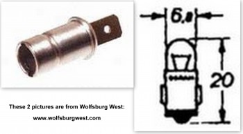

INSTRUMENT LIGHT BULB HOLDER (push-on style connector)
There are six of these alone on the speedometer unit, and naturally each one also needs a DASH LIGHT BULB (fits all illuminated dash instruments, 12 volt). I learned when I put in a rebuilt speedometer awhile back that if you have these and they are from 1967, chances are some of them are going to break, no matter how careful you are. I planned ahead this time and went ahead and replaced all six, and the one for the gas gauge (totaling 7 new ones), along with new bulbs when we did the re-wire.

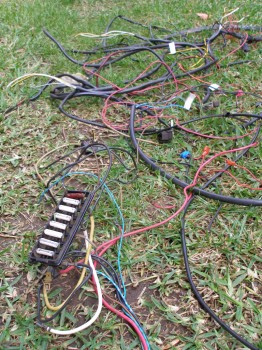

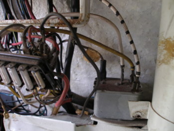

The first major step is/was disconnecting the old main (13’ long) wiring harness, attaching it to the Fish Tape, pulling that through (carefully, watching for snags), and then attaching the new harness to the fish tape and pulling that through. In all honesty, that was perhaps the fastest and easiest part we did.
The good news for (at least in a ’67) is that you do not need to remove the engine to do the rewire. You do, however, need to remove the front dash tray (we managed to leave mine kind of off to the side with the speedometer cable end cap preventing it from being removed entirely out of the bus; you’d need to remove the cable otherwise). You also do need to get to the connections on the solenoid of the starter motor, which is never fun on your back with heater box and such in the way (but not impossible), and one other big challenge was attaching the gas gauge wire on the top-back of the gas tank since (at least in my bus), we could not see the connector, and had to do it 100% by feel.
Things get a little more challenging when you are disconnecting and reconnecting the spaghetti mess of wires in the front which go to the instrument panels. You have to realize, in advance, that depending on the history of your VW, there may be any number of jimmy-rigged parts, wires and modifications made over the years. Although much of mine is stock, I did have a few dash “fires” in high school in which old wires burned up, and being a starving student, I had replaced wires with some wires I got out of the guts of an old washing machine.
This is why it is important to; 1. Have a working understanding of electronics, and specifically VW electronics (not as “logical” as you might hope), and, 2. Have that wiring diagram handy!

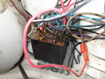

The first problem we ran into is that one of the three male terminal posts on the original key ignition switch broke off as we were getting the speedometer back into place. Realizing we wouldn’t be able to fix it, we did learn of another great resource in Chico, CA: Brian Houston of Late Night Air Cooled ( http://latenightaircooled.com/ ). Not only did he meet us at his shop (although he wasn’t working that particular Saturday), but when he didn’t have the right part for us he tracked down someone who did, called us up and sold us the replacement.
Once we thought most everything was hooked up correctly, we had a problem that as we turned the key to first position the starter-motor immediately engaged. Simple and stupid problem, but this does help illustrate that things can go wrong, and you have to think through things… the problem was that one of the wires at the bottom of the speedometer, which becomes live when you turn on the ignition was touching one of the wires on the key ignition switch which sends a signal to the starter. We bent it away (naturally disconnecting the battery’s ground as we were looking for/figuring out the problem), and then that was fine.
The last confounding problem we had involved understanding completely how and why the “Black Box” flasher relay works the way it does.

The problem we were having was that although the hazard lights worked, and blinked properly, the turn-signal blinkers did not work at all. After a lot of time checking everything and thinking about it, as well as tracing lines, we came to the realization that part of the rebuilt turn-signal switch from Wolfsburg West was not working properly. We got out the guts of my original one, soldered one detached wire on it, wired the old one in and everything worked perfectly.
