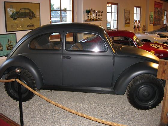

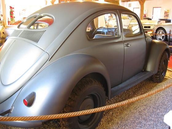

PostPosted: Tue May 31, 2011 9:47 am    Post subject: Reply with quote
Chris
79SuperVert
Joined: May 31, 2002
Posts: 9758
Location: Elizabeth, NJ & La Isla Del Encanto
79SuperVert is offline
PostPosted: Tue May 31, 2011 9:55 am    Post subject: Reply with quote

Great pictures, unfortunately the parts I'm really interested in are not shown, those are the drivetrain between the transmission and the differential including the transferbox. Where is this vehicle and is it a genuine Type 877? Perhaps I could contact them? Cheers.

PostPosted: Tue May 31, 2011 7:24 pm    Post subject: Reply with quote
not sure where it is. Those were just some pictures on the Samba that I remembered from a few years ago.

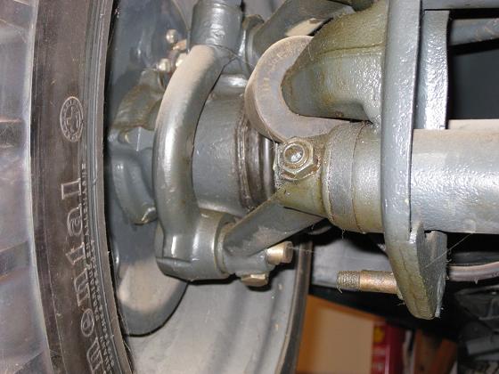

PostPosted: Tue May 31, 2011 7:37 pm    Post subject: Reply with quote
A guy named Ondřej Bromo in Prague claims to be working on a true 87/7 .
just pm me for his contact info

PostPosted: Wed Jun 01, 2011 2:32 am    Post subject: Reply with quote
Thank you KaferKrieger, this picture shows me that my parts are not from the 87/7, the linkage between the transferbox and gearbox are longer than what I have, and therefore the main driveshaft between them must also be longer. The type 166 has a shorter wheelbase than the Kubel, so I suppose it was obvious, but now I know for sure.
Also thanks to Undis for the drawings, as they clearly show an unmodified type 166 gearbox, although that is not to say that the design wasn't modified since the drawings were made, as in the case of a few components in the schwimmwagen.
Well all this leaves me back at square one, ie: I have previously unknown parts of a KDF drivetrain for ???. I must say that I am now slightly leaning towards them being a very late war modification of the schwimmwagen to improve strength, but this could only be the case if there is any known weakness in this area, something I have not heard of previously, but have not looked into. The reason I am leaning this way is simply because of the length of these components, they are for a very short wheelbase and the only KDF vehicle I know of that fits the bill is the Type 166. This theory does have holes in it though, materials and resources were short in '44, so why use more bearings, metal and time unless you have to, bearing in mind that a schwimm might not expect to last 8 weeks! Porsche did also work on a tractor with KDF components, so perhaps this is worth looking into? I suppose that I need to take the parts to some expert who can actually say wether these are genuine wartime parts. Unfortunately most KDF records were destroyed either during the Allied bombing of KDFstadt/Wolfsburg in 44 or when it was vandalized by the slave labour (fair enough) they were using when the Germans retreated from there in the face of Allied advances and left them behind.
Thank you all once again for your help, Cheers

PostPosted: Wed Jun 01, 2011 6:11 am    Post subject: Reply with quote
Hello, my name is Ondrej Brom. That photograph really is mine undercart. Be surprised, how got upon this forum.
Firstly I have to tell, that the don't assert, that the is that a original undercart plus or whole car original type 877. I to everyone will say, that the this vehicle is replica. It means, that the this whole wagon be premised from original part. This concrete my vehicle at war really didn't originate.
Like I'll trace next symposium about this interesting vehicle.
I am sorry for mine English. At all English I don't know plus use Google translator.

PostPosted: Wed Jun 01, 2011 6:30 am    Post subject: Reply with quote
Hi.
More photos from Ondrej Brom's (aka OUB) chassis.
Have a fun

PostPosted: Wed Jun 01, 2011 9:14 am    Post subject: Reply with quote
Wow, Sameleon, that's some amazing work you have done, I'd sell my family for that rear end! I've been looking a long time for that gearbox, one day another will come along! Did you lengthen a type 166 driveshaft and gearbox linkages? Are you in the 166registry.com too? as Kaferkrieg said, more photos please Very Happy .
