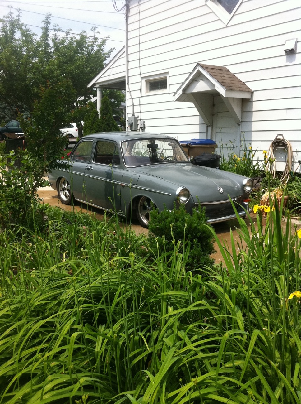

Mine's not down nearly as much as some of the others here, but then the roads around here aren't condusive for driving a really lowered car either, as we have frost heaves, piss poor road rebuilding, pot holes big enough to swallow a large child, and construction zones almost everywhere in Michigan. Shocked
Here's a pic of my 65 Notch.
It's down 2 inner splines up front, along with the factory (41 year old) sag in the rear (it's on a 70 pan). It's running 195-60-15's up front, with 205-70-15's in the rear. It doesn't beat you up, and it makes a nice comfortable long distance cruizer. I drove it last summer to and from the T-3 Invasion (about 2000 miles 1 way). In fact, I drove it for over 16 hours straight coming back from Carthage Mo, and I wasn't even wore out from being on the road that long. Cool
