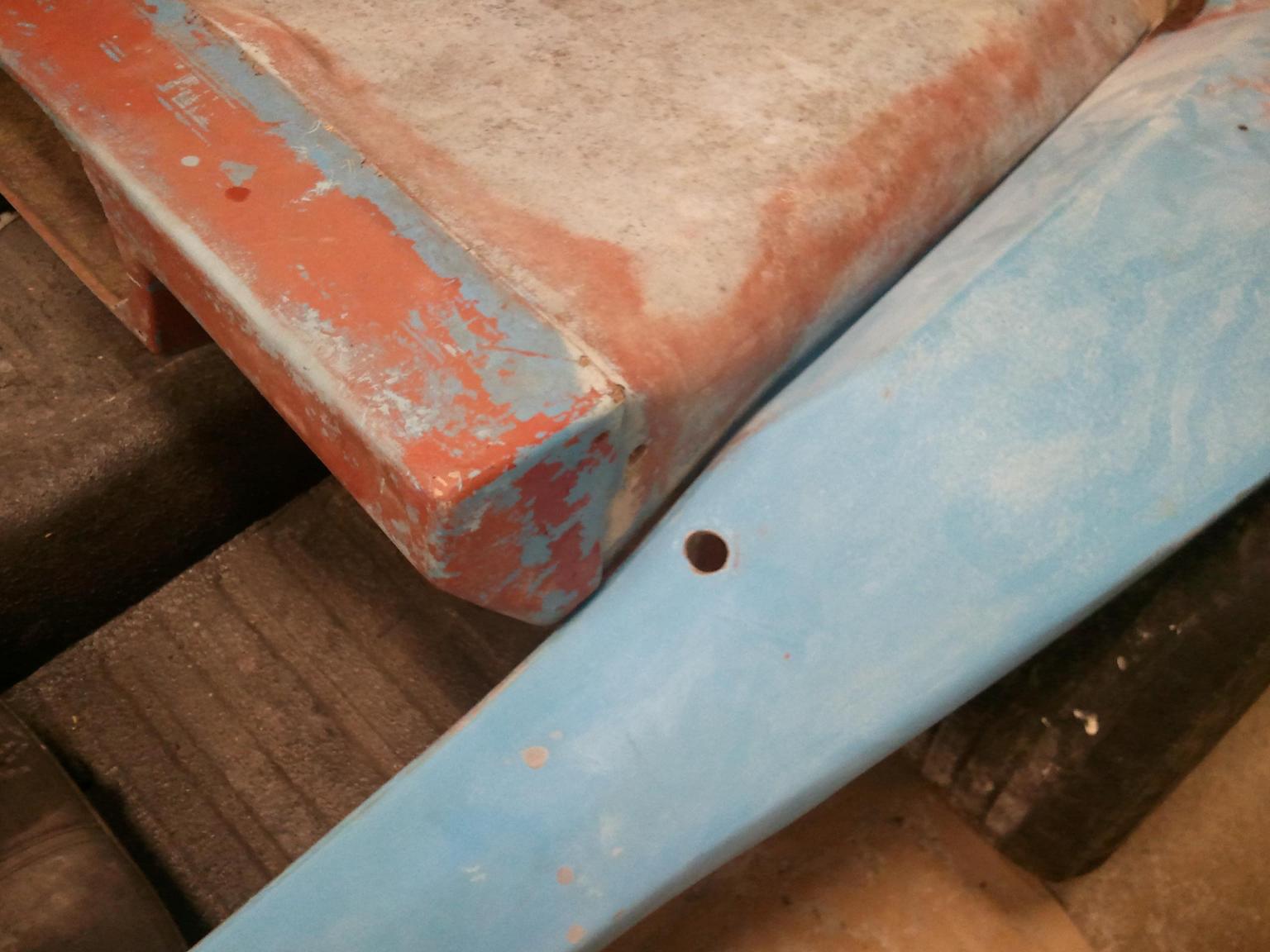

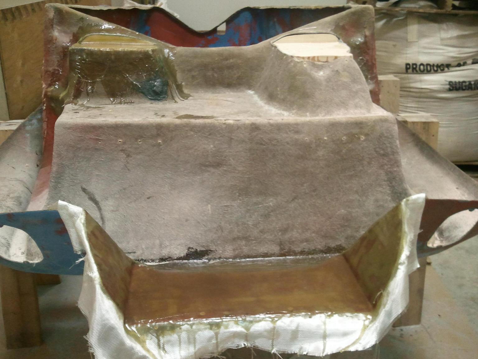

some pics of the glass work im doing
basically it sat for 10 months with out much work done to it. i did manage to install the adjusters and it made a huge difference in the stiffness.
even before i adjusted the adjusters i noticed is was looser. i think maybe i just didnt grease the seals and the arms enough on my first install and that made them bind. i was really anal about getting any dirt or grease on my new chassis. it looked too pretty.. now that its been sitting and been collecting dust i didnt care and i greased the hell out of the empi red seals and the front arms. oh well. now i know. i shouldnt keep everything spotless.

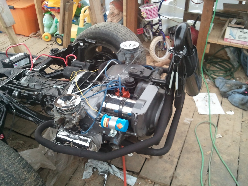

PostPosted: Mon Apr 30, 2012 7:36 pm    Post subject: Reply with quote

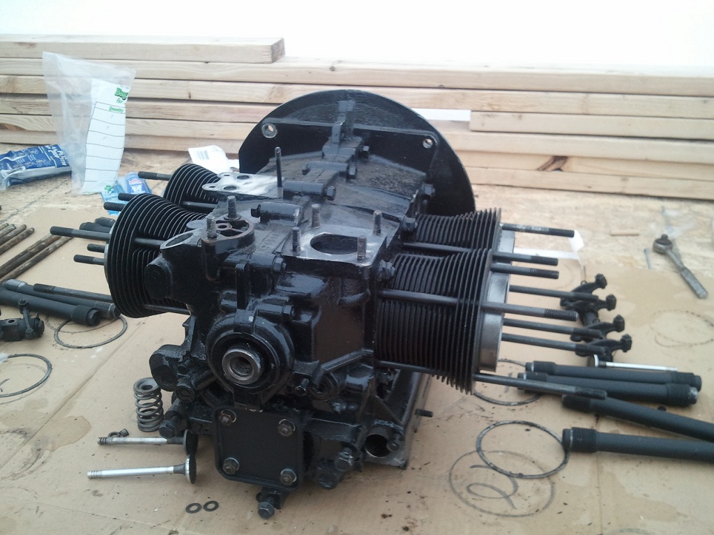

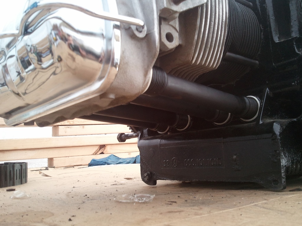

so. its been awhile since I last posted. ive rebuilt the engine, installed it, painted the body, now im trying to fit up the exhaust.
ill post pics as soon as I have time. its a process.

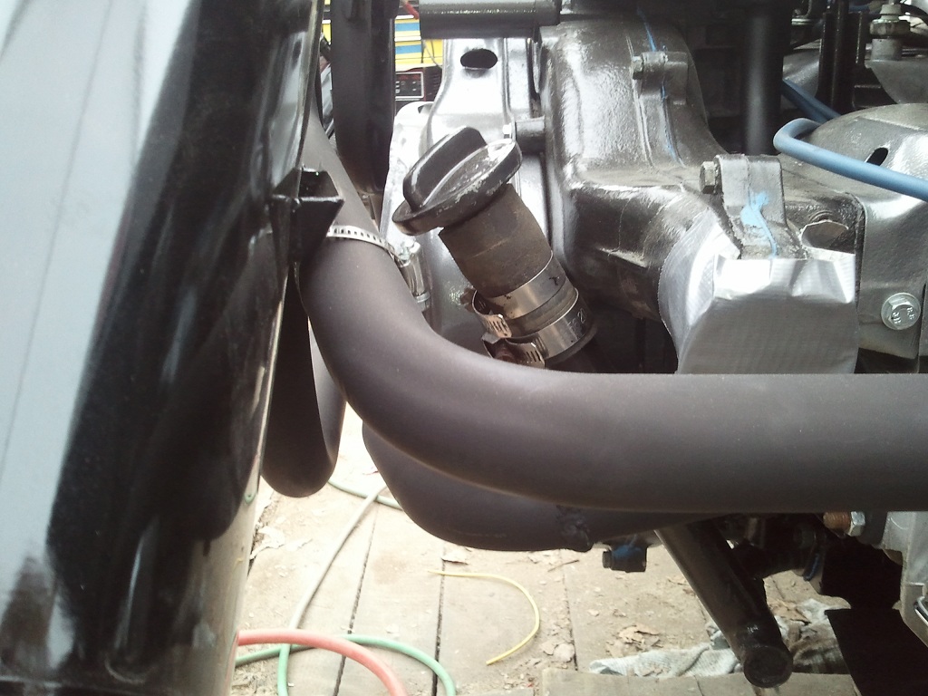

does anyone have pics on how to get a 4-1 exhuast system with muffler to work with a type 3 engine? ive got passenger side done. drivers side is kicking my ass.
its a stinger style exhaust with a j pipe and muffler.
I had to lenghten one pipe 4", another 3.5". they were both easy straight add ons.
the drivers side is different for some reason. they both need about 4" leghth added. but they are about 2" different in hieght. they also hit the type 3 cooling shroud.
I need to post some pics to explain. just wondering if anyone has ever mounted that type of exhuast to a type 3.

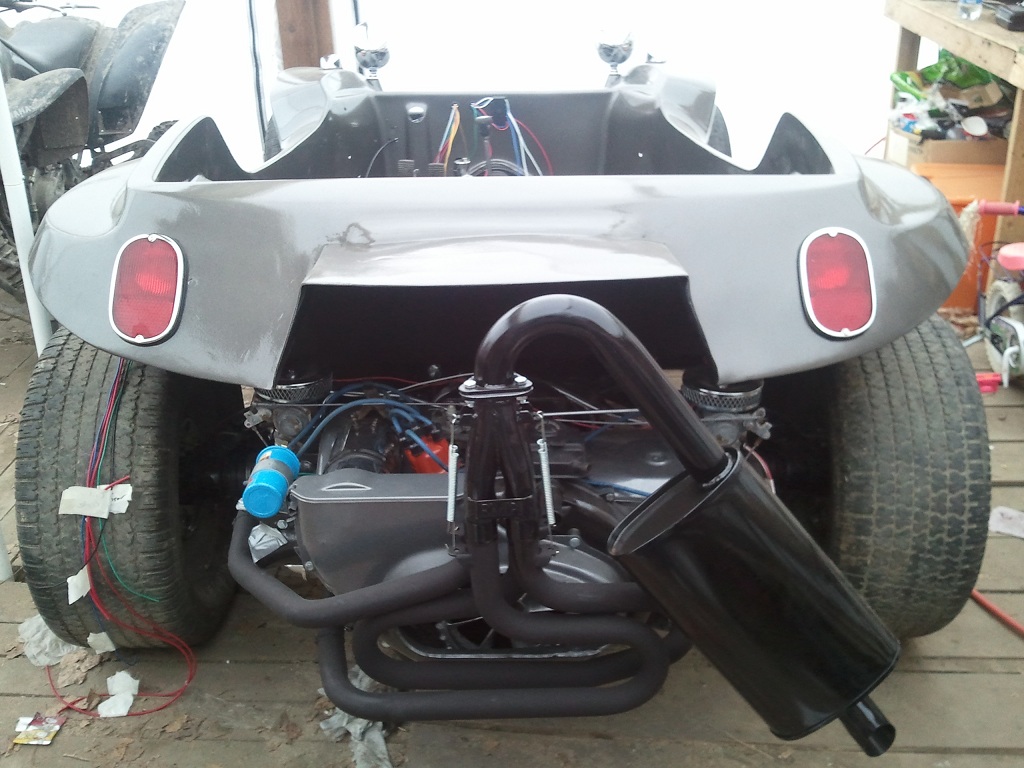

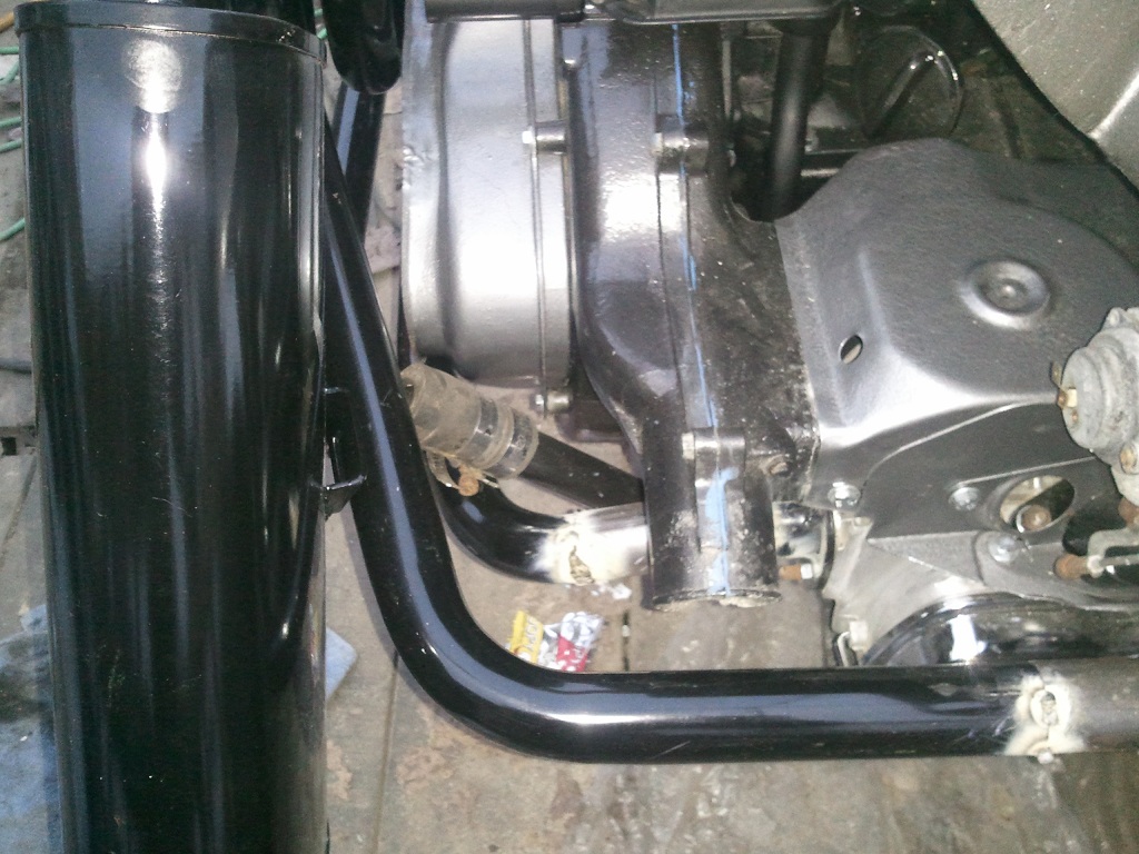

okay. another update. im currently at a bar getting some food to go. ive got a bunch of pics to post. its really coming together now. engine totally put back together, fired it up even. runs great when cold. kinda wont idle when warmed up. I just sorta bench ran it. electric chokes arnt wired up yet. just droped a fuel line in a gas can and ran a wire to the coil.
exhuast is fitted up, welded and painted. looks pretty cool. usually all you see on type 3 engines is the "cannon" type.
all I had to do was lenghten the pipes and cut and roll #3 exhuast pipe near the head. also had to cut and roll the dipstick tube to clear the muffler.
started bolting down the body. I made an 1 1/2 x 3/16 plate to mount the body to the pan. it goes down each side of the pan. basically just one continuos washer rather than a bunch of seperate ones.
so now ive started wiring. pulled the wires through the wire loom I glassed in. labled all the wires.
now my question for you guys. how do you hold your wires in place? I dont want to drill holes for wire clips. if I was thinking ahead I should have glassed in some more wire looms or clips or even some wood to screw some mounts into. I thought about some kind of glue. but I dont know what kind people have had success with. I used the rustoleum bed liner stuff in the engine compartment. its basically thicker paint. I can take some off to install wire clips if I need to.

PostPosted: Thu May 31, 2012 10:19 pm    Post subject: Reply with quote
here is some pics on how the buggy is coming. so the exhuast is done. as you can see i had to cut and roll the dipstick tube to clear the exhuast.
the self adheisive zip tie mounts look like something i could use. like i said, i glassed in a wire loom along the side of the body, but i should have put some in the front and rear also.
