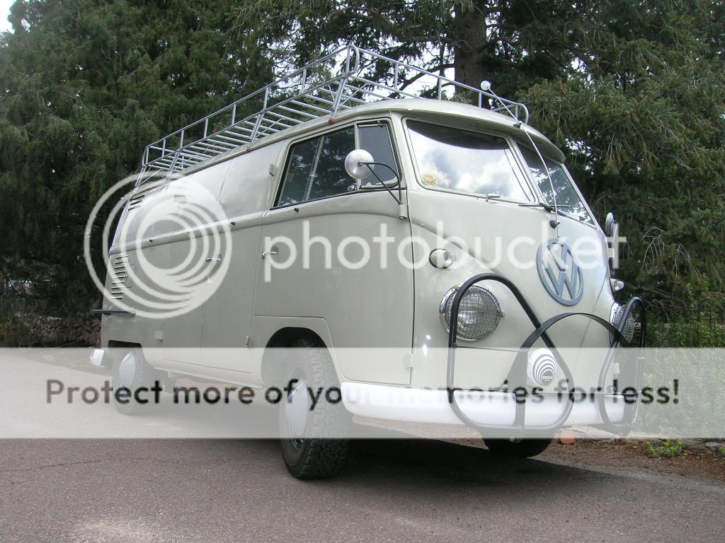

A friend of mine just used Krylon smoke gray for his bus
one in the sun
Since Ive not owned an anthracite or mouse gray vehicle not sure what it more closely resembles but comparing other pics to me it looks more like anthracite than mouse

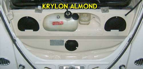

Slammer wrote:
CookieMonster35 wrote:
L87 Pearl White- Krylon Almond
I have just found that Krylon Ivory is a closer match to L87 Pearl White on my og paint SC than Krylon Almond. FYI
I had to replace the panel around the windshield washer bottle and brake fluid reservoir in the spare tire well in my Pearl White 62 a while back. Since the weather has now warmed up nicely I decided it was time to paint it. I had some of Krylon Almond, so I used it.
Now, I know my car doesn't exactly match mixed L87, due to the painters I've used in the past custom tweaking the color a bit. It is pretty close, but not exact. So if the paint in the spare tire well was off a little, I thought it wouldn't bother me. But it did, because that Almond was a lot further off than I expected.
So today I went through the spray can aisle at Menards looking at colors. I chose Rustoleum Canvas White. Resprayed the area tonight and found I was much happier with that one. It is still not a match, but it's much closer.
