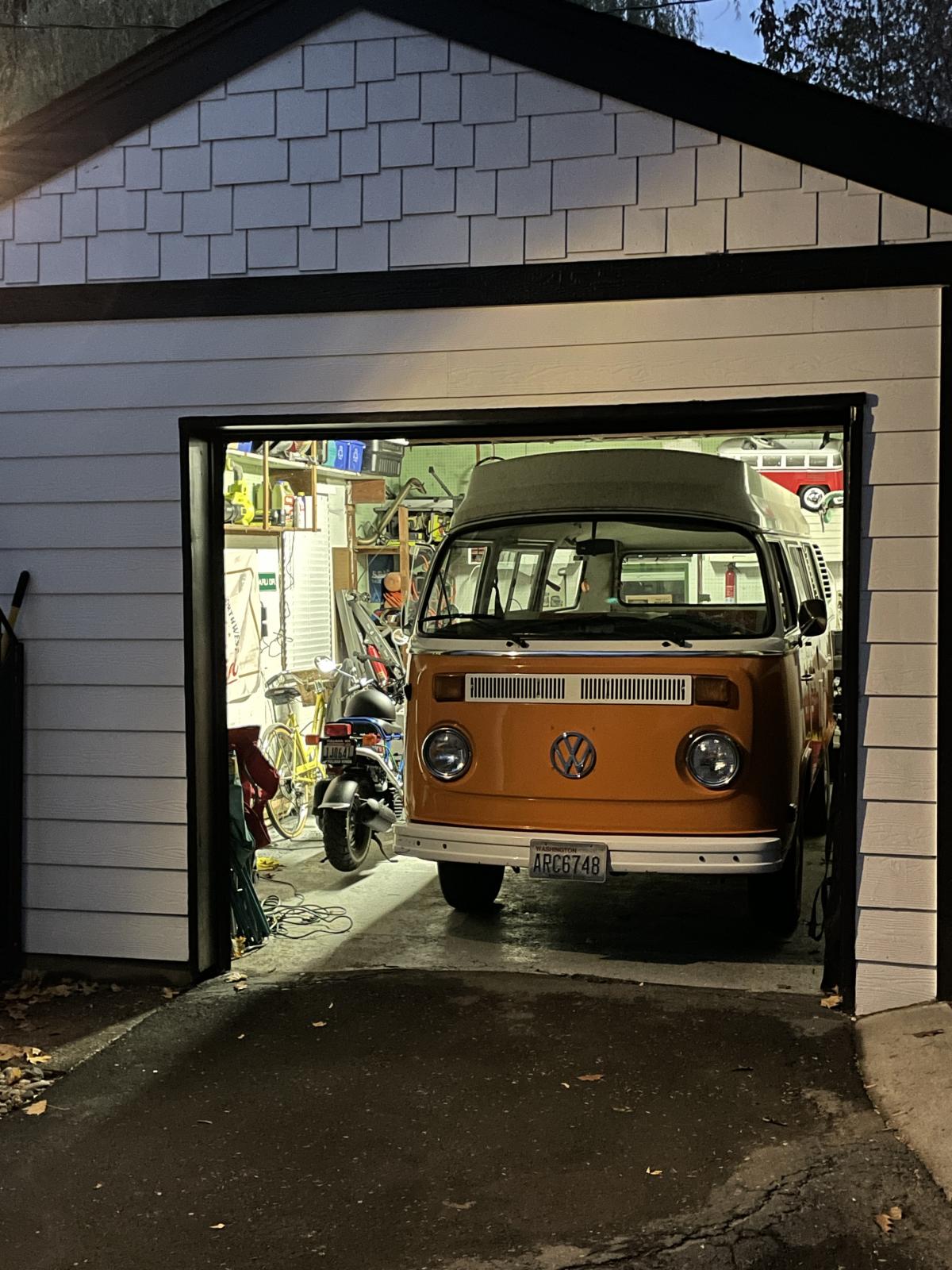

Parked in the garage to stay dry:

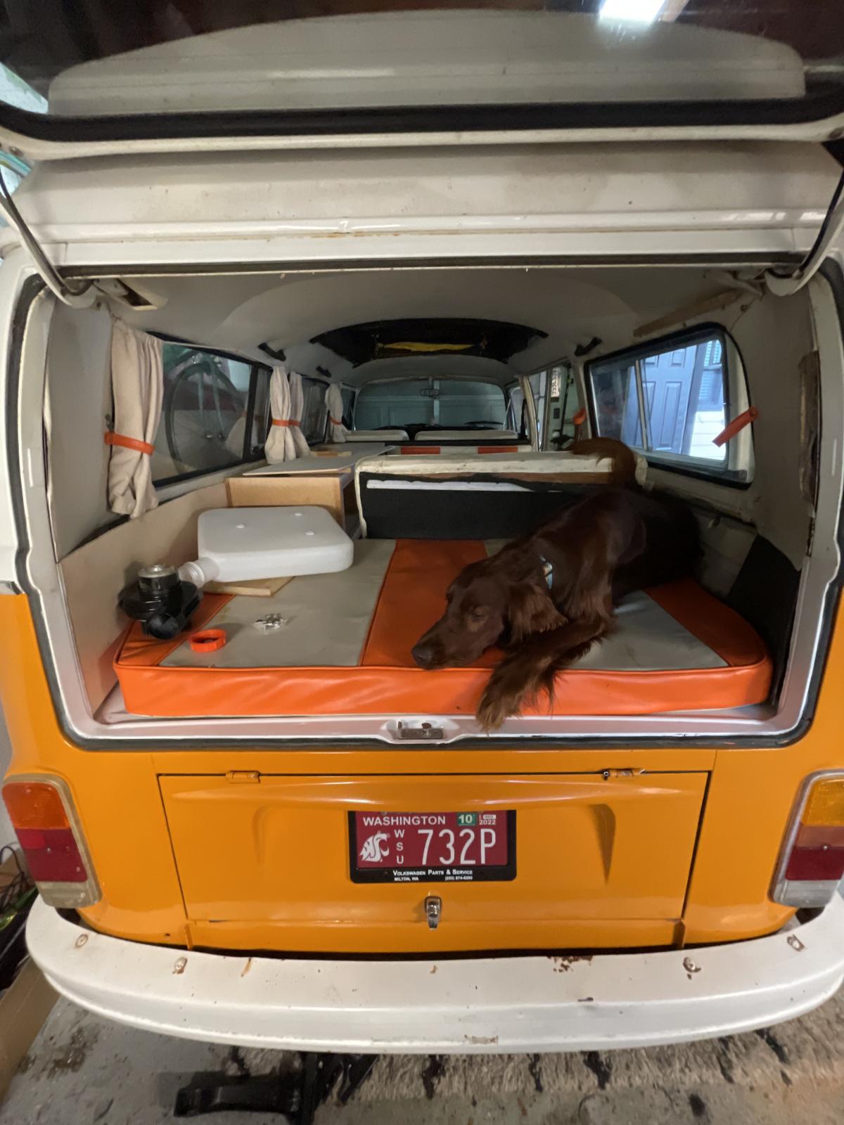

Got the spare tire put under the front bench seat in it's factory location. Just gonna pretend I cant see the four holes where the tire mounted on the nose. Logo instead:
Cleaned up some surface rust and pitting on the rear shelf due to the back rear window seal.

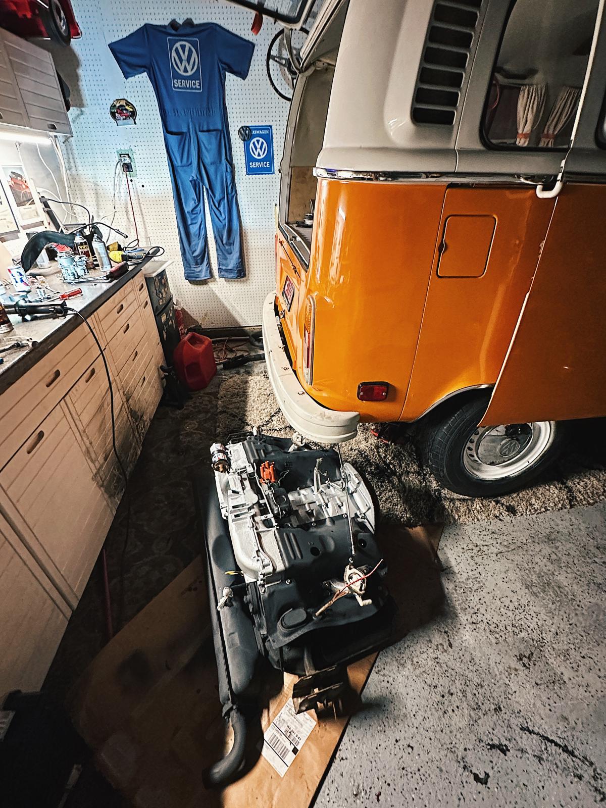

Engine is a type 4 with dual solex's. Need to get them dialed but drove the bus around a bit today around town. Need to do fuel lines but those are on order. Few of the exterior lights work, likely because of all the moisture the connections were exposed to so I will start to tackle all of that stuff soon.

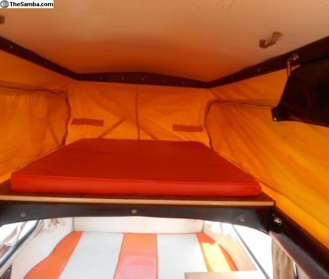

Here are pics I have found of the bus from around 2015 from old samba ads/Pinterest/various websites:
Someone did a nice job and then it just got neglected. Looks like they had it posted for 13,000$ in 2015 when it sold as well.

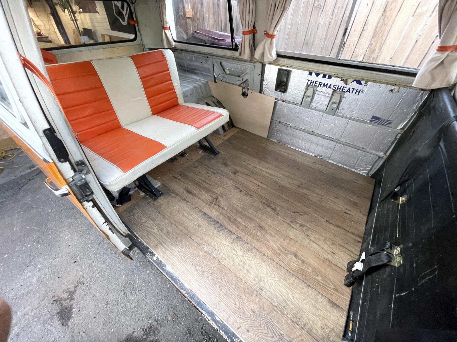

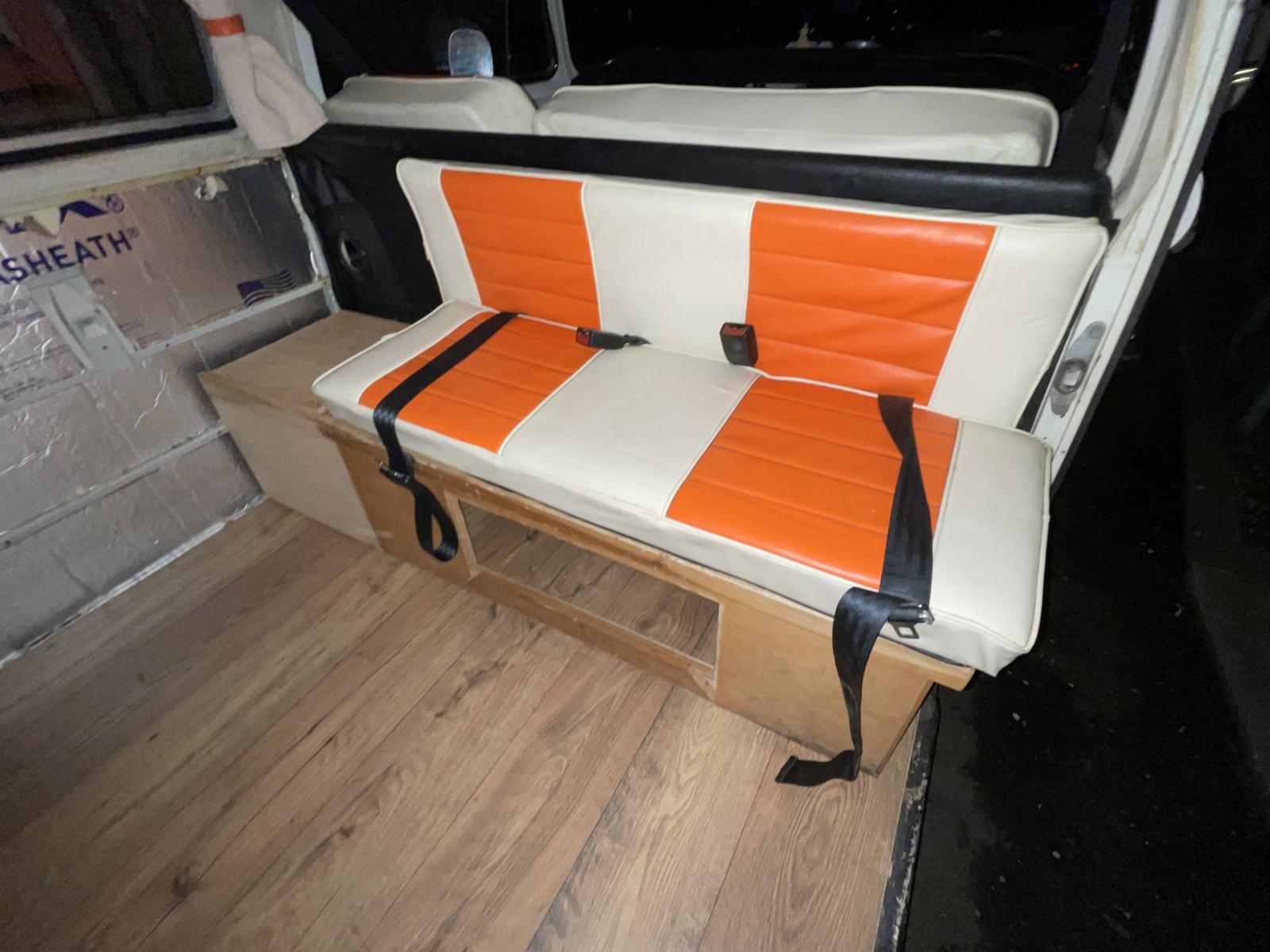

Spent all day today insulating the bus and getting the subfloors and flooring installed Cool
Furred out the floor with some 1x2 pine and some 1” foam insulation. Should be cozy in here:
Followed up with some 1/2” plywood that acts as the subfloor:
Got some click flooring installed and paid a little extra for the vinyl stuff so it’ll take more abuse:
Cut out some new interior paneling out of birch because all the panels were molded and rotten:
Got the jump seat bench rebuilt with new wood in place of the rotten wood. Still need to sand it and stain it, not to mention build a new door for it:
Excited to get some stain down on all the wood and get this interior done.
Gonna do a bunch of modifications on the old cabinet setup but will try to reuse as much as I can:

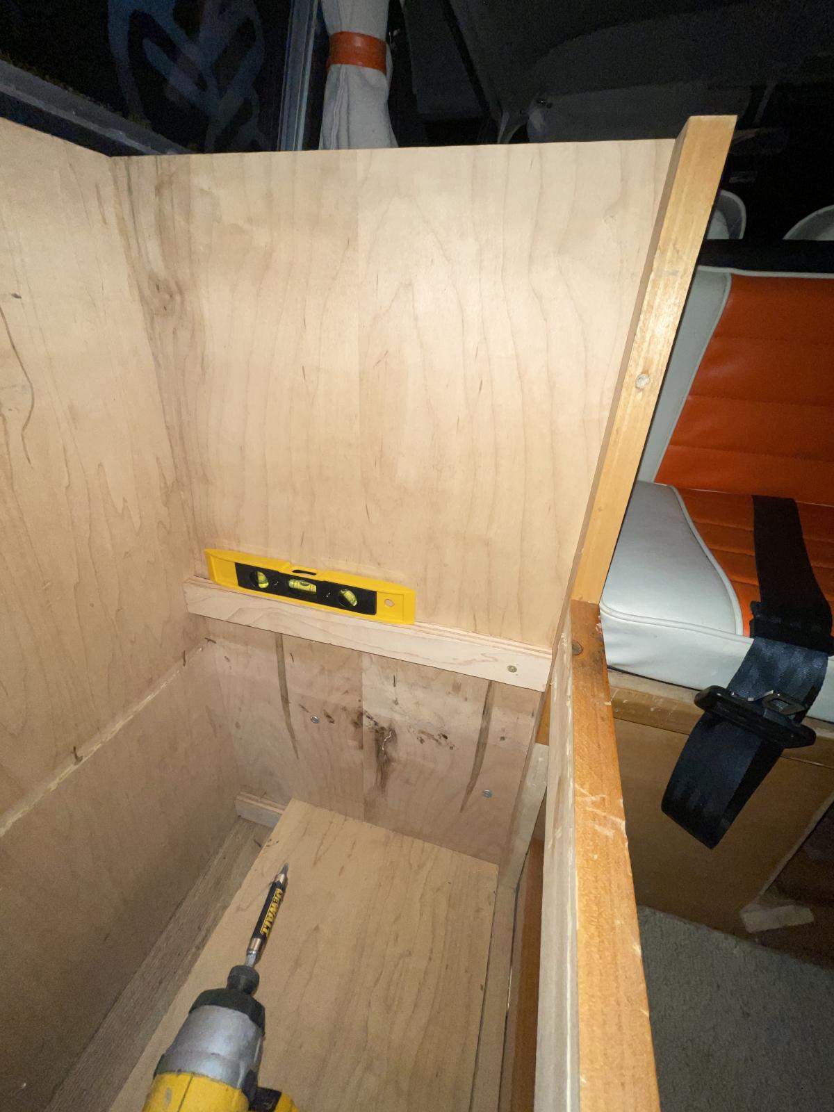

Been trying to get all the lights to work on this thing and finally there with it now. Cool Cleaned all corrosion on all the connections and grounds. Had to replace the headlight switch itself as it wasn’t triggering the headlamps.
Cleaning up on the roof as well. Using a fiberglass polishing compound.
Shop helper remains loyal:
Roofage:
Making slight modifications to the cabinet layout as I’m going to do a different setup for the stove. Just raised the middle section there.

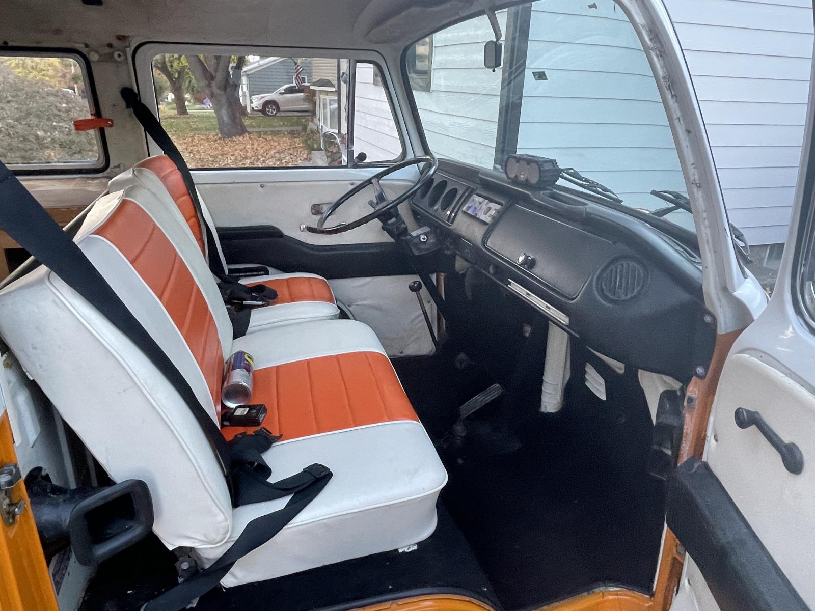

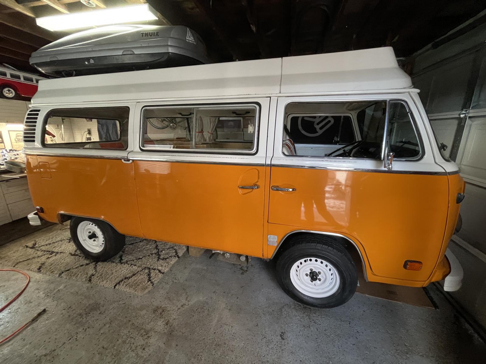

Been doing some interior work on this thing to make it nicer to daily once the snow and ice cook off. Ive remade the front door cards, and the slider, and the rear hatch but am going to glue the burlap coffee bags to give it some character.
Repainted the wheels white and took off the cheap chrome beauty rings.
Got the engine lid painted black and it looks really sharp.
Lucky I got a good shop buddy to hangout with me during these cold winter months

Had our first nice day since November so I took the bus for a drive to knock the cobwebs off and I ended up stranded on the side of the road with what I believe is a dead fuel pump. I replaced it just need to see if the bus will fire off now.
Filled it up right before hand so don’t know if that had any effect on it dying. It’s got a new fuel filter and it is unclogged there so don’t know why the old fuel pump might’ve died
Roadside stranded. Luckily I broke down about a block from sisters house and just pushed it there
If anyone suspects something else would be interested in thoughts. Fuel pump normally pumps when I go to ACC on ignition but it didn’t and would only kinda do one little squirt of fuel if I turned key to start. Don’t know if fueling up would’ve done anything. Carbs need tuned but I wanted to get out and maybe that was cause. I’ve really only got them on a base tune right now

Got her running kinda Gooderish to run around town. Still need to dial in timing. Just ordered a timing gun with digitally rpm readout. Also still need to tune carbs a bit they don’t want to sync up.
Painted the inside cabinets. Painted the ceiling and installed some LED lighting. Got some of the cabinet doors painted just need to hang them. She should be good to go soon!

Pulled the engine because I dropped a bolt down the manifold and couldn’t get the manifold off without taking the tins off and so I said ah what the heck let’s just go. New plugs/wires. New throttle cable. Vacuum lines. New fan shroud cover. Got it slapped together ready to go back in
