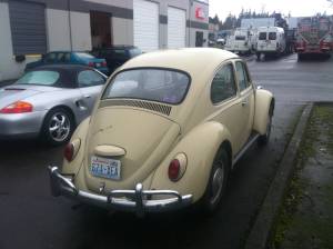

So today i brought home a 1967 Bug that i bought from an 88 year old man who owned it since 1991. Its gonna be a learning experience as this is my first vw, and first car Shocked . Im only 16, but i've studied up and am ready to learn some more. I worked over two summers mowing a lot of lawns, and basically just liquidating my room. Luckily, i can now get a real part time job instead of mowing lawns now that i'm 16. Nevertheless, the bug.
1967. Sedan. og 1500cc engine. Og paint on the interior. PO recently had a new interior installed. I kinda like the style he made it. Anyways, it does have some rust, (all vws do), mainly on the driver's side door lower hinge. and on the actual body itself. Im probably going to have it cut out and weld in a new piece. the last paint job was pretty crappy and there are bubbles i'm going to have to sand and prime until i get a paint job on it.
Some Pros: Pretty original, heat works so thats a plus (live in WA), all the electricals work, even the dome light, the headliner is og(and beautiful), horn works, on the drive home from the purchase we (my father and i) got it up to 68mph on the freeway. PO had a new steering box installed.
Cons: got to fix the body rust, missing the og radio, I Need more funds Very Happy
Anyways, this is going to be a journey for my father, who knows a bit about vws, he had a 72 back in the 80s. Any help would be appreciated.
My plans are to drop it a spindle or two. new paint( same Savannah Beige), some BRMs maybe, just clean it up and make it a nicer daily driver than it already is. Laughing
Sorry for the crappy Craigslist pictures. Better ones soon to come...
Front
Front
Rear shot

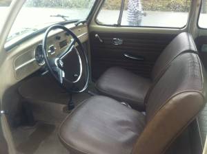

Interior

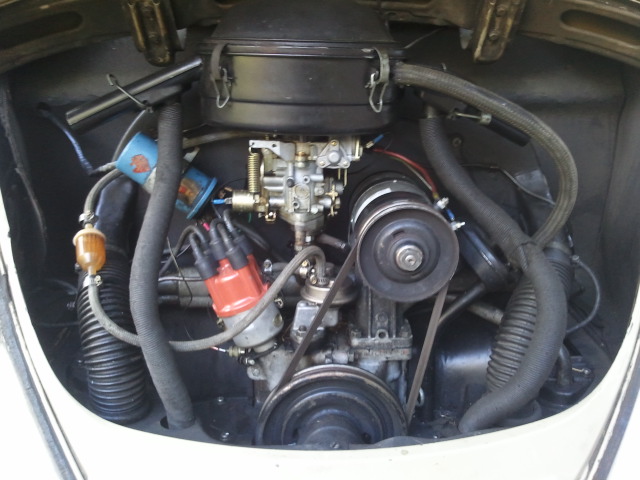

1500cc Powerplant

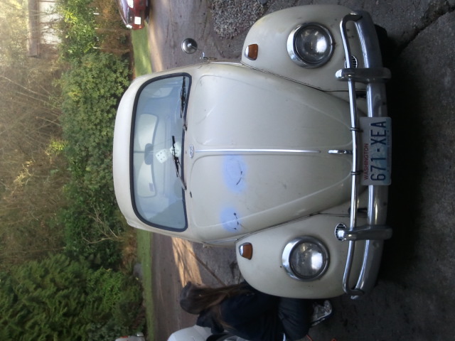

Front shot

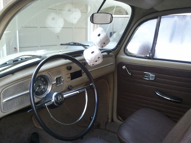

Interior

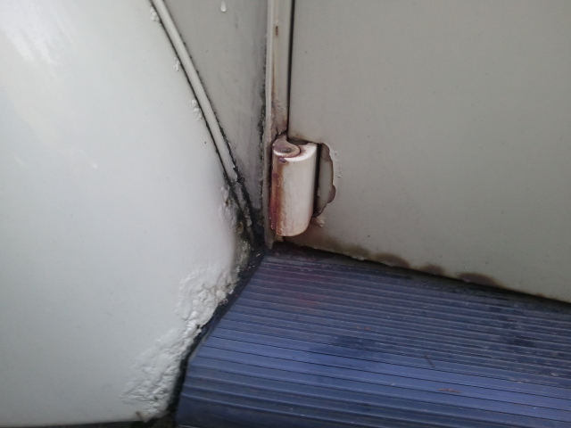

Door rust

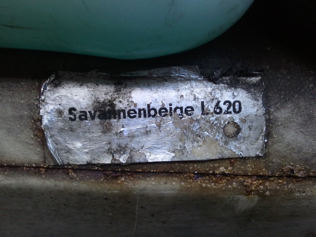

Og paint code
Dice Very Happy

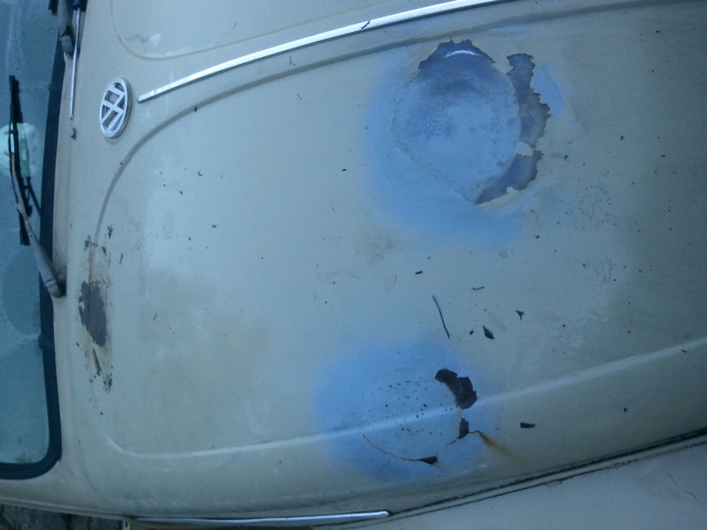

Worst of the hood

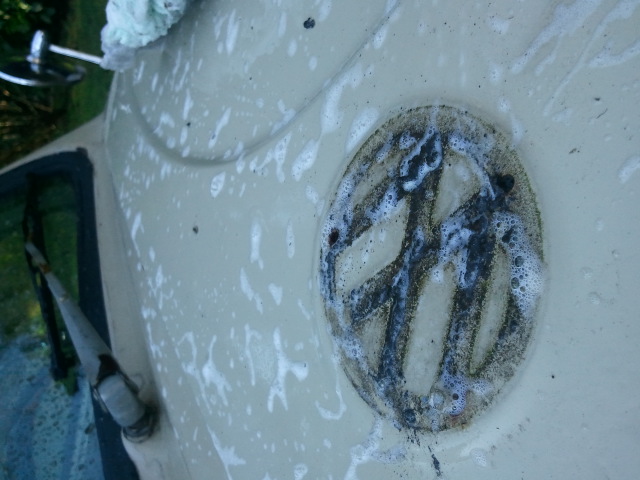

Washing it up

The door has a small section rusted out. I've got it cover up to protect it from rain. But what should i do to fix it? cut it out and replace? Also, what would be a good spray paint that i could use temporarily as primer that is relativity close to Savannah Beige? Thanks

Nice car! First thing,get rid of that fuel filter.

Try lowes or home depot for something close to savana beige. There is a topic in the body and paint section about close krylon matches.

Looks good, congrats on the purchase.
For the door, you have options. You can either repair it, or if it's beyond your skill, buy another door. Same with the fender, if the rust is too cancerous. The A pillar however will eventually need sheetmetal from what it looks like, and that's something that will require some cutting/welding. So either way, if you're up to the task you'll get some fab time in on it.

so it looks like i am getting a 1967 correct passenger door from my cousin in beige. og on the inside too. and buggut, whats wrong with the fuel filter??

They come loose and spray fuel in the engine compartment, causing a fire.

There's concern regarding having a filter inside the engine compartment because of the potential for the plastic to split, which could result in an engine fire. Most folks recommend putting the filter either underneath the fuel tank or above the transaxle. I have also heard that the setup should allow the pump to pull fuel through the filter rather than pushing it through, although I don't know if that's for sure an issue. I would recommend getting the proper German cloth-braided (5.5mm?) fuel line, too, and replace all of your rubber fuel line from the tank to the engine with that. It really fits well compared with the incorrect sizes offered at normal auto parts stores. It's a good idea to replace it every few years.
