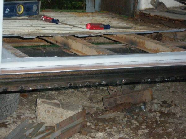

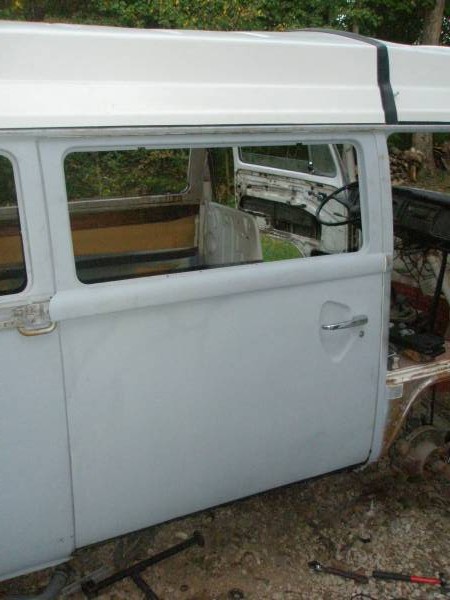

PostPosted: Mon Sep 12, 2011 7:46 am    Post subject: Reply with quote
We were ale to get some much needed work done, but things went very slow yesterday. I was able to replace all but the front top-hat and front reinforcement piece.
Cleaned and prepped cargo floor, hopefully the holes will lineup
Working on the top-hats
I'm not sure when the last time the sliding door was on the bus, but it's on now! Putting on the new door track and hanging the door took us about 5 hours. I had no idea that it would take so long, but she's on and closes!
New track installed
The door actually closes, but the latches and eveything else need so major tlc.
