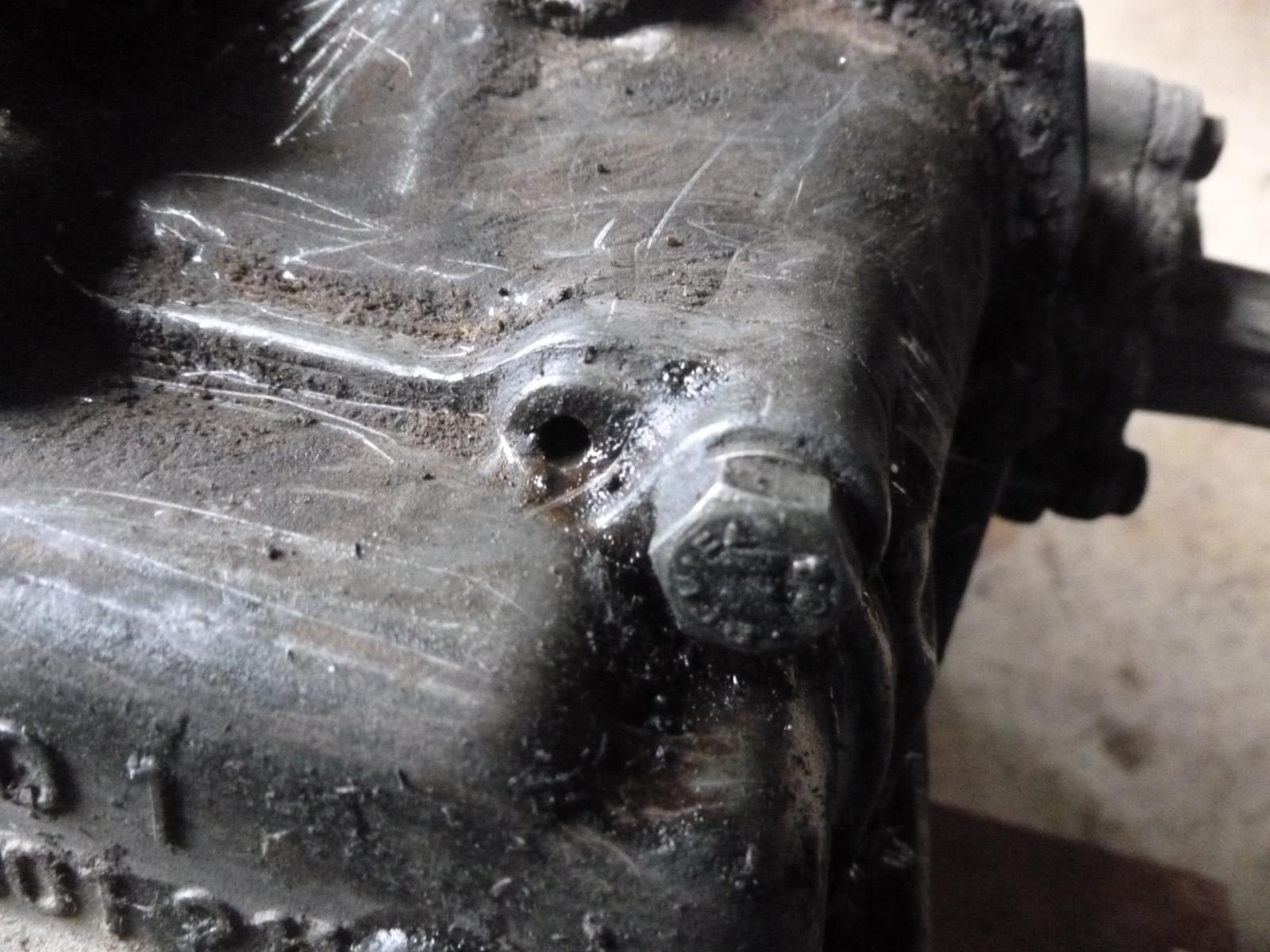

PostPosted: Wed Feb 20, 2013 9:12 pm    Post subject: Reply with quote
Be sure the atmospheric bleed is not clogged or all your labors will be for naught.

PostPosted: Wed Feb 20, 2013 9:39 pm    Post subject: Reply with quote
Phishman068 wrote:
Wonderful!
I'm having a bit of a senior moment and have forgotten just where the vent is on a 2wd manual trans?
I know autos and syncros.
I must be getting old.
Follow the leak trail up.

PostPosted: Wed Feb 20, 2013 9:40 pm    Post subject: Reply with quote
Arrow

PostPosted: Wed Feb 20, 2013 11:55 pm    Post subject: Reply with quote
If your friend has a syncro there is no breather hole there.

PostPosted: Thu Feb 21, 2013 4:48 am    Post subject: Reply with quote
Here she blows:

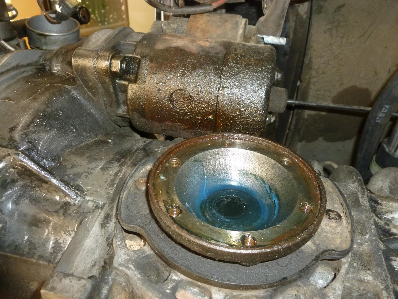

cellerdoor
Joined: July 10, 2012
Posts: 406
Location: Fairfax Virginia
cellerdoor is offline
PostPosted: Thu Feb 21, 2013 5:42 am    Post subject: Reply with quote
Heres what I discovered when I took mine part. Had a pretty good leak but cant exactly determine where it was coming from since I sent it out to rebuild.
Looks like the PO gooped it up but it was still dripping when i got it. I also have a rear main engine seal leak which was getting into the bell housing and into the starter hole and dripping out at the starter flange.

PostPosted: Thu Feb 21, 2013 7:31 am    Post subject: Reply with quote
just checked the DK from an air cooled vanagon that I have in the garage - no breather hole in there as well. Is that right?
?Waldo?
Joined: February 22, 2006
Posts: 9961
Location: Where?
?Waldo? is offline
PostPosted: Thu Feb 21, 2013 7:58 am    Post subject: Reply with quote
No, that's not right. DK has the bleed hole as pictured above.
srmpf
Joined: February 25, 2011
Posts: 296
srmpf is offline
PostPosted: Thu Feb 21, 2013 9:39 am    Post subject: Reply with quote
was probably too early in the morning - Andrew, you're right. checking a second time I saw the hole smack in the middle, like the one on your left in your picture.
