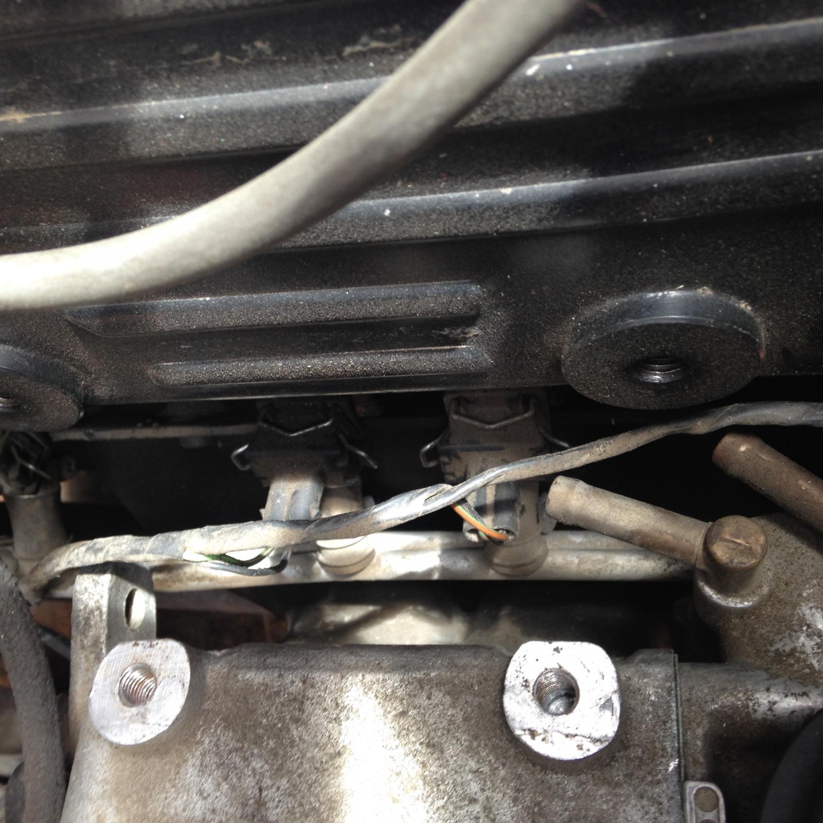

Way more information than my mind can wrap around with details (I've owned my Westy 2 weeks).
I'm chiming in b/c I found this Bosch RSU 906 258A (made in South Africa) device laying under my bench seat (88 Westy w/Tiico). I had no idea what it was (it was laying loose and unattached to anything except a wiring harness with huge connector). I was simply coming online to ask what it was.
I'm gathering that is the computer brain for the Tiico engine? And, it appears that it's an older version that's not doing the best job for my engine? Am I correct? If so, then what steps can I take to replace this unit?
Also -- my engine does tend to have a bit of trouble turning over to get started. Almost like the battery is low, but it's only 2 years old, so I don't "think" it's the battery.
Thanks from the Newbie!

PostPosted: Tue Jul 21, 2015 2:06 pm    Post subject: Re: New owner with original Bosch (I think) Reply with quote
If the part numbering is logical, you have the first release (the A) and they are now up to the fifth (or E), as noted above.
FASTT is proud to announce a fresh production run of the 2LR / Tiico 4 cylinder in-line conversion ECU's. Researched, developed, and produced by Bosch, South Africa in full collaboration with FASTT / FAS Inc. The RSU 906 258E designation ECU is the latest issued software package for the very successful in-line conversion program.
I would assume you have an intermediate (B, C, or D, if they exist) installed in place of that one.
No idea what I have or where to look but at least I have a picture now.

Why can't one run a higher octane gas to compensate for this? I can find 93 where i live and well i have to use that for my daily anyway.
I can't seem to justify to spend 400 for a new ECU another, 400 for the A2 fuel rail, 150 for the O2 sensor and modifying existing wireharness for the new O2 sensor or even spending more money on a new wire harness.

Just run Digifant II from a late model MkII Golf/Jetta

I have located a complete fuel rail setup from 2 different Jetta's and Golf's. Waiting to buy one of them and will be calling FAS about the ECU. So i will be in this for 5-600 bucks.

I gotta believe that there is a way to adjust mixture without changing ECU and injectors.
BTW; my Tiico (ECU code A) runs GREAT. Easy start, rock solid idle, etc.
Anyone????
