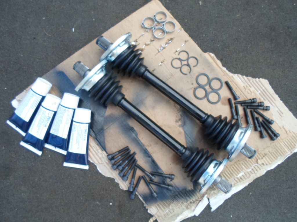

Maybe just new cv boots, cv's are tough, don't replace unless they "clunk". definite cleaning needed, though.

As for the CV's, what do you think? They aren't making noise now that i can tell, but these were in the back of the bus when i got it. I'm going to swap the boots for sure anyway. Maybe i'll just keep these on the shelf for a rainy day.

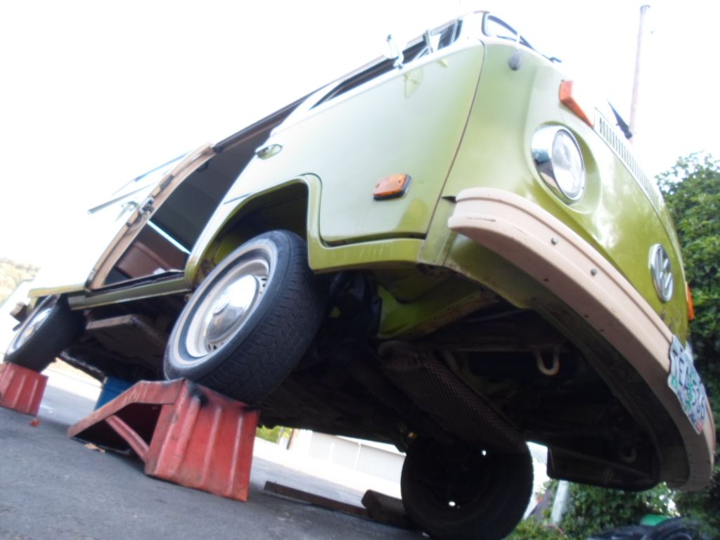

Cleaned up the under side of the engine today. I scraped the heater boxes & tin down with a razor blade then rubbed them down with some lacquer thinner & painted them.
Then i drove the bus up the ramps to run the gas all down to one side while i replaced the rest of the fuel lines.
Looks pretty good under the pedal cluster pan too!
And, one last pic before the the day is over.

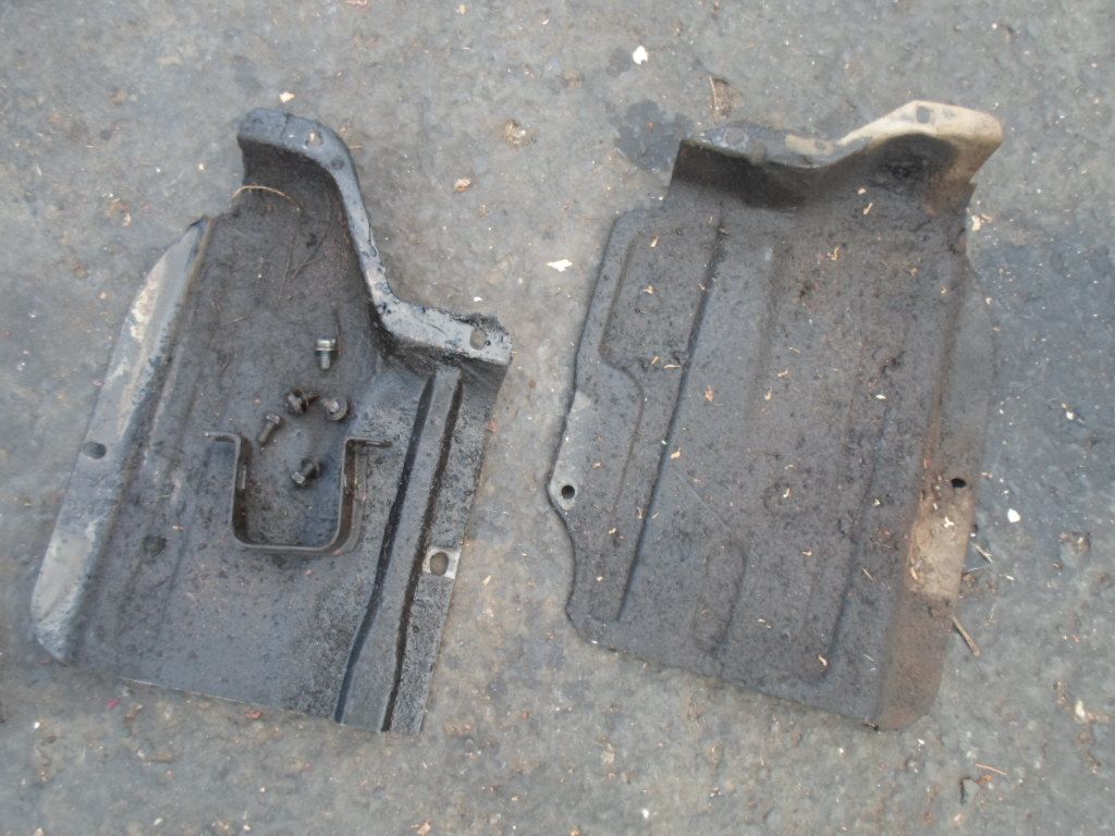

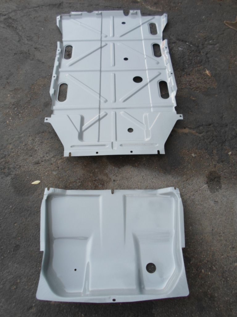

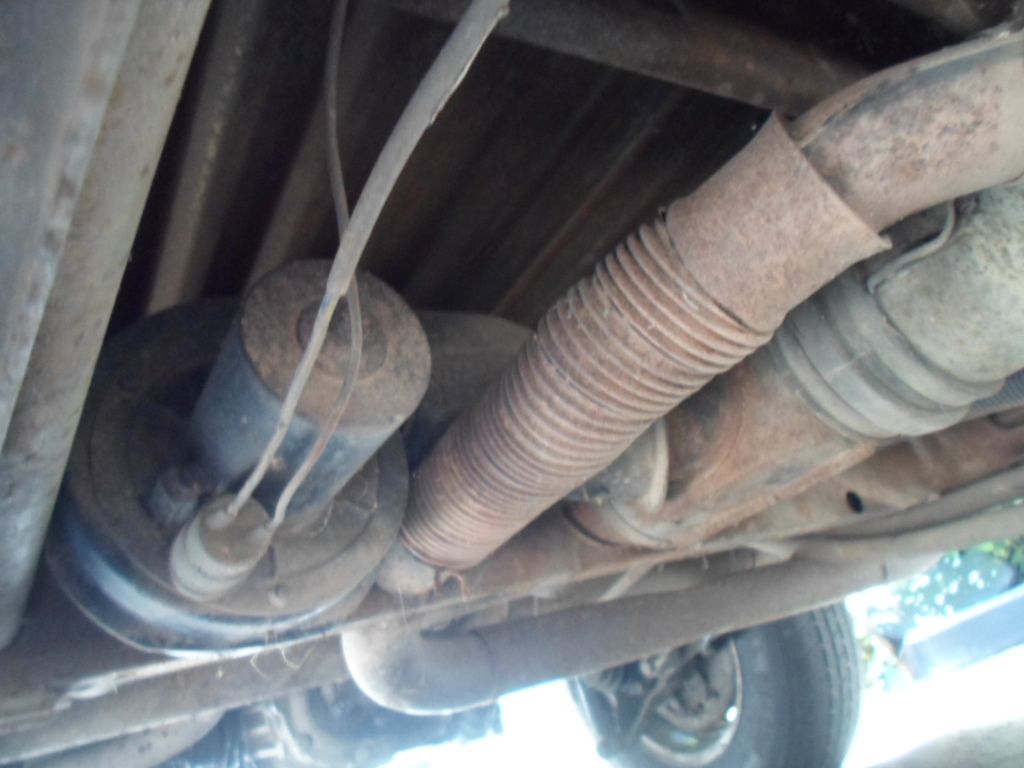

pulled the belly pan off today. Here are a few pics of the gas heater setup.
and here is the pan after i hosed it off

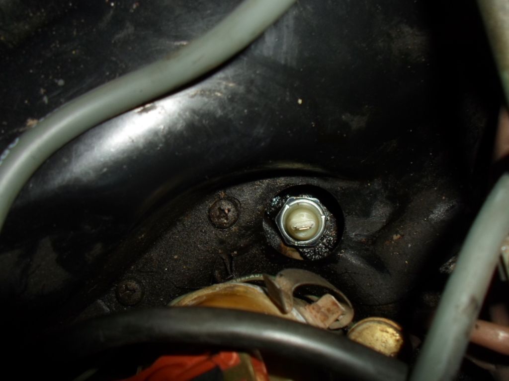

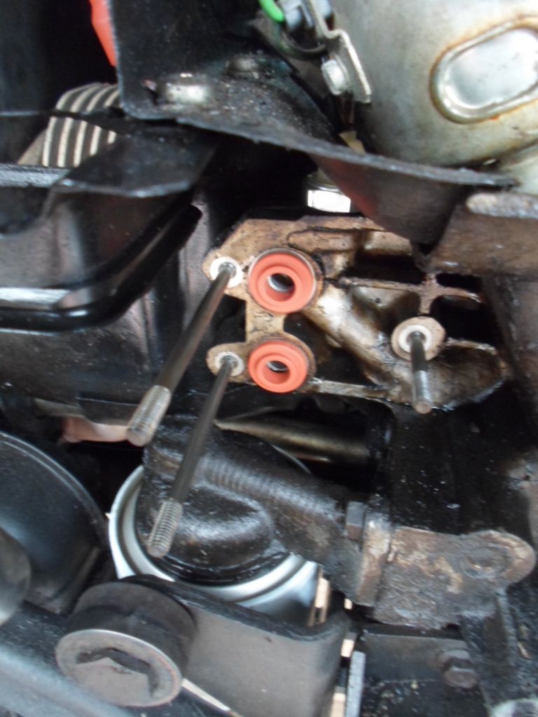

Replaced this oil soaked OPS, and was hoping that it was what was leaking, but i think oil cooler seals are next.
Then I put together my new CV boots. Ended up using my old CV's cause they were lookin' good & haven't been making noise.

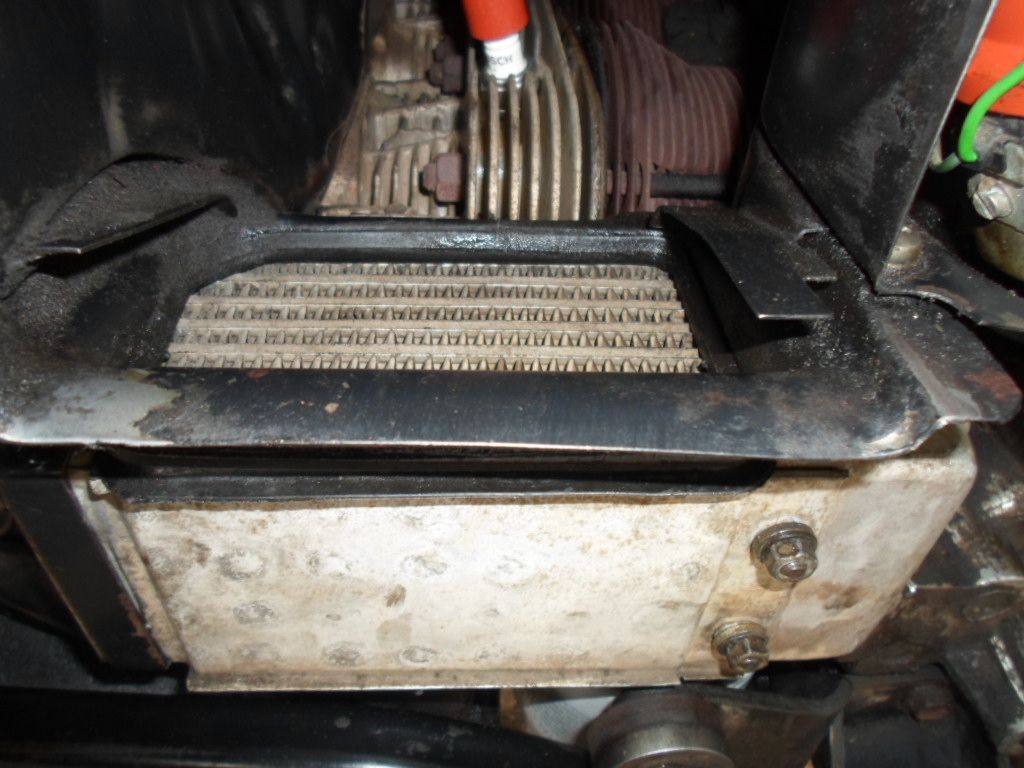

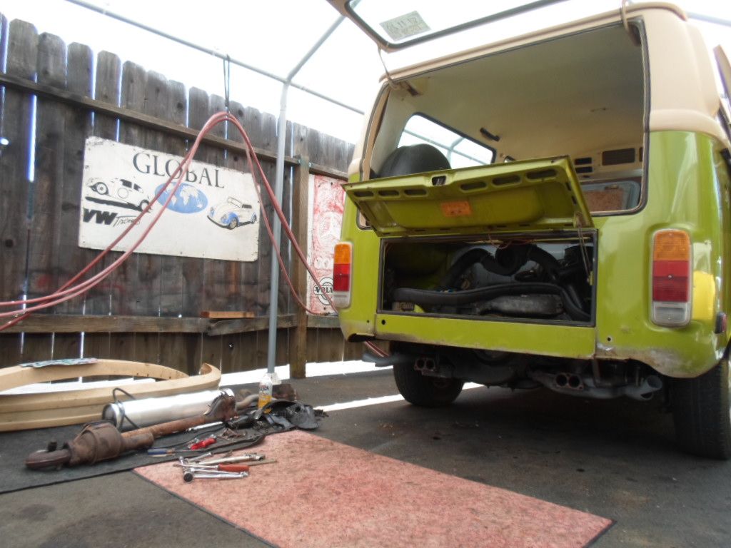

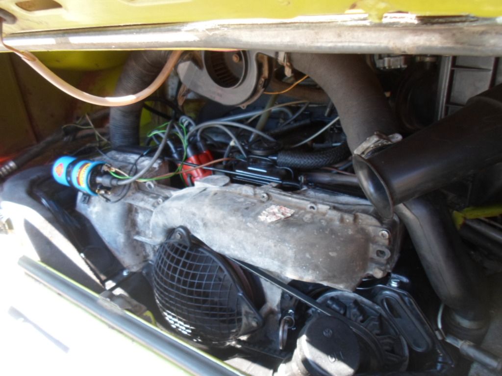

PostPosted: Thu Jul 11, 2013 4:03 pm    Post subject: Reply with quote

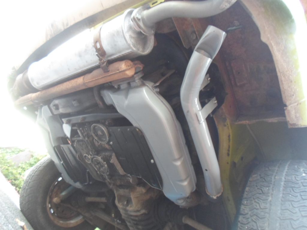

Tore the engine down a bit so i could replace the oil cooler seals & weld up the exhaust pipes (hacked out the CAT). I ended up putting it all back together minus the AC for now, but she sounds much better & doesn't leak oil anymore Very Happy

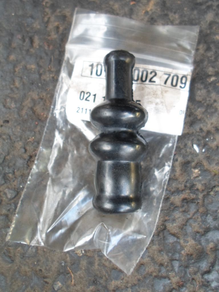

and while i was at it, replaced the old petrified dipstick boot with a new one

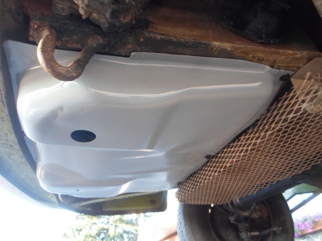

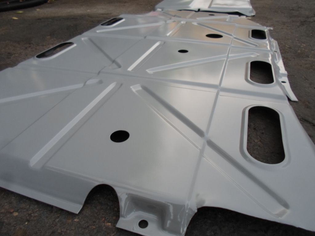

PostPosted: Tue Jul 16, 2013 7:56 pm    Post subject: BA6 Belly Pan Reply with quote
belly pans all sandblasted & painted Cool

PostPosted: Tue Jul 16, 2013 9:44 pm    Post subject: Reply with quote
Yeah, the bus is coming right along. My friend gets all the credit for the pans, he paints for a living & i'm known to leave runs in my paint Laughing I think he used epoxy primer & clear. They do look pretty sweet though huh!

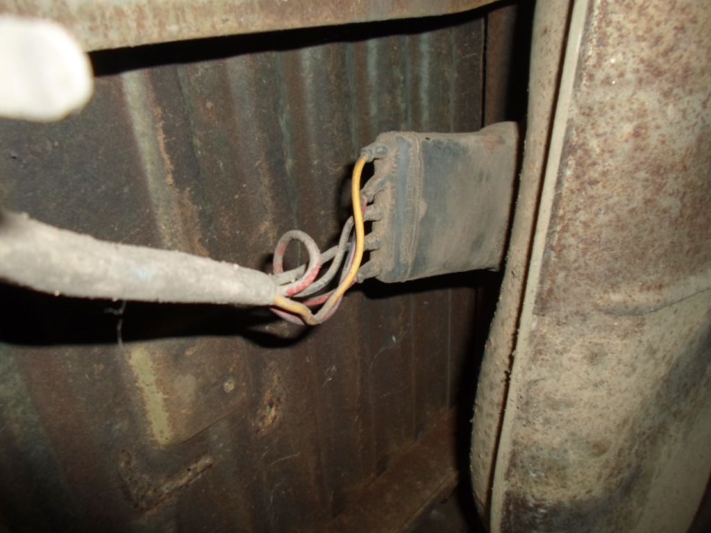

As for the BA6 i haven't done much. I pulled off the exhaust pipe from it & a buncha rust came out. Also found a tear in the rubber boot thingy right where the wires are sticking out of it. You can see in the right side of this pic
I think i'm going to just pop the whole thing out of there and try to make it run on the bench.

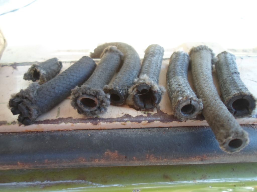

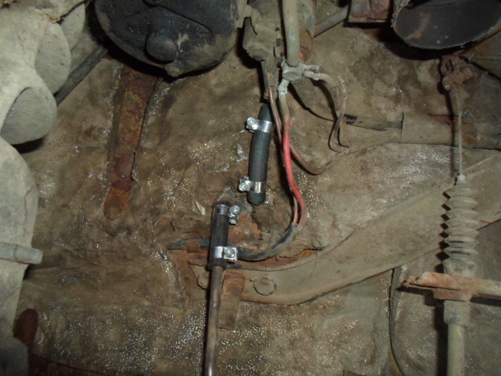

Decided to replace all these crispy old vacuum lines & in the process found a big leak in the tube going to the aux. air valve. The tube was like what i use on my fish pond pump & was barely zip tied on there.

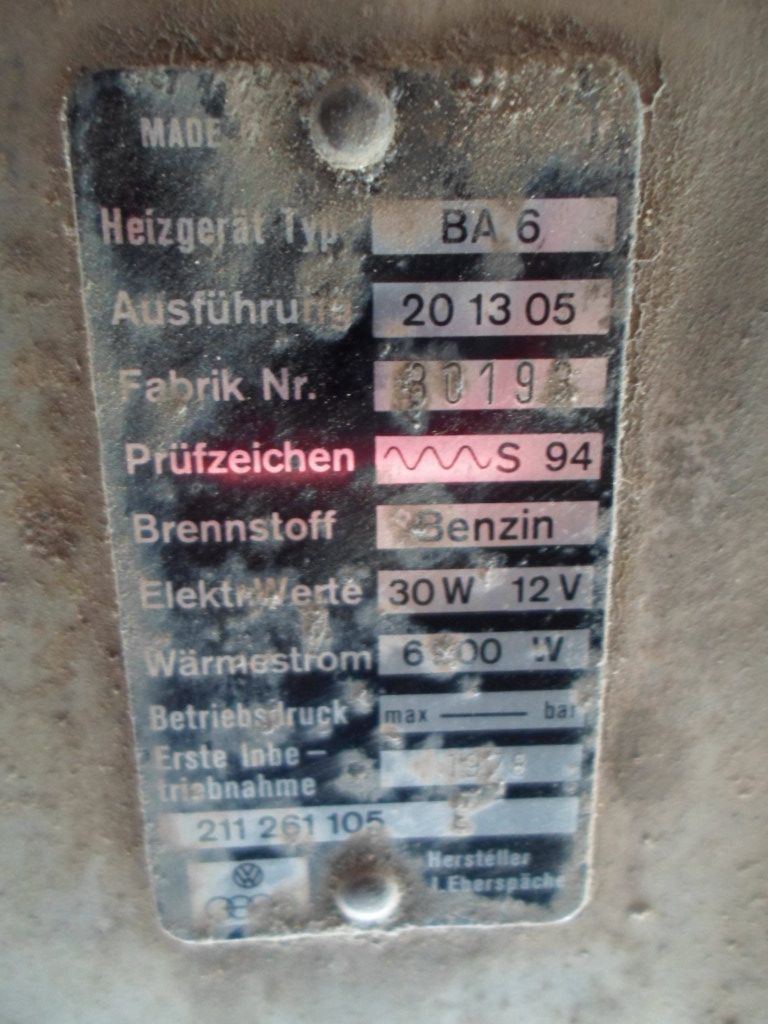

PostPosted: Wed Aug 07, 2013 6:56 pm    Post subject: Reply with quote

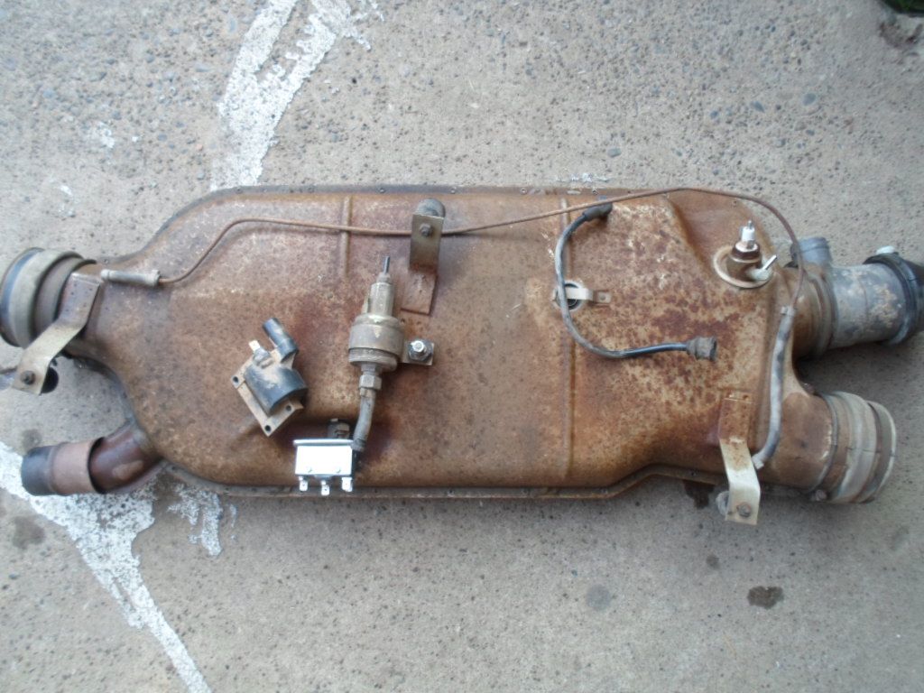

Pulled the gas heater, and i'm going to see if i can fire it up this week.

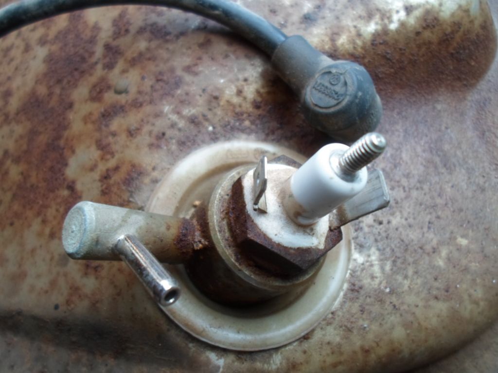

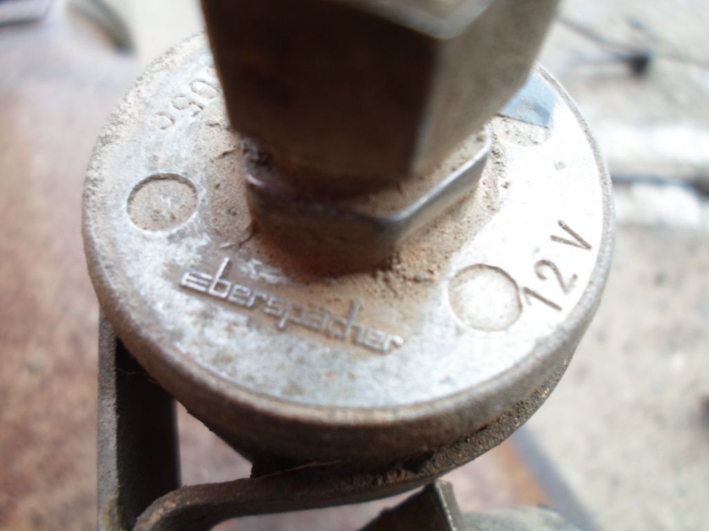

cool old eberspacher fuel pump

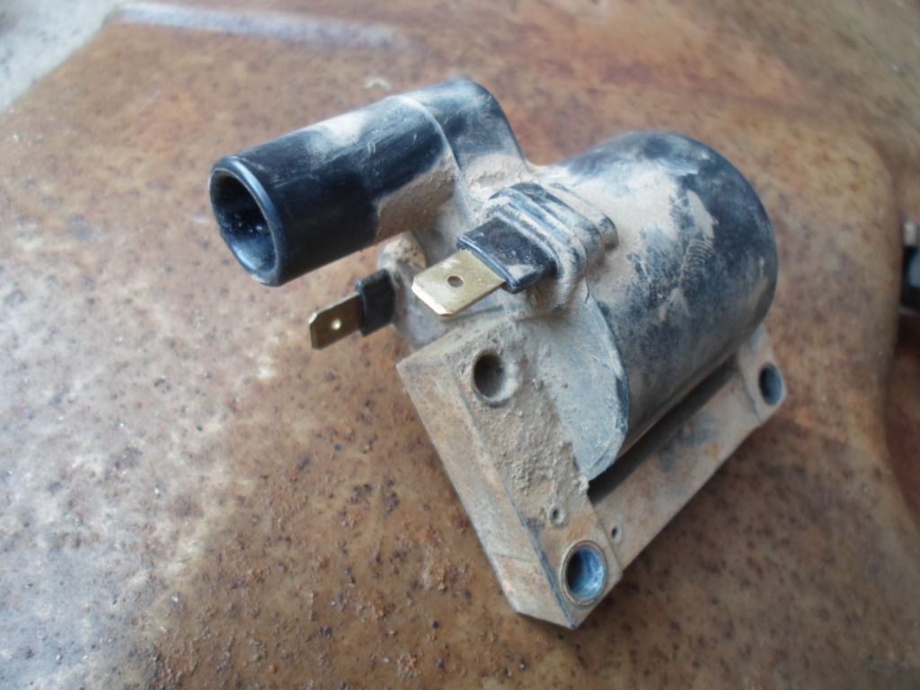

here is the ignition coil
and here is where fuel meets up with spark & makes fire hopefully Laughing

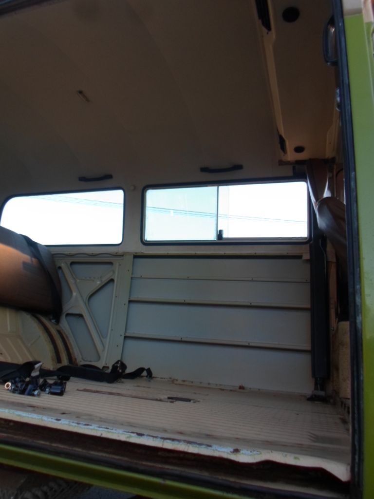

I also gutted the bus back out to clean it up some more

PostPosted: Thu Aug 15, 2013 2:45 pm    Post subject: GAS HEATER!!!! Reply with quote
Got the gas heater laying here. The fuel pump spits gas, i've got a bunch of wires & i was hoping to make a quick wiring harness so i can make it run. Do i need to remove the switch from the dash & all the wiring loom to hook this up proper, or does anyone have a simpler way to bench test them? I found some black & white wiring diagrams that are pretty hard to figure out.

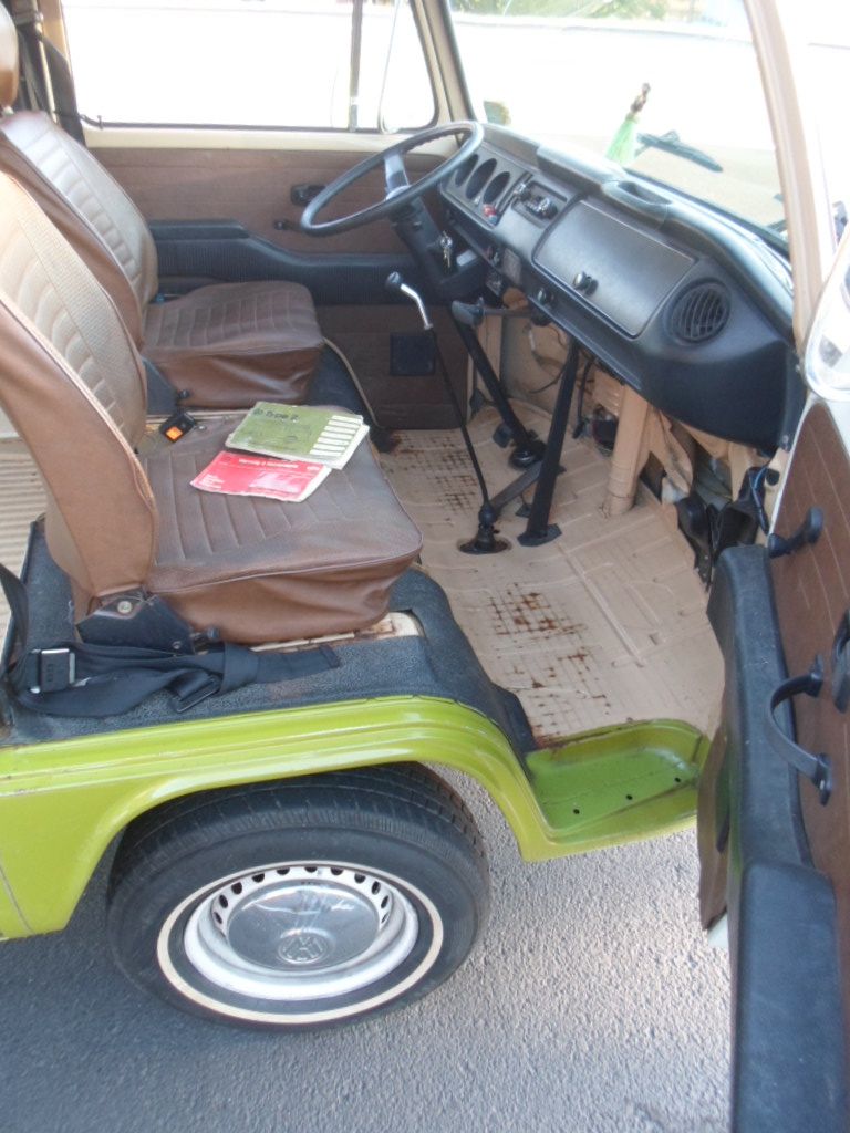

front pedal cluster pan back on, some more cleaning the under chassis, and the scrubbed the floors down
