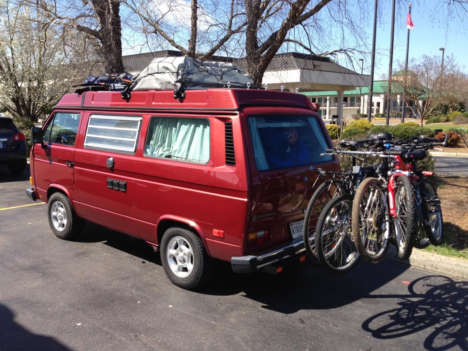

Looking at the pictures in the ad you would have noticed the hitch pin isn't reachable from above.
The description also states what they consider the hitch rated for. # is a standard symbol for pound. Blaming the vendor for spelling everything out and you not paying attention seems odd.
If you want something stronger it costs more because it has to be engineered to work with the factory bumper and attach to the frame or replace the bumper entirely.

Class 1 hitches aren't available with 2" receivers but class 3 are.
The issue isn't the hitch necessarily but how it mounts to the tow hooks not the frame. A frame mounted hitch that is integrated into the factory bumper like Burly makes is probably what you are looking for.
The full monty GW bumpers with integrated hitch still locate the hitch pin under the receiver not out front where it sounds like you expect it to be.
tam_shops wrote:
But, given that OP, thought he could put (what was it 6,000lb motorcycle?) on a hitch back there, no longer just makes me the inexperienced dumb one and suggests there is a bit more at play than me (alone) not doing her homework before buying something.
Motorcycles only weigh a few hundred pounds, your van doesn't even weight 6,000 lb. With a hitch advertised to class 1 tongue weight rating it would easily be over the load rating. People warned against it and offered different options for the OP that would have also fit your needs.
I have seen GW hitches with racks and a family load of bikes many times running around town and on the freeways without problems. If it really is a issue for you sell it now while it still looks new and buy something else that you will be happy with. Idea

What you have observed is exactly why the major towing/trailer vendors do NOT sell a hitch assembly for the Vanagon that has a class 3 style 2"
When I went looking for a receiver hitch for my Vanagon 10 yrs ago. GW was the only option.
Years later, Burley announced his product and I was first or second in line to get his frame mount setup. (thread linked on page 1 of this thread)
In that thread I show the differences,
It easy to miss this information on this site, due to the traffic. But the info is out there.
As it turns out there ARE other options, albeit.. some are hard to find options.
The primary reason no major vendor sells Class 3 hitches for the Vanagon in North America is due to the fact that the Vanagon could not safely be consider a Class 3 tow vehicle by US standards. The van is underbraked.. and it is underpowered for Class 3 ratings.
The problem is compounded since many MANY accessories (not rated Class 3) come with 2" receiver fittings.. And now the majority of US car owners just assume that "standard" is 2".. seemingly oblivious to the technical history of Class, 1, 2, 3 etc... ( I was oblivious to much of that stuff, too.. until I started towing bigger weights, then I researched)
I feel for you.. getting caught up in that evolving problem.. but to blame a vendor like GW is not entirely fair.
GW certainly uses marketing in their selling.. most everyone does.. but it is pretty clear to me that they say no more than 100lbs tongue weight on that thing.
FWIW. I exceeded 100lbs by a lot when I used my GW hitch.. like 2.5x.. and lived to tell the tale.. but as you have discovered it is not the best solution for larger tongue weights.
I sold my GW hitch for about half what I paid after several yrs of use. New owner knows its limitations but is pretty happy with it for his needs.
In the end, the GW hitch served its purpose for me, I used the money towards a better hitch (which is not "perfect" either).
That's an option for you.
If I am you, I would want to see the integrated bumper/hitch in person before plunking down any more cash. Don't take someone's word for it. Look for yourself... factoring in what you have learned and make an educated decision.
And in the future, read GW's catalog text with that hard-learned filter.
Their descriptions trend towards a J Peterman catalogue...

Thanks so much for explaining all that to me! I've already learned more than I should ever need to know about hitches. Didn't even know there were classes when I bought this one, actually didn't discover it until after I bought this one, since I (my fault) ignored that class towing stuff since I never plan on towing anything. Bought the Vanagon b/c I did not want to tow anything! LOL
And, again, love and appreciate gowesty and the time, energy, effort and money they put into developing products for us to buy/use/have on our Vanagons. And, if this was just a continuation of the only hitch available for years to come, I'll even withdraw my complaints about it. It meets *my* needs and will for years. I won't withdraw my dissatisfaction w/ the ad, only b/c I'm not the only one that didn't *get* you should put a 100lb bike rack back there--I got the 1,000lb towing part. But, now that I get it, totally take responsibility for duh and the fact that I probably should have asked and/or figured it out! Embarassed
Will with out a doubt do a TON of research on bumpers before I buy one. A ton I tell you, tons! Seeing it IRL for starters, then asking about what I can put on it and safety factor for vehicle--main reason I want one...It's actually part of the reason I opted to just get the hitch now and wait for bumpers. More than one person PM'd me and told me to make sure I saw them IRL before buying one, as they didn't like this one or that. And, I've yet to see anything but the tube ones, despite belonging to 2 different local VW groups and having a repair guy down the street! I had decided on the gowesty one, but am now leaning towards that Rocky Mountain Westy one, might want to put the bike rack on the front and the propane, fuel, water and a bunch of other stuff back there...

I'm not the only one that didn't *get* you should put a 100lb bike rack back there--]
You're definately not the only one. My bike weights about 28 lbs and my wife's is probably close to the same. So 60 lbs of bikes on a Yakima "Hold Up" rack. That rack probably weighs 50-60 lbs so I'm just a tad over the tongue wieght for that hitch.
It's worked fine and I primarily plan to switch to a frame mounted reciever (probably Burley) to regain clearance. But pushing the rating envelope is always in back of my mind too and is making me want to swap recievers sooner rather than later. Of course I just blew so much money on my new mtn bike that I can't afford to...
In the end, the GW hitch served its purpose for me, I used the money towards a better hitch (which is not "perfect" either)..
Following Jim's steps, I did the same two months ago and put the money from the old GW trailer hitch towards the purchase of a Burley hitch for fiberglass bumpers. I still need to find time and energy to install the new trailer hitch.
