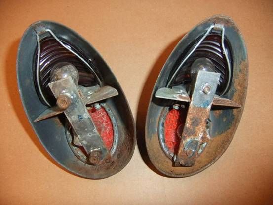

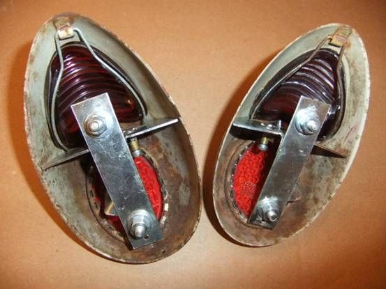

| Anybody have a photo of what a stock/typical flat lens looks like from the inside? I am working on this again, but am getting frustrated with the lens I have. It obliterates the LED light during pass through, the lens just seems too diffused to really do a great job with these lights. If I can get this resolved, there is a very good chance that I will have lights available in the very near future. Not a ton, but a couple dozen sets to start, any voltage, heart lights included. |

Here are a few i have taken off the samba.com
I hope these may help. I would like some 6 volt ones when they are ready. Will try them in the UK  |

| Thanks! I did some searching as well. So far I've seen a few with diffusers and a few without. Are they still in most lights out there, or have they mostly disintegrated and been removed? I notice that the aftermarket lenses don't have them. |
