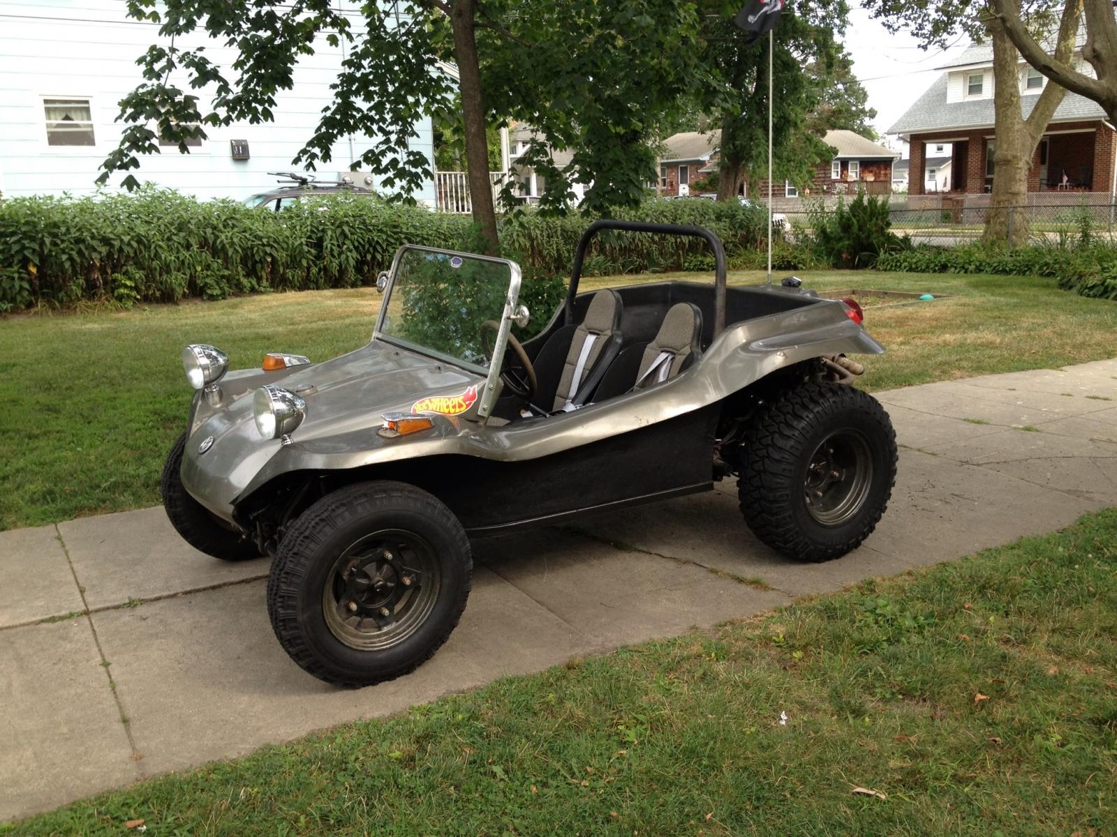

I have had my buggy almost 15 years, but It's been 9 years since I blew it up in college... And 2 days ago I finally drove it again! I had a build thread goin over the winter while building the chassis t my friends, but my business is seasonal, so it sat behind my house all spring untill I realized it was the middle of July and I went into overdrive and slapped it all together over the last 3 weeks.
I don't have a garage, so after getting it rolling in my buddies shop, I did most of the assembly, wiring, etc on dirt in a crappy tent in my back yard. It sucked, to many Mosquitos, definettly a labor of love but it was worth it!!!!
It's dirty, 13yr old scratched up paint, but I am so cool with how it is. If I paint it then it will need nicer wheels, new windshield frame,pay to store it inside, etc, etc, we all know how that goes. Funk that, I will just rock a pirate flag for now;)

Tube chassis from David Barrett
Thing 181 front end, adjusters, new ball joints, tie rod ends, delrin bushings
Thing rear arms, axles, brakes
Center rear torsion adjuster
Hurst shifter
Rebel wiring harness
Beard Seats
Stock 1600 block
019 by Glenn

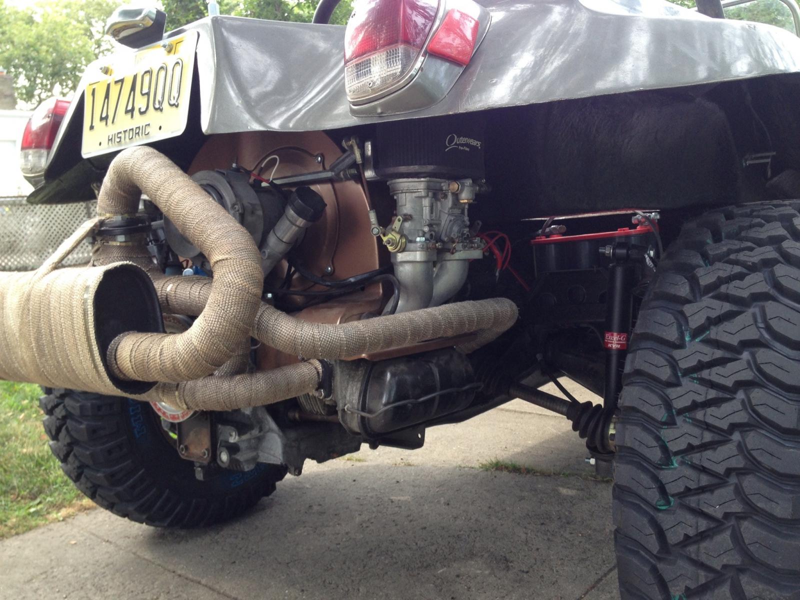

Weber 40 idf's
Tri-mill bobtail exhaust with lots of exhaust wrap
Mickey Thompson E78 Mini Mags up front
Mickey Thompson Baja MTZ 31 x 10.5 rear

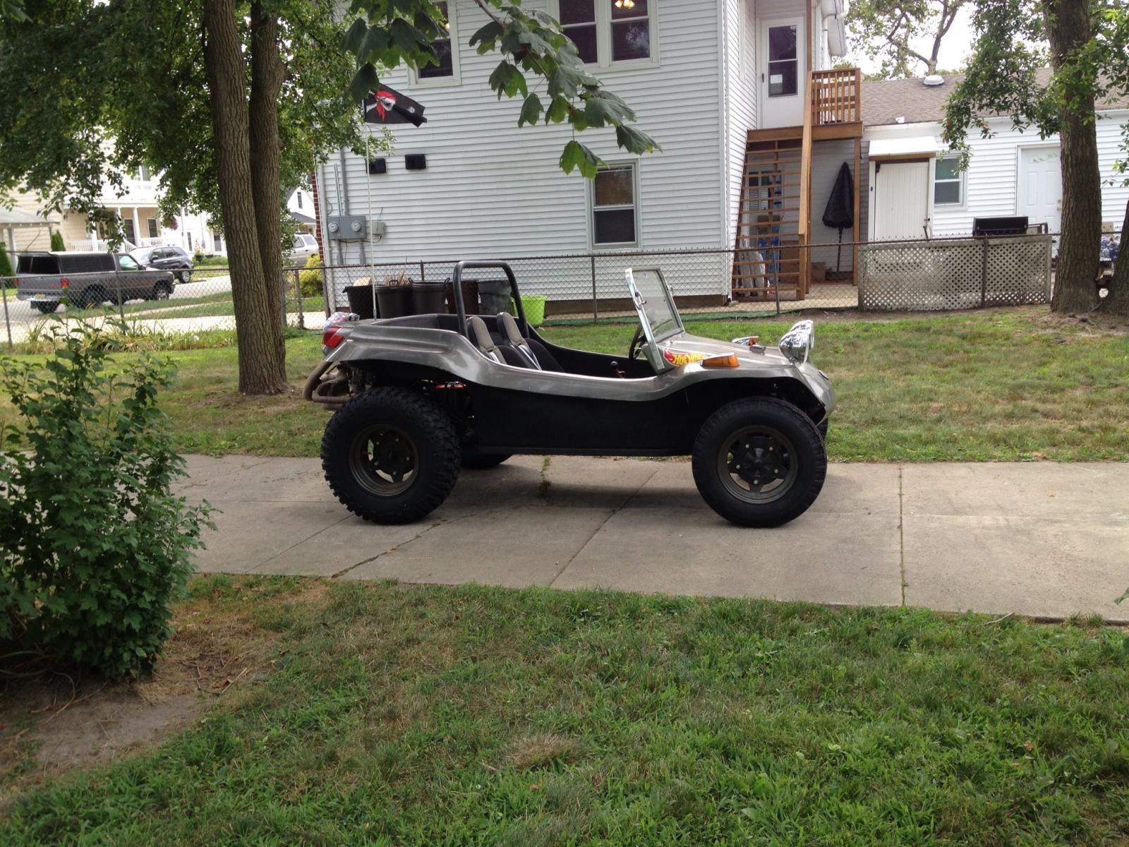

Don't know why back looks crooked in that pic, it sits level, unlike that old concrete driveway I guess.

So the bad, it still needs to be tuned better.. ( you'll have that with 40's on a stock engine Wink ). And I have a bad fuel smell now that I put 3/4 tank in. Thinking its gotta be the relocated fuel filler neck, I checked for leaks everywhere and I did not use any seam sealer on the welds. Hopefully just some pinholes, gonna POR Patch the welds on the tank and hope that fixes it.

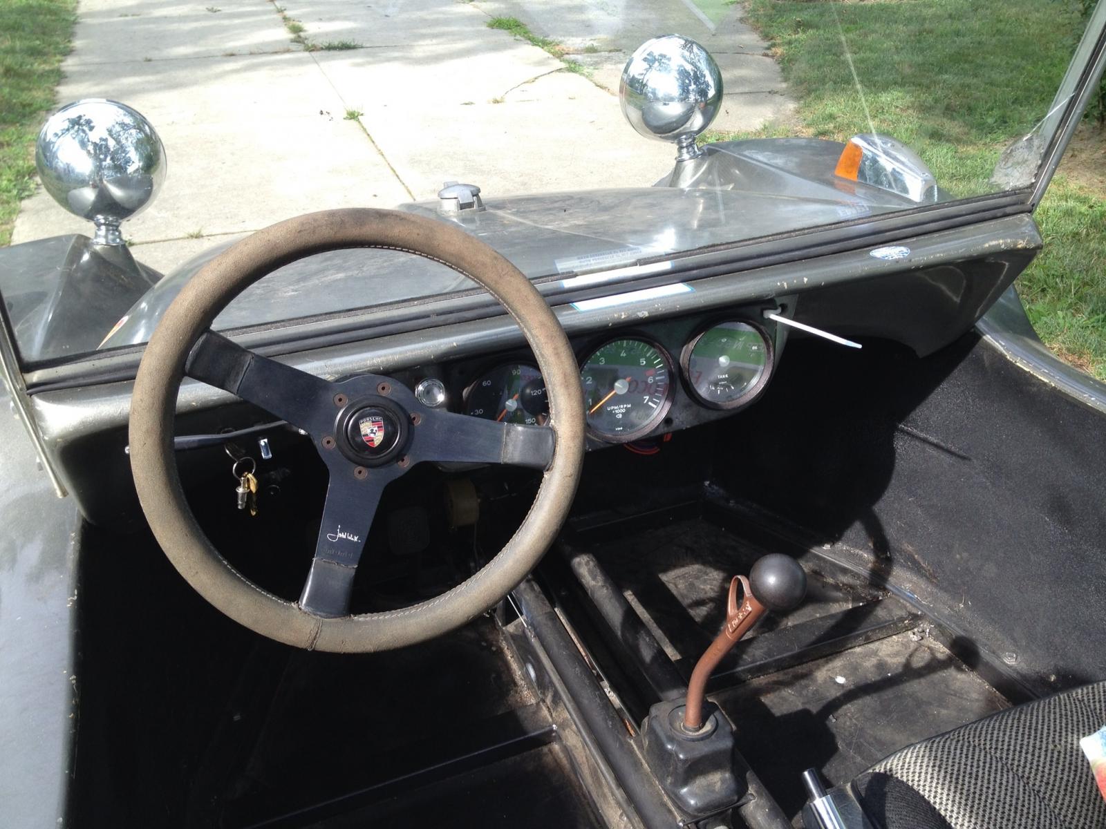

Very nice, I really like that. You didn't mention the 914 instrument panel.
Some baby powder sprinkled over the tank might help find the leaks and make it smell better.

Are the 914 instruments hooked up? How accurate is the speedometer? The gas gage?
Just wondering as I intend to use them myself.
