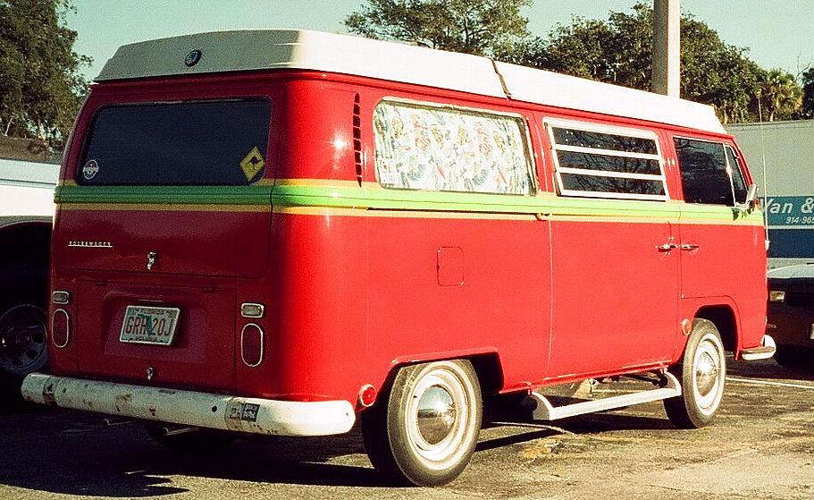

is that better for a topic? anyway, my bus has no heater boxes, rusted off or whatever and even though im in florida(no haters please) it still gets quite chilly here in north/central.
i dont want to spend $300+ on a set of heat exchangers so i was thinking of making my own. im good at fabricating and i thought of making a sort of heat muff like we use on airplanes for cadin heat. any threads on this?

I could be wrong but from your photo it looks like you have an early bay - of course since you don't list what you have we must guess. If it is an early bay then I think, and someone can correct me, that you can use a set of late bug heat exchangers with a small kit that modifies them. If so they only sell for about $40 a set. If you have a 1972 bay with a pancake engine then you need to know that a good part of your head cooling comes from the heat exchangers which when not working will cause head overheating - which in turn will cost a whole lot more than $300 to fix when you drop a valve seat or worse, a valve.

In this photo it looks like it a 68-71 with a bug engine! https://www.thesamba.com/vw/gallery/pix/1136903.jpg

sorry dan, thats a pict of my old 69. im refering to my 78 that has a 72 motor in it.
yeah, sorry, its for my 78 champagne with a 72 motor.
