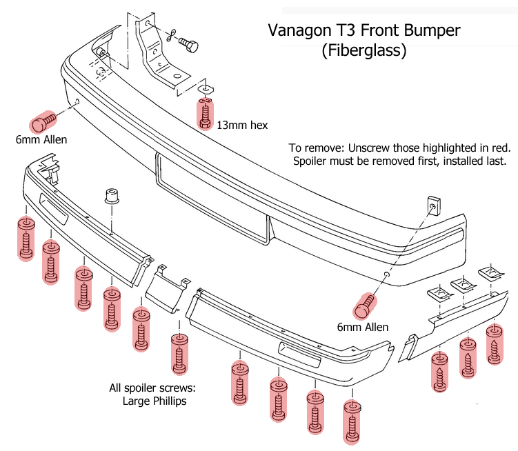

Also a parts drawing to help understand the assembly.....

Since 7zap is down, and it irritates me that VW's diagram is missing the two bracket bolts, I've done some illustration updating:
