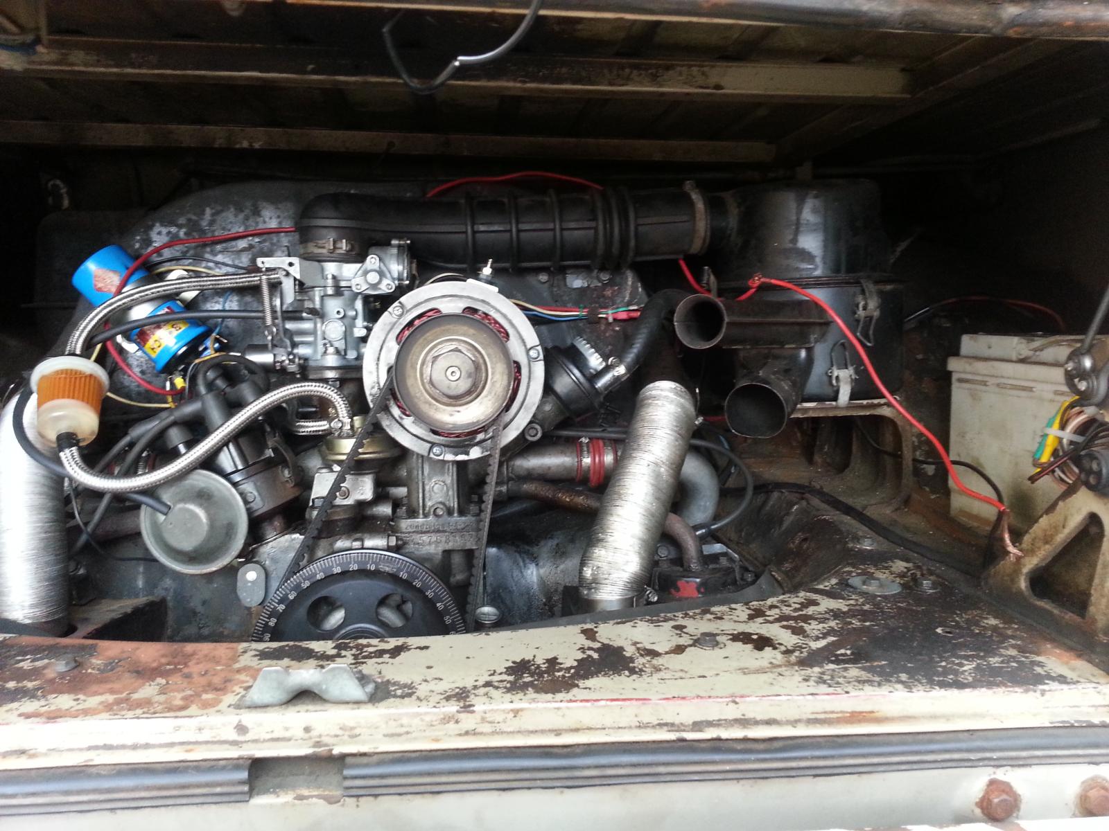

While working on a major clusterf*ck of wiring that left me stranded on the side of the road yesterday, I realized my day-to-day driving experiences might be different than most motorists. This became even more evident as my friend and I were entertaining the seemingly subjective term "reliable vehicle". - Intimidating to some, entertaining to me. - My daily driver and only form of motored transport is a 68' right hand drive Devon camper I scored from the thesamba classifieds about two years ago. From what I've gathered through research, there are only a small handful of Devons in the US, none I've found other than my own are RHD or a first year bay window - maybe someone reading this post could tell me different?
Under the assumption my adventures may be compelling to others, let me introduce my vehicle. Mostly all original with exception of the engine. It had a 1600dp which was having issues, I replaced it with a 1500sp I built from spare parts I had lying around and yes, it has plenty of power for every day driving. The engine now wears a 40hp Big Cap cast iron vacuum advanced only distributor in place of the 034 in the photo.

I would suggest you move the filter out of the engine compartment or at least put the filter before the pump not after it. The fuel line and plug wire zipped together is scary as well...

Looking good! I use my 68' and my daily driver too. I've clocked 11,000 miles in the past 12 months. I agree that our day-to-day driving experiences are a lot different then most motorists. Sucks for them that they don't get to enjoy a bus on a daily basis. I though you were gonna live in this bus and make stuff out of it. I can't remember if it was some sort of vegan food or something like soap. Did that dream ever come true?
I agree with moving the fuel filter from its current location to before the pump. I don't mind it in the engine bay, I've heard "rumors " that there is a chance of vapor lock if installed on the other side of the fire wall. Nothing I've experienced but something I've heard.

I did have the filter over the trans but I was having what seemed to be vapor lock issues. I've got a hard line which runs right under the coil and putting a filter there is far more dangerous, but I hear you, I didn't feel good about putting it their either - I AM however replacing it with a glass filter and some new solid lines. The ziptie on the spark plug wire was just temporary while I was working on a few things, it was never run with it.

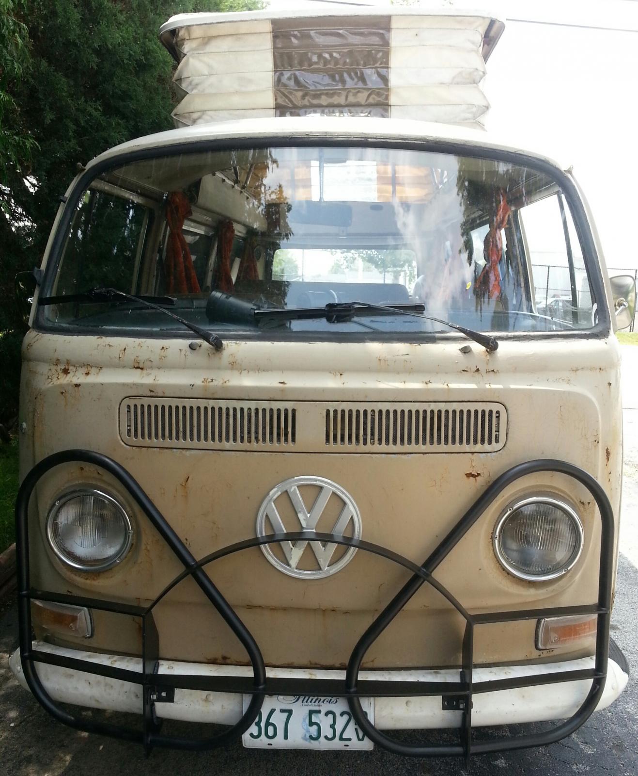

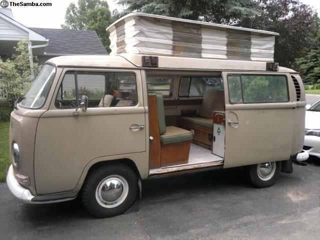

Hey, nice looking westy in the one picture. BTW I have a filter in front of the firewall and never had an issue. I would keep that bus complete with the original interior since it's so unique and in that nice original condition. Not sure if you're still trying to sell it. My bus is not a true daily driver but damn near. At least during the nicer seasons. It's my first choice for running errands.

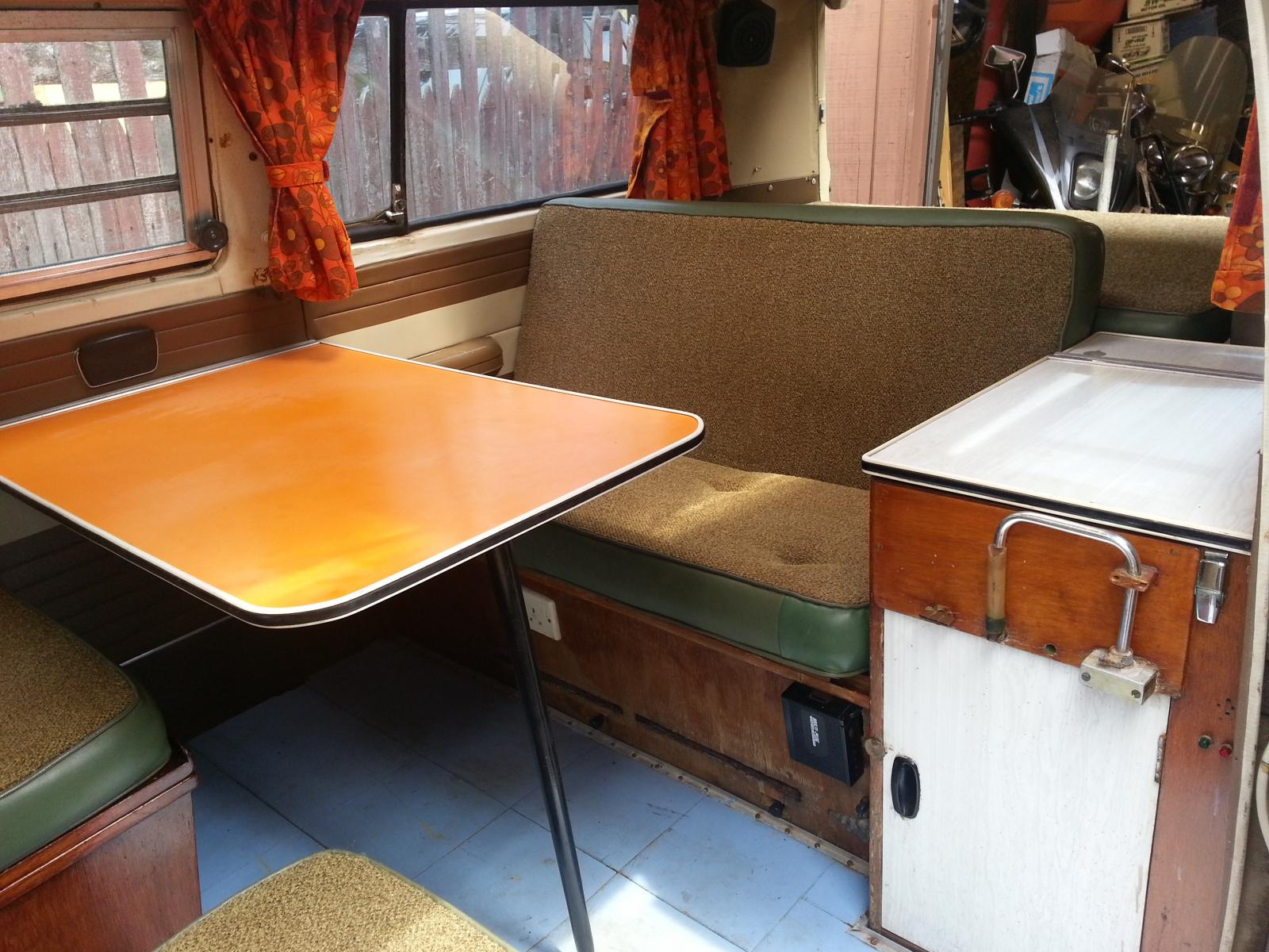

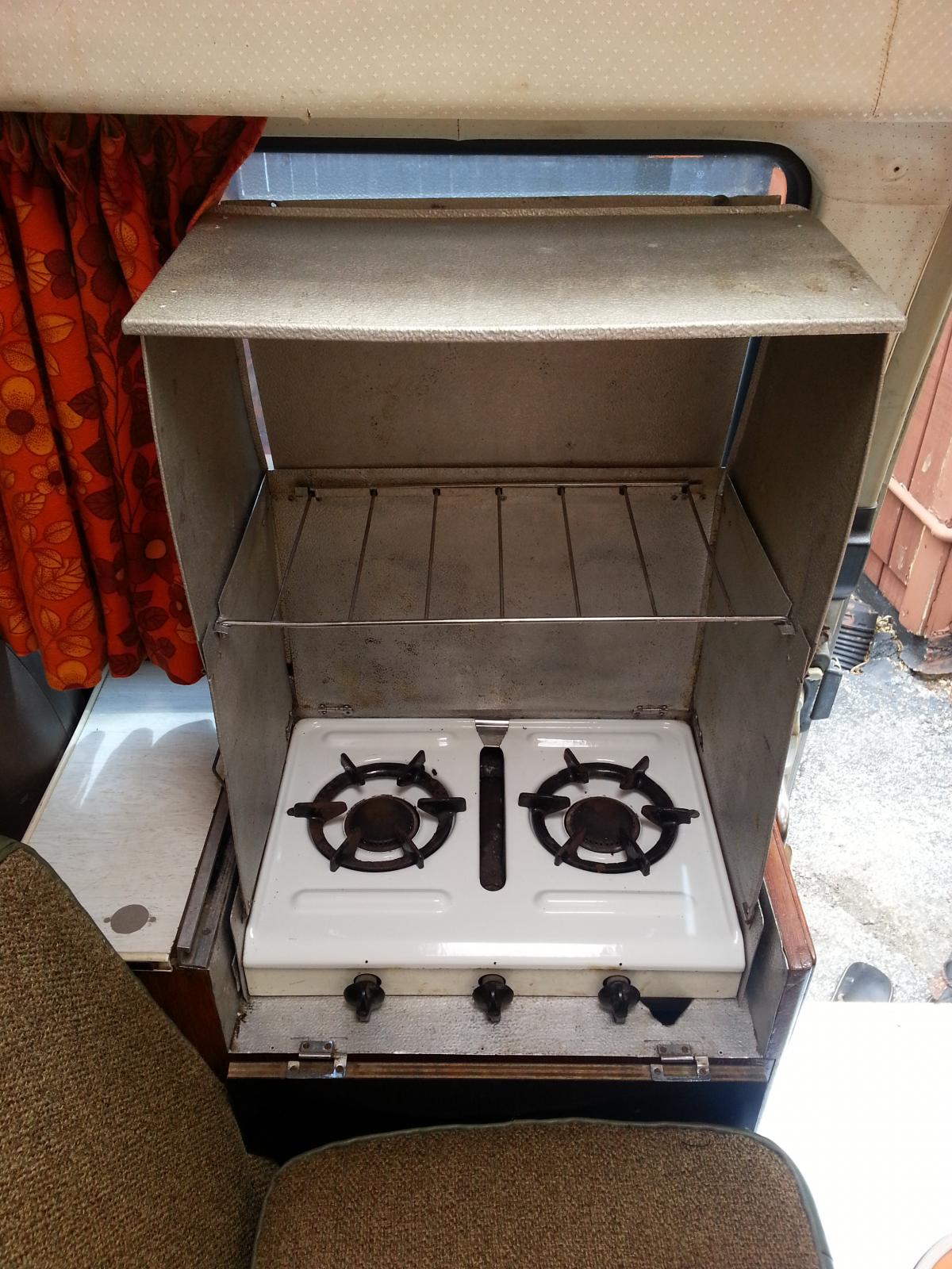

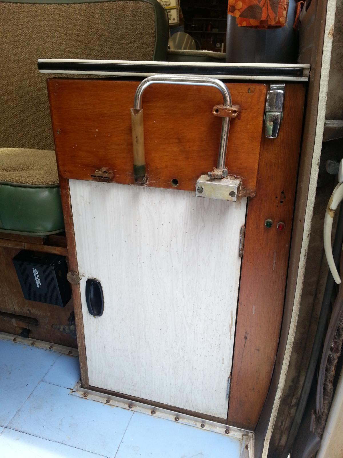

What's the spigot for in the bottom right of this pic?
Nice bus.
-dasdachshund

That IS a nice looking Westy in that picture Dave, what year is it again? (For everyone following, the gorgeous and mostly original white Westy parked next to my Devon in one of the photos used to be a chicken coop!) I see your bus parked around town quite often, I'd say you're more of a daily driver than most. You should make a post about that crazy trip you took a couple of years ago with your family! We missed you at the Fun Fest this year.
dasdachshund, the spigot I believe is for the two burner propane stove on top of the cabinet. The bus doesn't have a tank and I've never used the stove so I never really payed much attention to it. You can see a portion of it in this photo...

My Westy is a '71 tourist delivery so it spent some time in Europe before coming home. I found a mint 1971 Greek drachma coin under the sub-floor when I gutted it for cleaning. It was stored in a chicken coop for 15 years so it was full of mice and birds.
I was planning on going to funfest but the wife had surgery the Thursday before so that was a no go. We have plans to do other shows/ swaps. I'll keep you posted so you can cruise along with us. Can't wait to check out that bus in person to see the differences from a U.S. version.

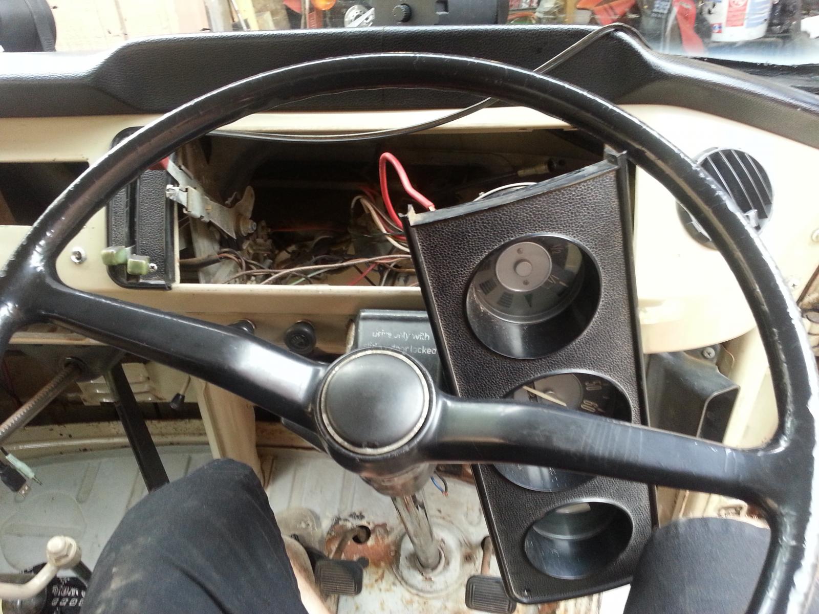

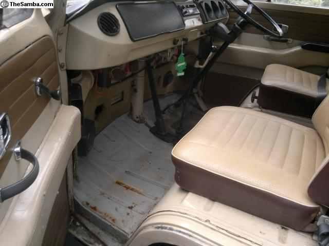

Now, for the issue that inspired me to make this topic... get ready to cringe.
I had just put a new carb on in the morning before work, took it for a test drive and the bus ended up shutting down. Immediately I assumed something with the new carb, but then the dashboard started smoking. I turned off the ignition, pushed the bus to a side street and tried to start it to no avail. It sounded like the starter was spinning but the solenoid was not engaging. I then (incorrectly) determined it must have been a couple of loose power connections from an aftermarket relay grounding on the headlight bucket. I tightened them up and she started! I must have moved some other wires around in the process because this certainly did not fix the problem but I made it to work shortly after.
As I was leaving work later in the night, I had a repeat performance from earlier in the day. I was pulling out of the parking lot, the bus shut down and dashboard started to smoke. I unbolted the steering wheel, examined the damage and realized one of the wires from the ignition pigtail was toast - This ended up being the power wire to the coil. This was too much of an issue to deal with at 11:30 at night so I pushed the bus into a parking space and walked home with my tail between my legs, luckily I live about a mile away.
After seeing the damage, I made the determination I needed to hot wire the bus to get it back in my driveway... here's where it gets hairy. I had power to the starter up front still but needed power to the coil, again, keep in mind this was a mile drive. Two fire extinguishers ready to go. Pay attention to the big red wire which was attached to the battery(everything was tied away from metal during the drive).
One of the previous owners must have had limited wiring experience, in the state I purchased it in, the wiring got me 40k+ miles so far but when I looked behind the cluster I realized how lucky I've been.
I pulled out at least half a dozen wires directly connected to power at the fuse box, dangling and at the very most, taped on the ends... very old and dry tape.
I spent a day straightening the wiring out, bypassing the original ignition switch then improvising with a series of hardware store switches. Now I start my bus like a rocket ship, it's pretty damned cool actually...

Not sure it's the same. But I have a used but working ignition switch with the housing and og key.
I believe the 68' is a one year only switch, might be wrong though. I actually like the switch system I've got now, I might find some more aesthetically appealing switches but I dig it.

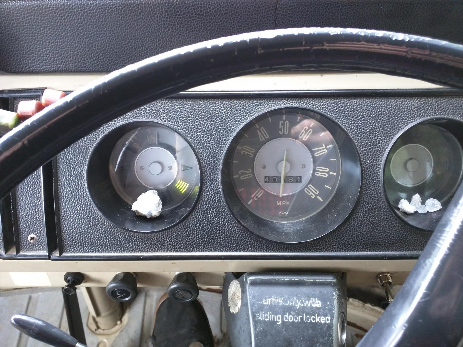

My speedo was angry. It started growling at me. Then screaming. And then it did a 360. Time for a rebuild.

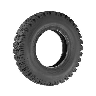

I'm sure I'll catch slack on this, but I'm in the process of getting new tires now - I took the tire with the broken cord and moved it to the rear then ordered a Chinese tie rod from Autozone which tightened up the front tremendously.
I currently have two STA Super Traxion tires on my bench and I just paid for a set of period correct 14x5" wheels which will be sent off to be powder coated. The Traxions will be my spare/off road rear tires and I'll be putting Firestone 750s bias plys all around. I am determined to make 30mpg+ in this bus and narrow tires will help.
Super Traxion:
Firestone 750:
