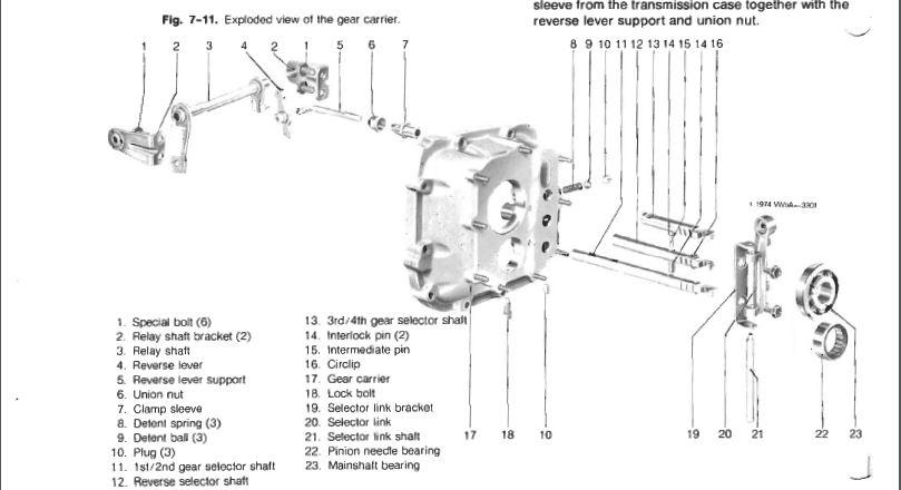

PostPosted: Mon Jun 09, 2014 4:28 pm    Post subject: Shifter Parts ID Reply with quote
Take a look at this. What parts are you talking about?
Shifter Parts ID

I got the bracket and the steel ball and new seal for the hockey stick. In the bentley book the picture shows the selector shaft with the small end up. I installed the bracket so the pin will have the small end down so it wont fall out. Is this correct? Thx...Larry

PostPosted: Fri Jun 20, 2014 6:29 am    Post subject: Reply with quote
Is this correct?
All the diagrams show it with the small end up. What retains the intermediate shift lever shaft. What am I missing here. Note that the shaft with the springs has two snap rings to retain the shaft and the other one has none. Does the nose cone when installed retain the shaft?

PostPosted: Fri Jun 20, 2014 5:15 pm    Post subject: shift rod link Reply with quote
Larry, Yes small end up for the shift lever shaft into the bracket.
You need to know that you set your trans bell housing down on the floor
to install. and the inside of the nose cone keeps the shaft from coming out.
Tcash. the snap rings separate the 2 springs. These were installed to provide a smoother shift feel.

PostPosted: Fri Jun 20, 2014 5:18 pm    Post subject: 1977 riveria..3rd gear only Reply with quote
Thx for the ratwell pictures. Our transmission did not have a stop bracket,snaprings and springs. The shaft is smooth with no groves for snap rings. I just looked in my bentley book and it does not show the springs or stop bracket. Going to call Long Ent..... thx everyone...Larry.

PostPosted: Sat Jun 21, 2014 7:27 am    Post subject: Reply with quote
Thanks DKP.
Larry, I don't know what year, but the stop plate and springs where a design change. Your transmission may not of had them.
You will need your trans letters and numbers before you call Long.
