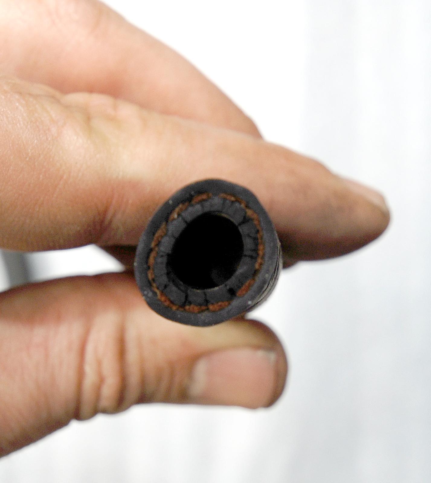

After all my research I had settled on using 5/16” PolyArmour fuel line, coated steel for easy bending, no kinking, and rust prevention, and, of course, METAL. Doing it every five years in an age where there WAS bendable metal fuel line made no sense to me. Metal lines cool the fuel, which is a good thing, they resist abrasion and UV, and I called my local radio car show (a good one) airing my anxieties, and having them swatted down. An MP3 of that conversation is on the Samba, in fact, HERE:
http://www.thesamba.com/vw/forum/viewtopic.php?p=6597704&highlight=seyfer#6597704
The important thing, they and others said, was to use rubber junctions over metric bubble flares to dampen vibration.
Here’s where you go to learn more about PolyArmour, made by the AGS Company, for whom I do not work and from whom I received nothing:
http://www.agscompany.com/faq/10
It’s marvelous stuff. I bought 25’ of 5/16” from Advance Auto, and another 6 feet of 3/8”, which I thought I’d need and didn’t—for gas. From CarQuest I bought about 20 feet of 5/8” Gates Barricade, the best quality hose Gates makes, definitely the ‘fuel injection grade.’ Ordered after helpful correspondence my clamps from Ultimate Garage, a 50 pack of #15 and another ten #17’s in case the #15s proved too small. They were just right, particularly when combined with a 5mm nut driver that suddenly vindicated decades’ worth of residency in my tool chest.

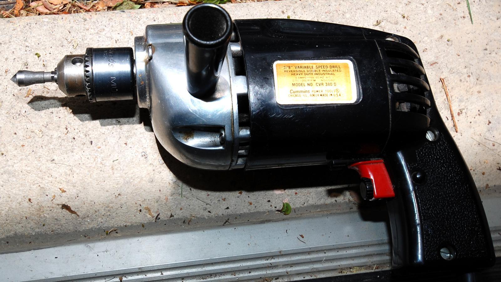

All the while, as you can find from my posts, I was measuring, checking my plans—screwing myself up for the job as the winter dragged on. I did some experiments with metric bubble flaring once I snagged an old, but quite sound, Snap-On Blue Point set off E-Bay. The plastic box was disintegrating, but the metal parts were in good shape and I found instructions in the box and online. The most important part of doing a good metric bubble flare I discovered practicing before I started in earnest—that was to CHAMFER THE CUT EDGE OF THE PIPE LIKE FUN. Gearhead friend suggested a countersink, instead I ran through the Harbor Freight site and found a deburring/countersink set that made the difference between a perfect flare and a disaster.
That’s here:
http://www.harborfreight.com/countersink-and-deburring-tool-set-61629.html
If you can’t find or get that, I’d get a good quality countersink and leave it on a drill. You’ll be using it a lot.

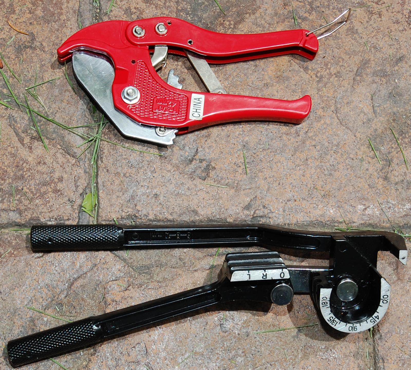

I used a standard plumbing tubing cutter to cut the PolyArmour and a cheap ratcheting PVC/tubing cutter from Harbor Freight again to cut the Barricade junctions, which made fast even cuts and only at times drew blood when I opened it back up. And then my collection of parts and tools just sat there—for weeks.

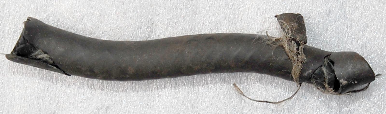

Oh, what a jolly time I had! The screw on what appeared to be a good clamp tried hard to strip, shift, anything but turn. I ended up using Liquid Wrench, which did seem to help although by that time my hands were bleeding. I bled a lot during this procedure. My elbow hit the hose from the engine cooling rail to the return line to the radiator. The hose split. Coolant dripped out everywhere, and over the next week I repeatedly knocked off the hose clamp pliers on the remnant. I had in fact providently provided those ahead of time, but every time they fell off the disintegrating hose, that allowed the flow to resume. Gas, some blood, and antifreeze accumulated on the garage floor next to—never in—the pans I’d placed to catch them.
What fun. I suppose the hose could have failed at a much worse time than in the garage, and I replaced it, too far toward the end, but when I had the skill, with a new metal one of larger diameter than the fuel line. That was the 3/8” PolyArmour I didn’t need for the fuel lines, it worked great for that with flaring and a bit of bending. The coolant had to be replaced anyway.

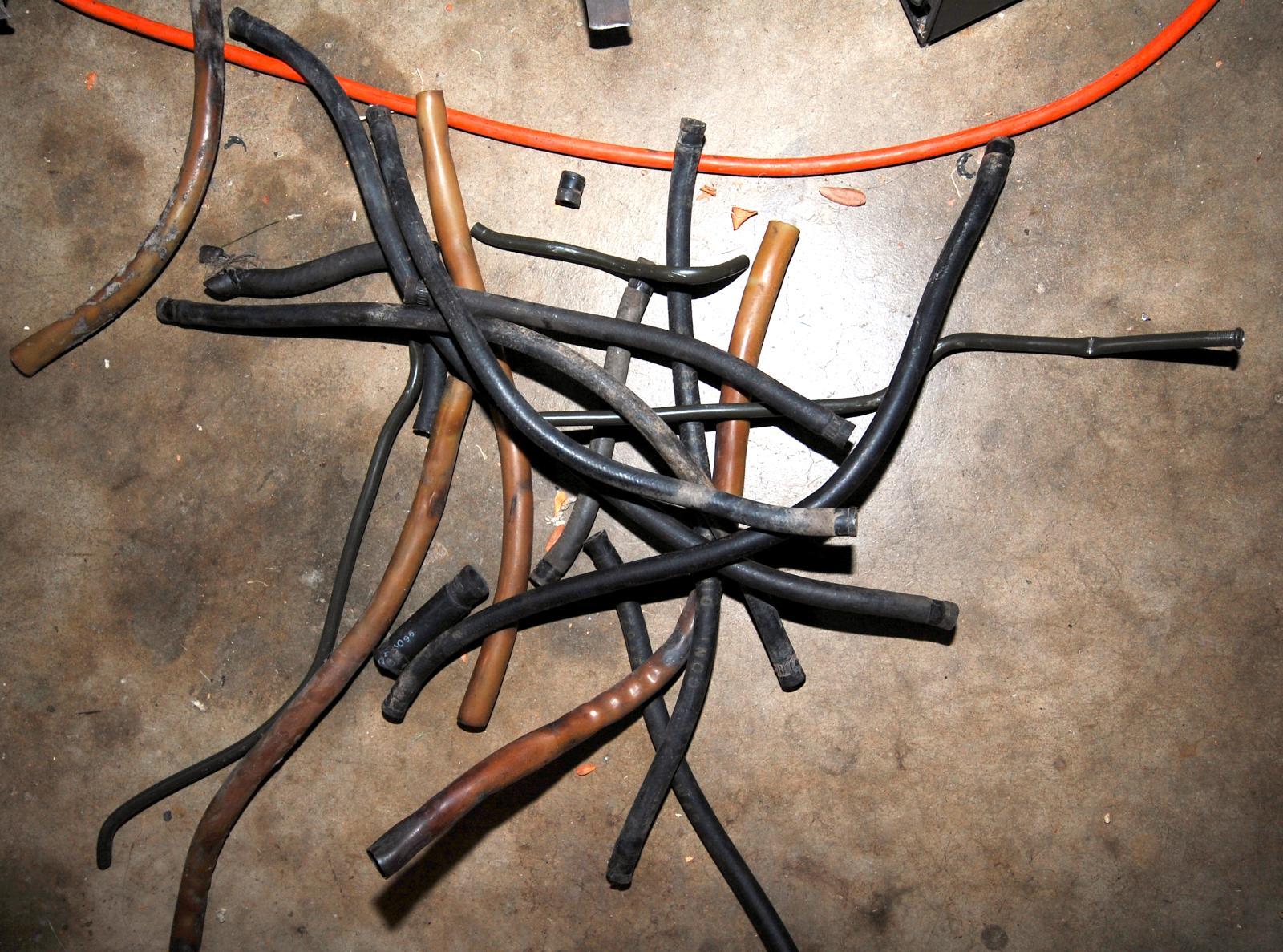

When the fuel line clamps finally started working loose, I found that there was still an amazing amount of fuel in Winston's fuel rails which dribbled out all over me and any other place that didn’t have a pan in place to catch it. A ghastly soup formed underneath Winston's engine, although I did wipe it up as I had the time. The hours wore on and I just kept going. I'd wedge the clamps higher up onto the fuel lines as they loosened so they'd stay steady as I tried to loosen them further. Finally, success and blood and coolant and gas on the first rail.
The fuel rail? It lookedbrand new, clear lettering, no cracks. The hoses attached there also appeared to be in good condition. As I noted, Nick, the previous owner, had the receipt for a line change before I bought Winston in 2006, and it appeared that they'd done a good job with good hose. That proved to be a wildly false impression. I did find some cracks on the inner surfaces of the ends attached to the rails, which I might have made with the radiator hose pick I used to remove the stubborn ones, but, you can see in the photograph the shape of the hoses.

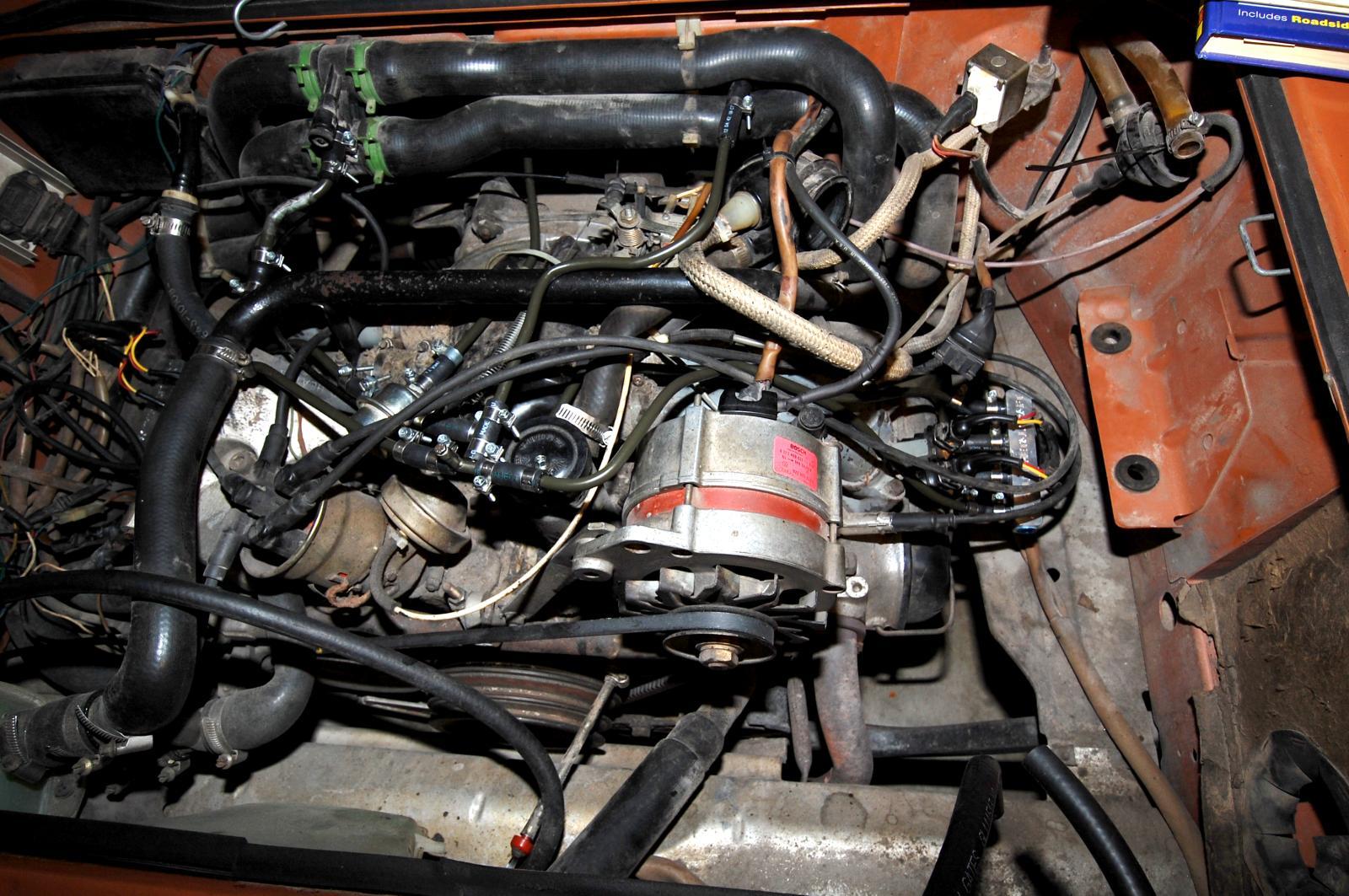

I kept going. As I'd hoped, I had much less trouble on the passenger side of the engine, where there was more room to work once I removed the AFM and air filter assembly. I started with the Liquid Wrench once I'd pulled the intake and the AFM. The solvent also seemed to work on the fuel injector retaining bolts, no troubles there.
Nothing for it but to keep on... I think the best reason to follow Ben's advice (besides the fact he's forgotten more about the Vans than I'll ever know) about discarding the end collars is that they put up a horrible fight when you try to cut the remaining lines off the injectors. Mine did, broke one X-Acto blade and blunted another.
The injectors? I forgot that you need to SQUEEZE the metal clip on the sides to unplug the injectors from the harness—about which, much, much, MUCH later— but once I figured that out, they all came off and out. They looked all right, and clean, the holes on each end were unobstructed, the polymer material a beige brown. One, though, had partly melted just a bit on one side, although the opening was clear.

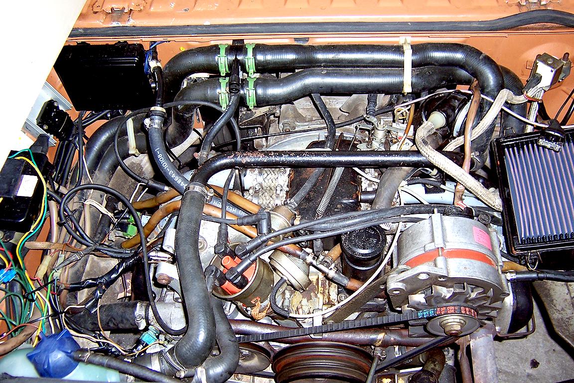

Then I looked at Chris's fuel line routing again. It turned out I'd seen some older pictures, on the newer engines he, as Wildthings has suggested, goes HIGH—three way fitting and fuel pressure regulator perched on TOP of the manifold behind the distributor cap! I decided to try to do that, with the stainless steel cable ties I bought from Napa to hold things in place. The best answer would have been to let Chris do the fuel lines on a new engine—for which, no coins, despite the C-note I saved on just leaving the fuel injectors alone.
The next day I devoted another four hours to Winston's new fuel lines. I finally got out my new billet metal fuel rails and got the injectors attached with the AB clamps which are... PERFECT. The little touches like those 7mm hexagonal headed screws made the job tremendously easier, particularly with a thumbwheel ratchet. The 5/16" Gates Barricade looks to be superb hose, I've used alcohol to lubricate cramming the hose down onto the metal fittings—had to resort to Vaseline in a truly horrid situation—but that's getting ahead of the story.
The metal rails were the ones GoWesty sells, I’d taken advantage of a holiday sale. I suppose there is no wrong way to install them, but I put the ends with the screw where the open ends on the old nylon rails had been. No trouble getting them back on, either. 1 5/8" sections of Barricade worked perfectly for my fitting connections and I got to cutting little groups of those ahead of time.
In all cases I fastened the clamps until the ends almost touched, they seem incredibly strong and the connections look very tight, and it all passed when Jim Blazer did a fuel pressure test once Winston was roadworthy. Sort of. More foreshadowing. I had one sad thought! I had thought VW's on the Green would be later in the month! It was that Sunday! Winston still missed it for the first time in four years, I did, too, making fuel line fixes while the sun shone.
I used a bungee cord to lift and hold the radiator hoses away from... the nylon bulkhead fitting. Getting the hoses off was a matter of an extension on a thumb-ratchet screwdriver, and a hose clamp back at the tank to keep the gas from flowing. As I've mentioned, my logic in replacing the nylon fitting with a metal one instead of sending the hose through a grommet is primarily to dampen vibration on either side. With the new metal lines, I want places to flex through the rubber junctions. There was definitely deterioration on the nylon original, but it didn't appear cracked.

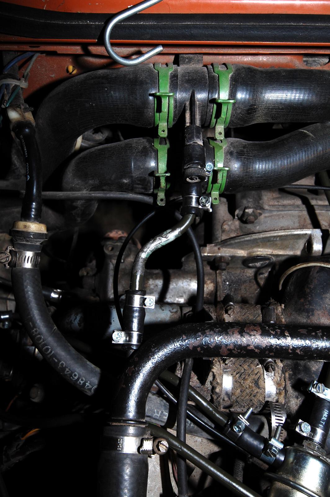

Cutting the PolyArmour with that plumber’s tubing cutter works quite well. I used that Harbor Freight deburring tool on each set of cut ends. With severe annoyance I found out that the tubing bender I had before I started didn't work—it's for 1/4" tubing. The difference 1/16" can make! But the PolyArmour is coated to prevent kinking and I managed quite a bit of bending by hand. Then I went and got a Harbor Freight bender with three mandrels and slowly, with a lot of setbacks, learned to use it.

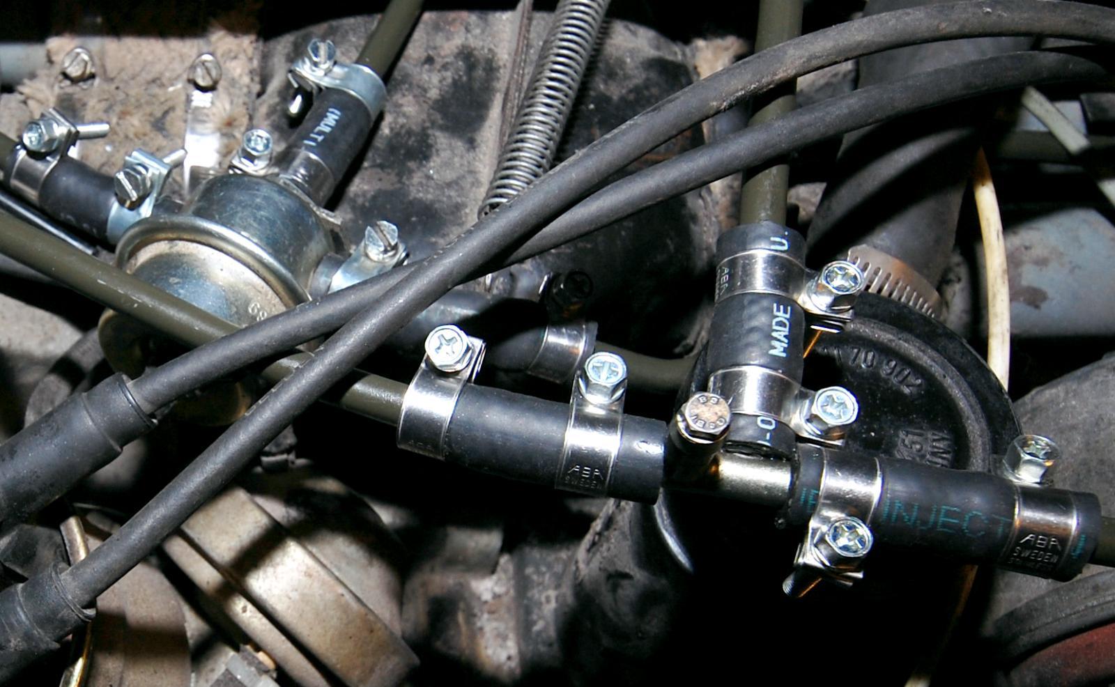

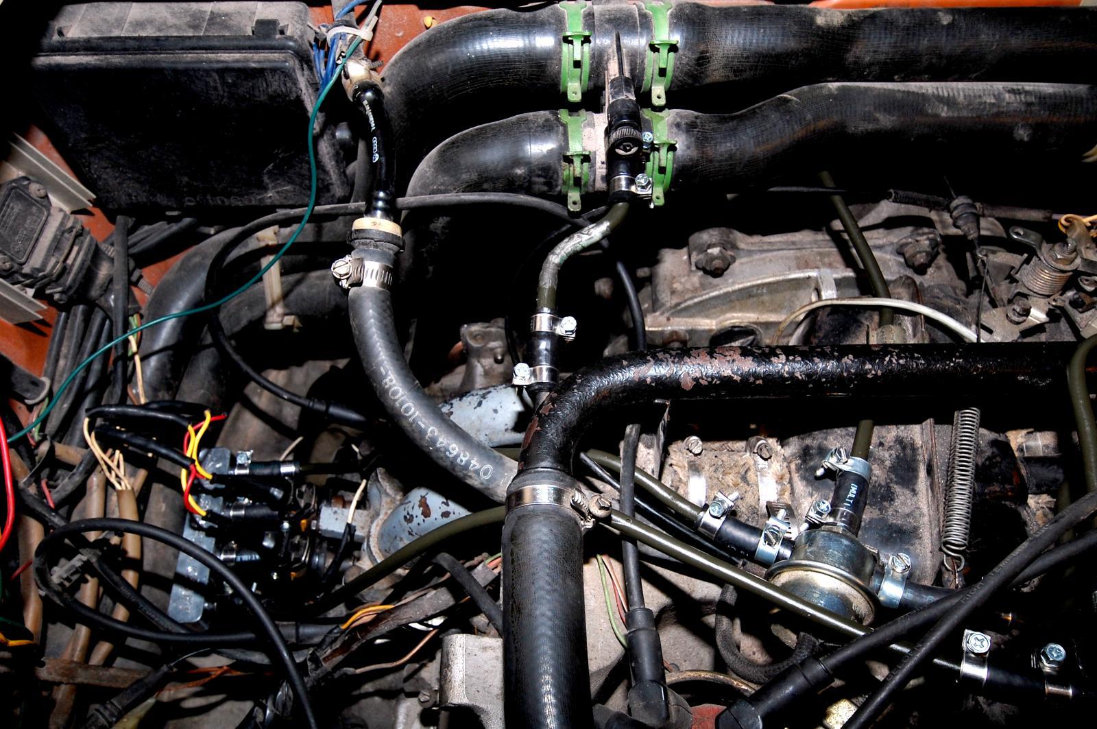

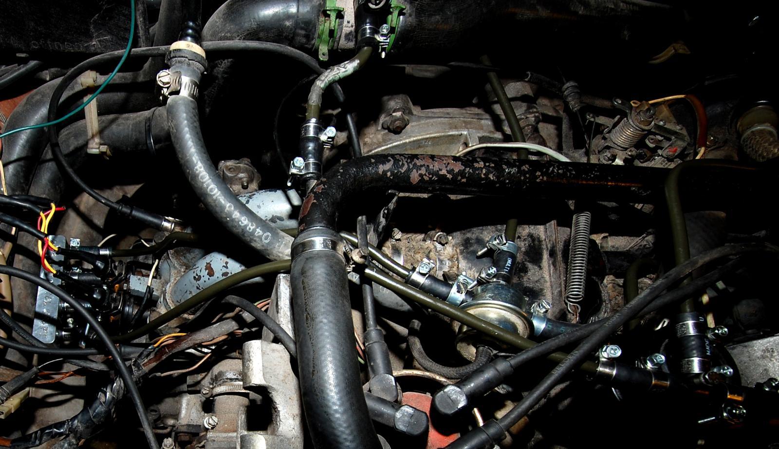

The metal fuel line went right in between the twin radiator hoses (the plastic clamp snapped, drat it, but is mostly usable). I had some NAPA mounts for zip ties, which I never figured out how to use. I got ready to clamp the connection! DRAT! The sharp edges of the clamps would play hob on the soft rubber of the big radiator hoses! I undid the whole thing! Not easily! Then I made much longer junction of the Barricade, pushed my flare into that onto the metal bulkhead fitting, and clamped well away from the two big hoses. The Barricade protected the radiator hose.
That worked. Tencentlife has the three way junction above and to the driver's side of the fuel pressure regulator. I cut enough of the hose for some literal 'wiggle room' and deburred and flared it in place... Successfully! But I was too tired to do any more that day.
I had problems still to solve—attaching the junctions and metal lines to the installed fuel rails. I was worried about making sure I didn't mix up the supply and return lines. At an Ace Hardware I found those sort of curved 'H' pieces (meant for coax) that I thought might hold the metal lines in place, with a metal or plastic cable tie to keep them together and not shifting. I never used them since the PolyArmour managed just fine without.

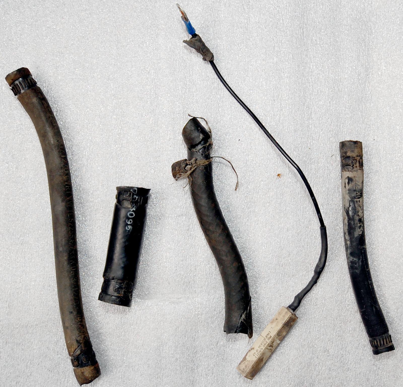

As I replaced the hoses I began to notice some curious phenomena. From surviving receipts, as I said, I know that the previous owner had the lines done. They looked good from the outside... But... there were those cheaper clamps on the fuel rails, there had been 'pinch' clamps on the 'three way' and the fuel pressure regulator before I replaced that some years ago. It puzzled me.
Also... no brown slime on the covers, which I removed as I took apart the three-way, following Ben on doing that first. The lines I found were Conti. The hoses on the three-way DID NOT LOOK GOOD. There were cracks inside, the ends were brittle...
I started feeling a lot better about doing this job, and still wondered if they did a 'partial' on Winston before I bought him? At the time, I was not sure at all. Later evidence was conclusive. THEY HAD. It’s a warning to us all that there IS something of a comfort in how much you know when you’ve done the jobs you can do yourself.

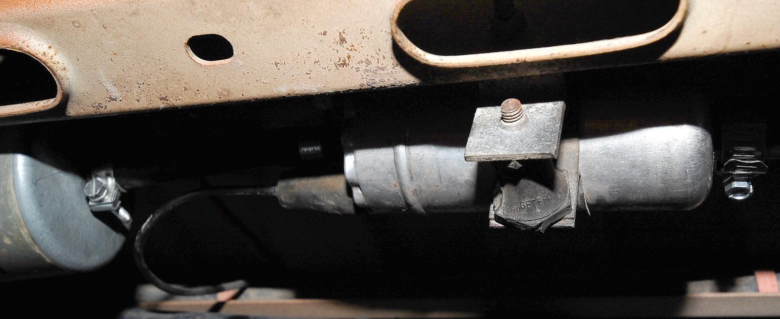

Now, a fun part I see I hadn’t mentioned comes now. I wasn’t sure what diameter of hose I’d need for the tank to the fuel pump and from the fuel pump to the nylon hose. I did some measurements, touched the area where a long time ago I’d put a resistor against the fuel pump in the ground wire to fix the cavitation, see HERE:
http://www.thesamba.com/vw/forum/viewtopic.php?p=4574029&highlight=resistor#4574029
…and one of the wires came right off the ceramic body of that four-year-old Radio Shack resistor. So I knew 1)That, as with the coolant hose, I’d been VERY blessed that it happened THEN, and 2)I’d have to do a better, more robust job the second time installing a new capacitor. I’d been wondering about the lower connections... and as I got to work on the lines through the fuel filters I came up with a solution for the sheared-off fuel pump resistor with the help of my friend the Analog Electrical engineer.
You may recall that in the original post linked above, he ended up recommending to me that I use that NAPA Echlin ICR34, which I got this time at the local NAPA for $4.35. The coil itself was open on one side of the ceramic holder, so I filled that up with Quick-Rete and let it dry while I continued work on the fuel lines.

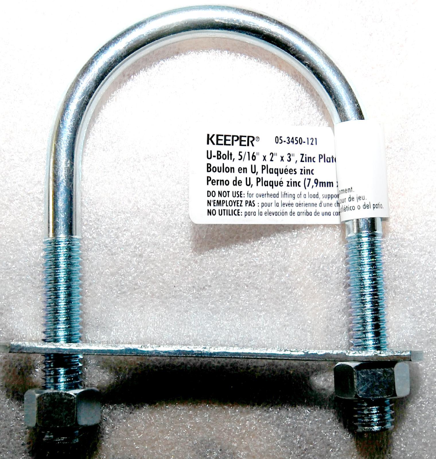

The resister came with no bracket or way to hold it. I ended up getting a 2 1/2" U-clamp (I do a lot with those)
http://www.thesamba.com/vw/forum/viewtopic.php?p=5334255&highlight=hatch+latch+natch#5334255
which I could run through two holes in Winston's undercarriage next to the fuel pump. I covered that with a piece of the best-surviving replaced fuel hose for vibration dampening, tearing a hole in one finger as I twisted it on. It just abraded away the skin.
Shocked
I ended up using a fitting and my Makita to do the twisting.
I carefully put a piece of split-open line in between the resister and the frame, and the lining of that line did NOT look good—and that was one of the best pieces. Then I put a flat washer against the plate, a toothed washer against that, slathered the bolt ends with blue Loc-Tite, and cinched it VERY CAREFULLY DOWN. When I ran wires from the pump to the resistor I left myself room with either wire to ground to the old spot in the frame, in case the whole thing breaks or falls off. I also left some room for a kill switch, a project that suddenly seems much more possible although I haven’t done it yet.
