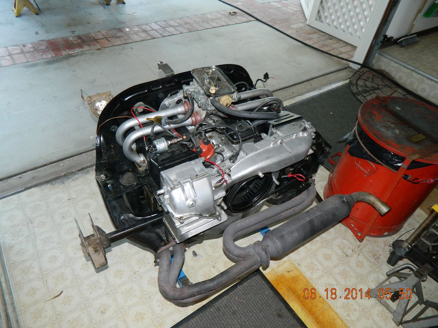

So I finally was able to get my rebuilt type 4 dual carb engine installed with some help from a pretty good VW guy but after the engine warms up it starts to blow out white smoke out of the exhaust. The installer stated it was the old gas I had in the tank, he added a couple of gallons of fresh gas with a little octane booster to help but it is still smoking after warming up. I called the builder and he stated since my engine had bad rings and valves before the rebuild that it is possible there is oil burning off in the exhaust pipe and muffler and that's why it starts smoking after it warms up. I really have not been able to drive it much because its still on non op but the power seems to be weak as well, the guy who helped me install it said that was from the bad gas as well. Anybody experience any of these things? I know valves need to seat also but the smoke seems to be more than just that especially as it warms up.

that is a hard one. Lets say that the engine was tipped on its side for awhile during the time it sat, and the muffler was on it, there could be oil in the exhaust - in which it does take time to burn it off. I doubt old gas would do that unless someone added diesel to the tank. New rings and reworked heads would not pump oil like that.
Turn it off and check the dipstick level. It is possible too much oil was added.
If you want to know for sure you may need to let it cool off and look at the spark plugs to see if one or more is wet with oil. Then you can start wondering why. Do document that you spoke with the engine builder about it and they said to run it as it is and see if it burns off.

I know the engine did not set on its side. I will check the oil level and pull the plugs to see if they are wet but will need to wait until morning. The van has been in my garage the whole time so I'm pretty sure diesel was not poured in the tank. The gas was about a year old though, I guess I could drain it and start with 100% fresh gas, the fuel filter is new and looks very clean.
