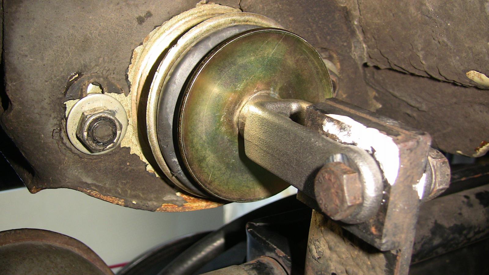

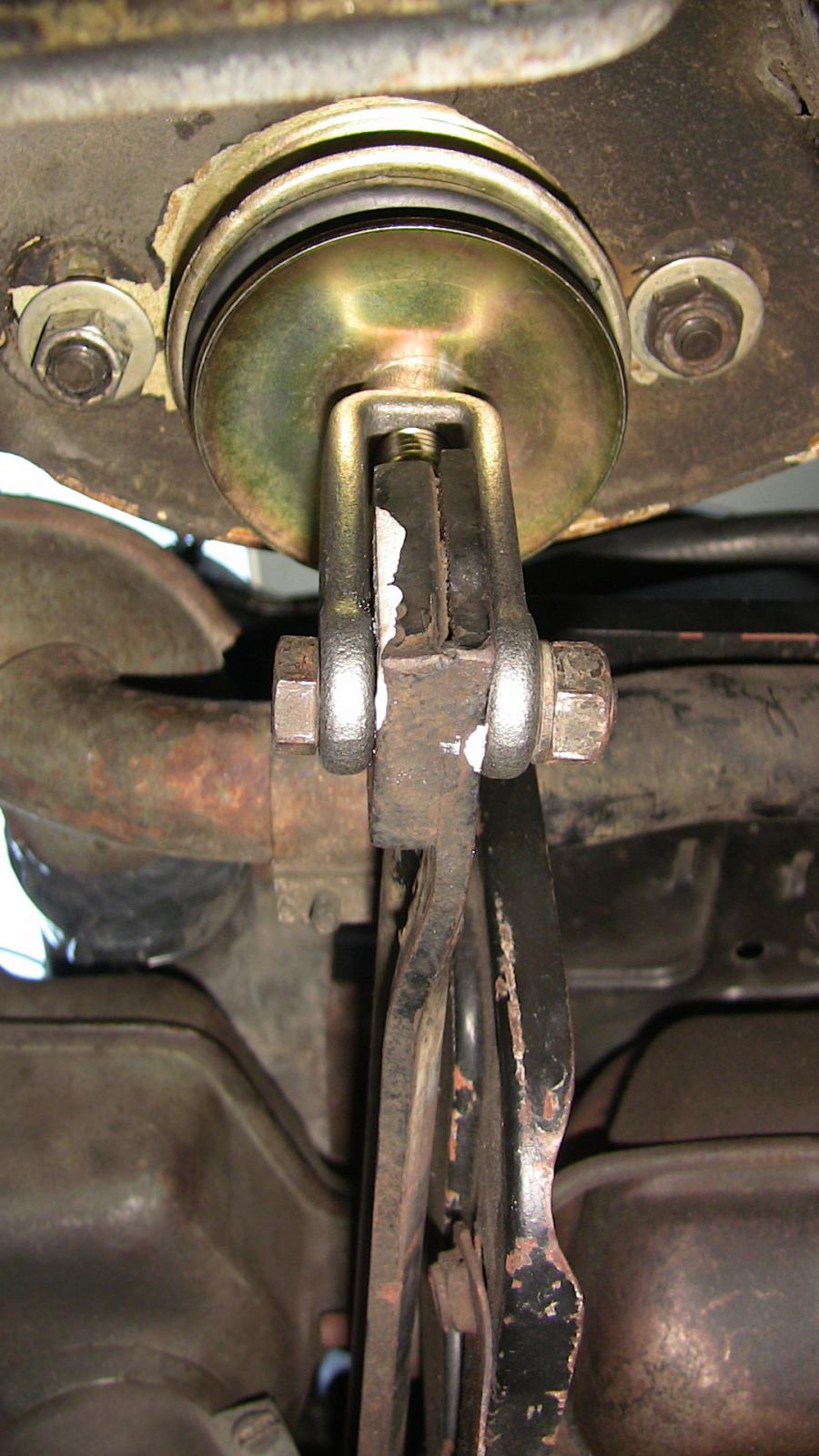

Those vibration mounts look like they could work. I chose to go w/the 911 ones partly because they were available to me and in case I ever have to replace them, they will be easy to find again. Probly won't have to replace them, though...
Here are some photos of the mount in the car:
From the engine compartment
Underneath (x2)
Detail of bolt threading through yoke end
I'm going to try setting up the other side this week/weekend to see how they perform together. So far so good with one side installed.

Bobnotch, that's a good point about having two through bolts as an added safety feature. Something I hadn't considered before. At this point, I'm still in trial mode, with one new mount and one original, to see if the new setup has problems. I was debating drilling a smaller diameter hole (smaller than the manufactured one) in the yoke end and putting a hardened pin or smaller high grade bolt through there in the top hole, if it seemed like it needed it. I'm not too keen on drilling a 2nd hole but your comment makes me think I should set up something as a fail safe, in case the single bolt did give way.
Hmmm.... Think
