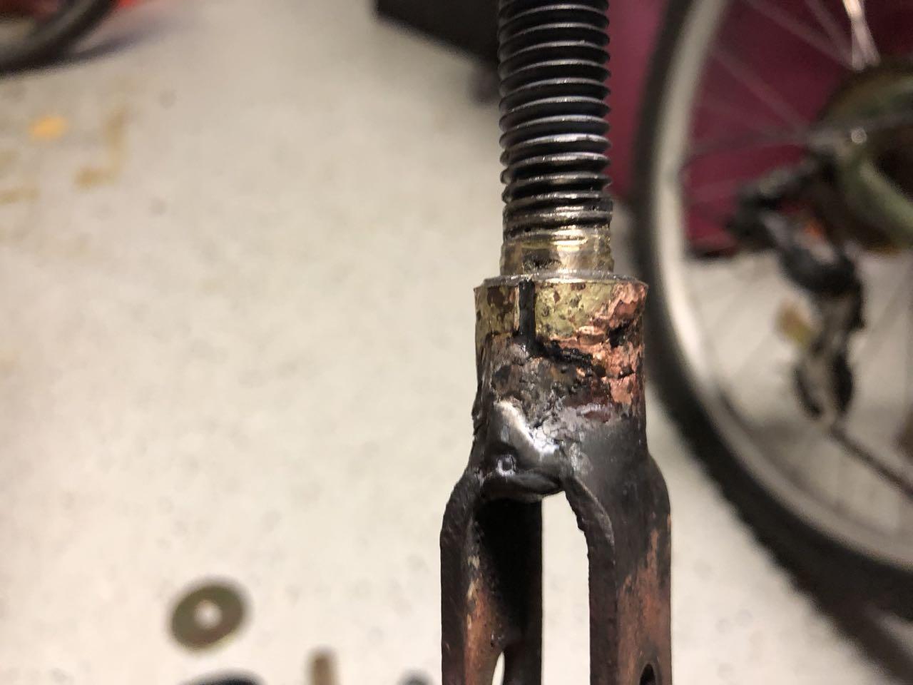

I don't have a picture of just the custom made mounting plate but you can see it below. It took a lot of cutting/grinding/drilling/filing but it turned out just fine. very sturdy, I used 1/4" because that's what the bushings called for, keeps a nice compression on the bushings when everything is tightened down.
I went to the store looking for 1/2" dia threaded rod. Most all-thread is low grade(grade 2 or lower?) = soft. and grade 5 or 8 bolts around here don't have 6" of thread on them. Luckily I was able to find some heat treated all-thread, pretty heavy grade stuff at a local hardware store.
1. cut all-thread to 6" pieces
2. cut existing body mount below the rubber so you end up with about 1/2" of tube and the "fingers"(part that mounts to the engine cross-brace. note I cut it flush to the rubber aka 3/4+" of tube left, take a little more off to allow for more adjustability)
3. tap 1/2" threads in to the 1/2" tube(not necessary, only half of the thread is cut in to the tube, alternatively you could just grind a little thread off the all-thread so it will slide in, I did it to ensure alignment mainly)
4. screw/slide the all-thread in to the "fingers" tube till you can just see it peaking out the bottom of the tube(screw/slide in 3/4" or so) and weld it in place. I would not feel comfortable with anything short of welding the two together. I feel very comfortable tapping + welding.
5. screw one of the nuts down on to the all-thread almost all the way
walla! that's the hard part(mine's painted black but you can see where I welded the all-thread to the "fingers" tube):

About the only things I'd do differently would be to add some weld to the bottom of the rod to fingers bracket, and add a nylock nut to the top of the alltheread (wound down some). I'd do those 2 things, incase the weld broke loose on the top of the threads, and the added nut would be to keep the engine from falling on the ground IF the top nut ever came loose (that's sandwiching the bushings). Keep in mind that most of the pressure is downward (the weight of the engine). Otherwise, I think that's a great solution, and the bushings can be replaced again IF needed. Cool

I trust my welds but I know what you mean. It would definitely be a good added safety to toss some welds at the end of the allthread as well.
as for the nylock nut. good idea. Either I'll add a 2nd nut to the allthread to lock against the first or will buy some nylock nuts. lock washers are nice but constant vibration could work something loose, not worth the risk.

I only mentioned adding the weld to the bottom, as at 1 point you say you could grind down a little of the threads to insert it into the finger section, rather than tap it. This being an alternative to what you did. You know someone will try to do it easier. Rolling Eyes
I suggested the nylock nut, as vibration will try to back off the regular nut, even though you used a lock washer. The poly bushing will try to move some, and that can cause it to loosen up too.
It's just a safety thing, as to why I suggested it. The last thing you want, is to be miles away from a hardware store, and loose the nut holding the engine in place. Most of us only open the engine lid, IF we have a problem, or are doing a tune up. That means that bolt assembly won't get checked very often, and probably only when you would hear some extra noise from the engine area (which might be too late Shocked ).
