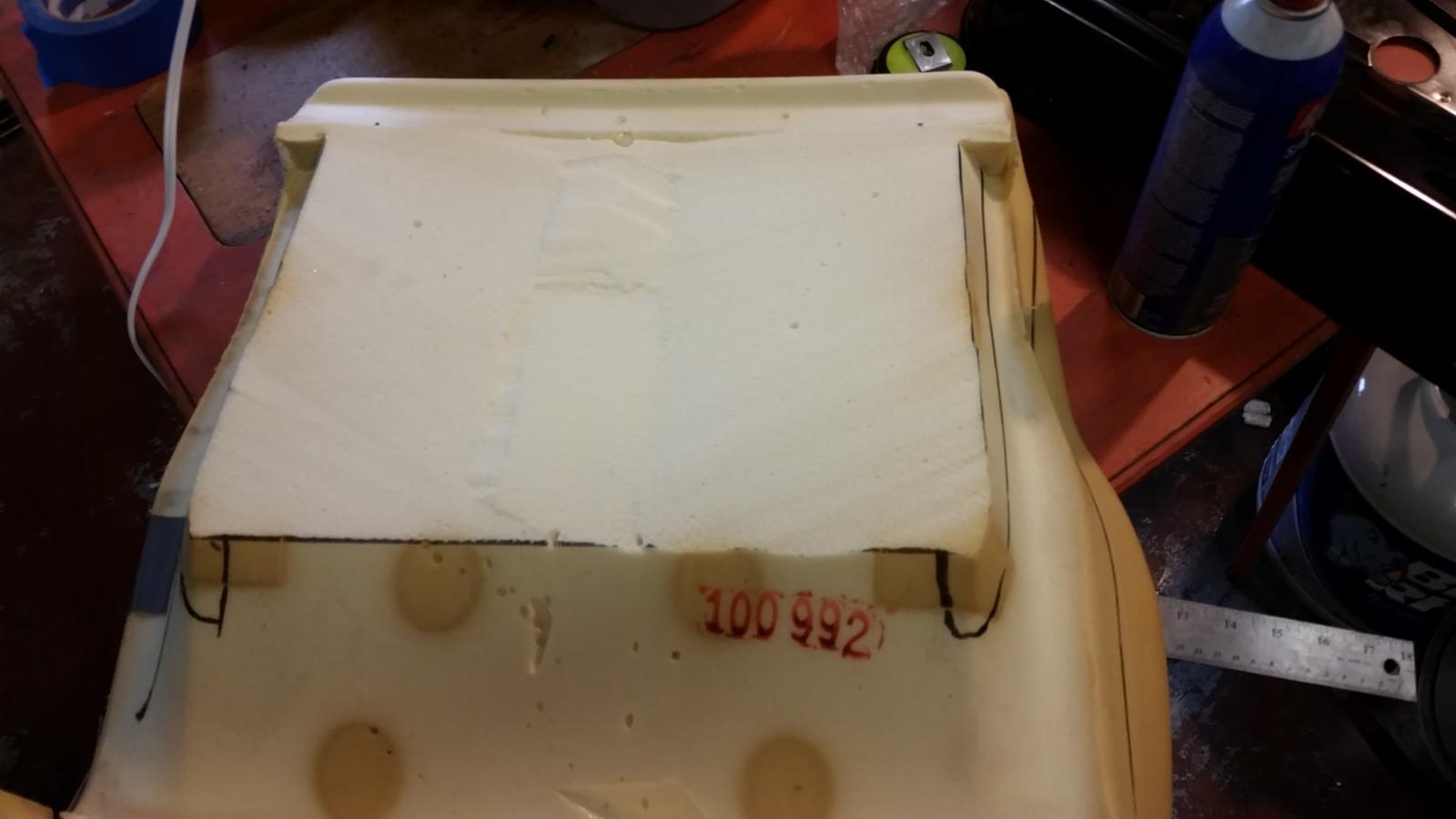

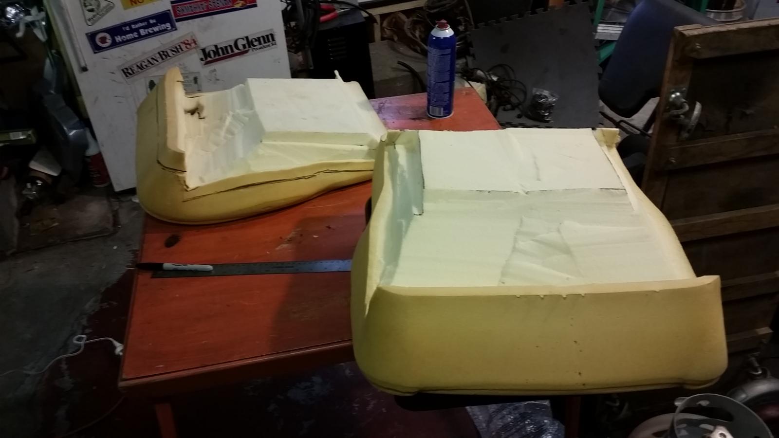

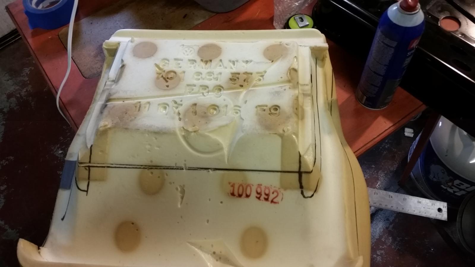

I bought a pair of seats (unfortunately they cost me quite a bit more than most of you are saying due to a dearth of Eurovans in salvage yards around me).
I'm actually going to install them in my '78 Bus but since I referenced this thread, I figured I'd throw this into here.
I cut the bottom of the foam bottoms to lower the seating position. With the passenger swivel, my head was hitting the headliner, and on the driver side I always sat a little too high with the old Vanagon seats I had in there.
I used a ruler that is 1.25 wide to mark my reference lines, then I got to work with the electric knife. It took a lot of test fitting to the pan to get the contours close enough to get the foam to sit down in the pan.
The seats aren't installed because I'm waiting for the paint to dry on my cut rails. But before I cut the foam on the second cushion, I brought both bottoms out to the bus and set them on the swivel seat. It did significantly change the seating position so that I didn't come close to hitting my head so I'm pretty optimistic that this will work well.
I'm not real great at taking lots of pics while working on a project, but here are the pics I do have.
Both seats cut up. If you look at the one in the background, you can see lines where I cut too much off the sides, and glued it back.
