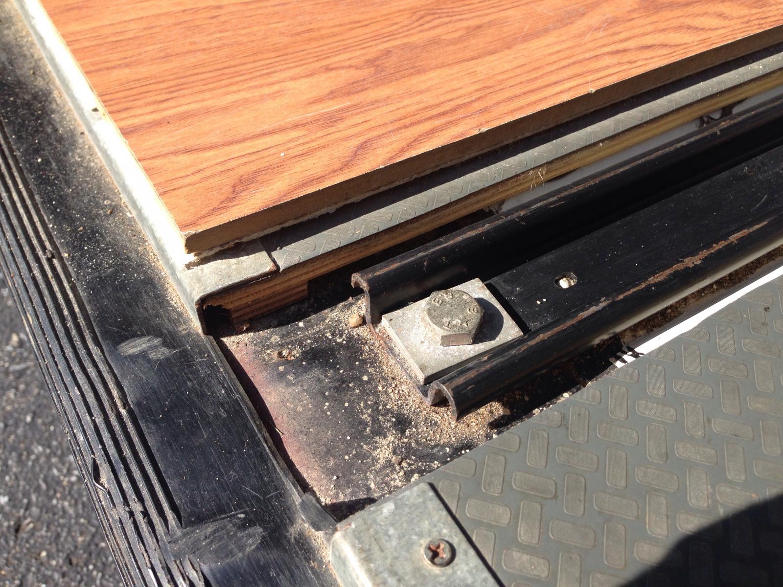

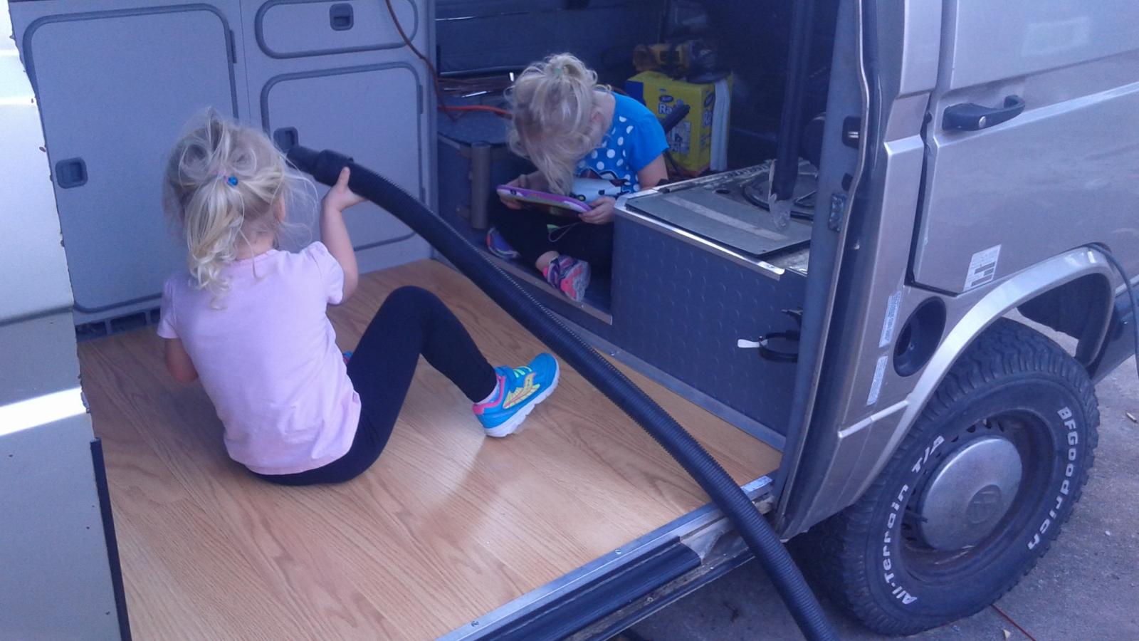

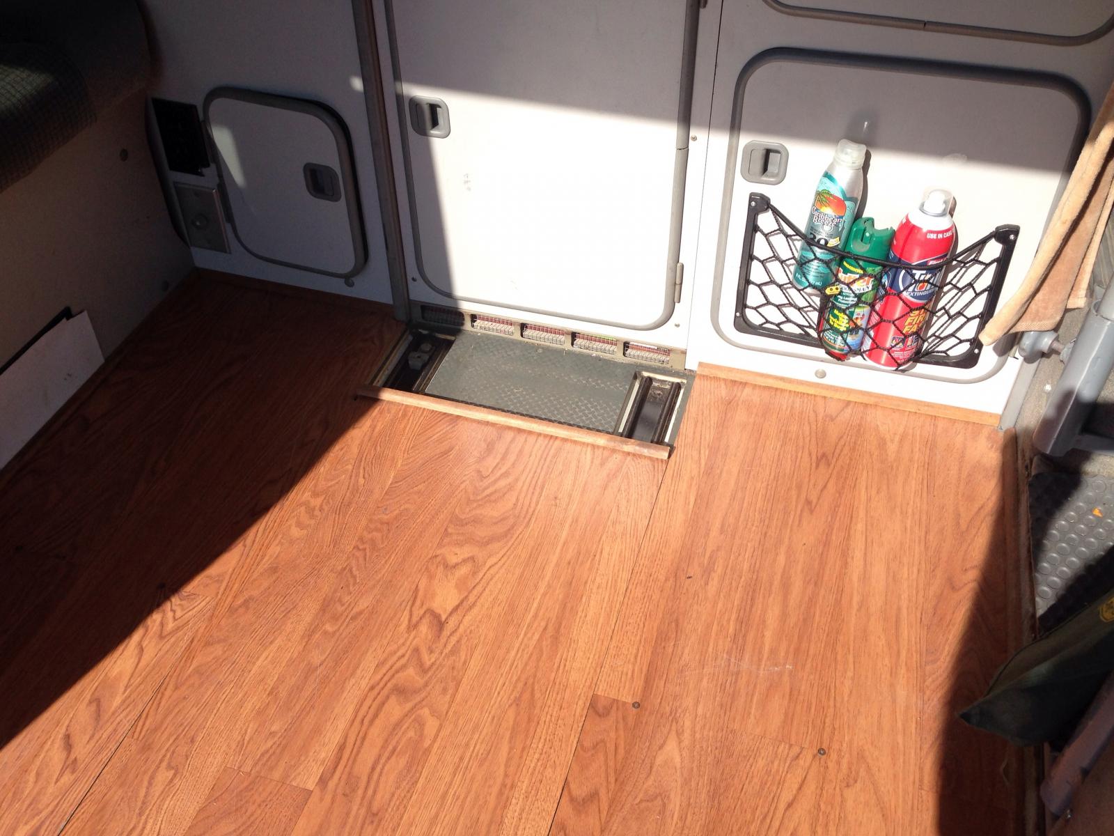

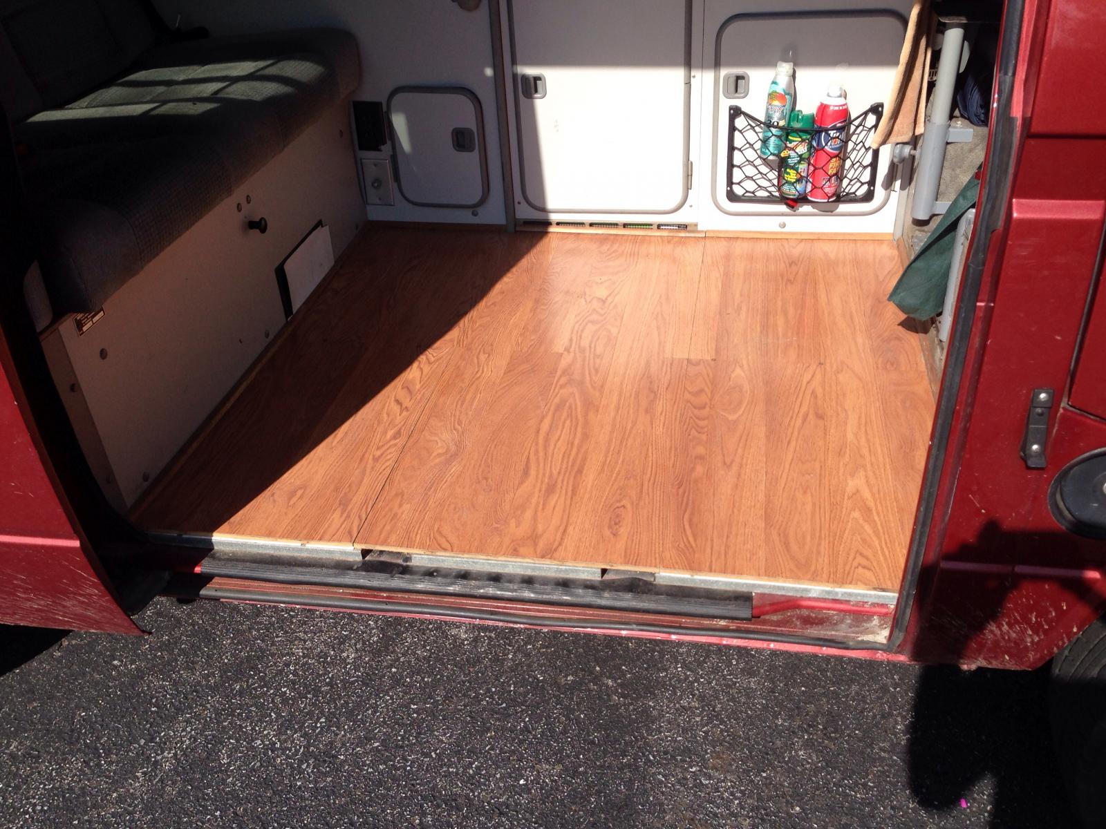

Alijonny, I am not a flooring guy, but I installed my wood flooring on a subfloor with an 1/8" gap around the edge for swelling. I don't see why bamboo would be any different than another flooring. usually there is a specific gap you should consider specific to each type of floor. Check the packaging for the gap that you need. Don't le that sales person guide you wrong, bamboo it and let us see the picture. I am sure it will be great.
I tried ABS glueing the floor down and applying pressure, but one stupid board came up and I ended up screwing and countersinking the floor to the subfloor. I've installed the same floor re-using the same floor into 3 different van's now.

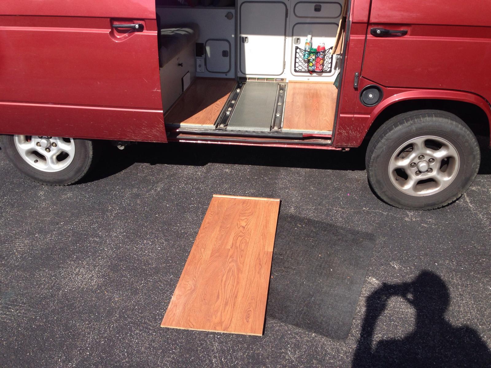

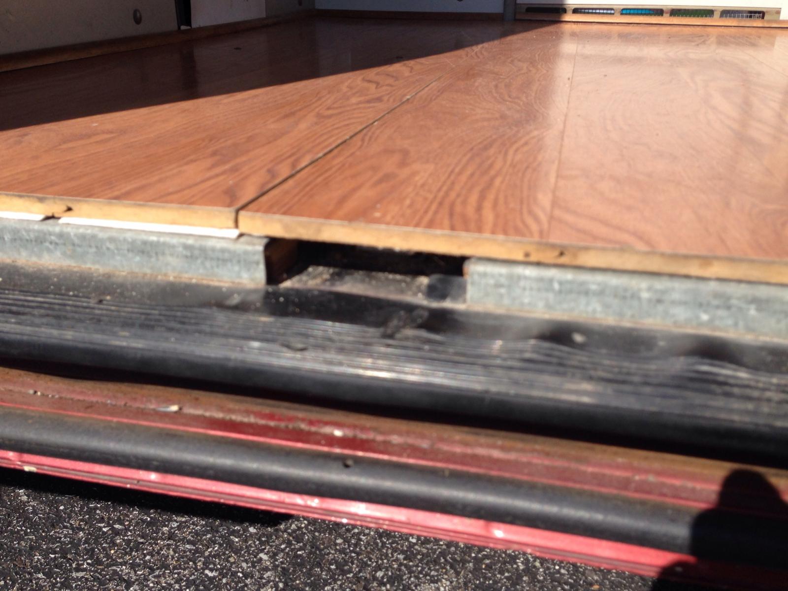

I was asked by a sambanite to post how I did the pergo on top of the seat tracks. These pics explain what I did. Basically I made it so I could remove the center section and expose the seat tracks for when I install the single or double seat. The pergo is laid directly on the stock grey floor. The outer two sections are held in place by one flush screw each.

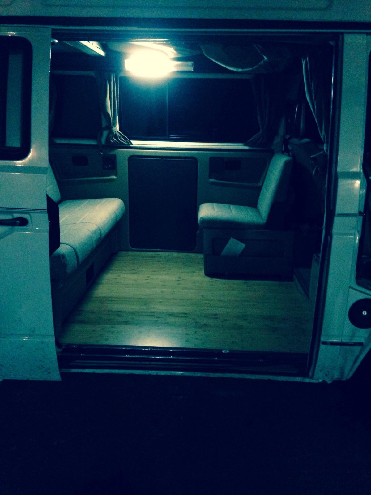

Just installed bamboo in the '86 Weekender yesterday. The install was pretty easy, I used the original floor as a template for bolt holes/cutouts. The only real issue I had is that my flooring was thicker than stock- something to watch out for!

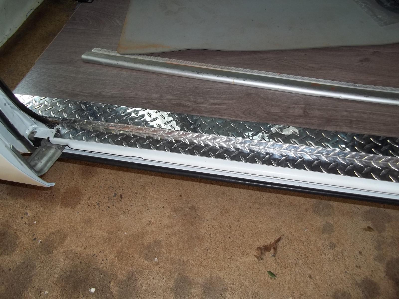

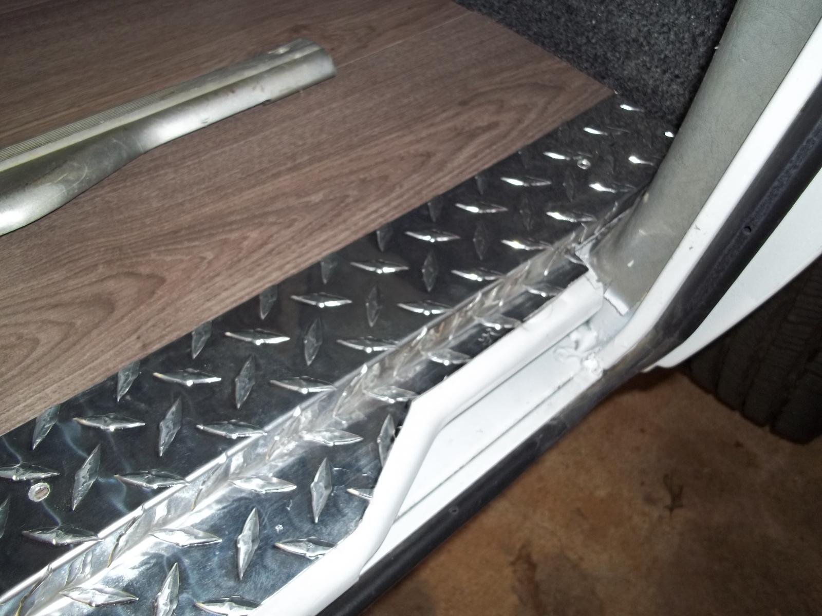

PostPosted: Sat Feb 28, 2015 2:49 pm    Post subject: Reply with quote

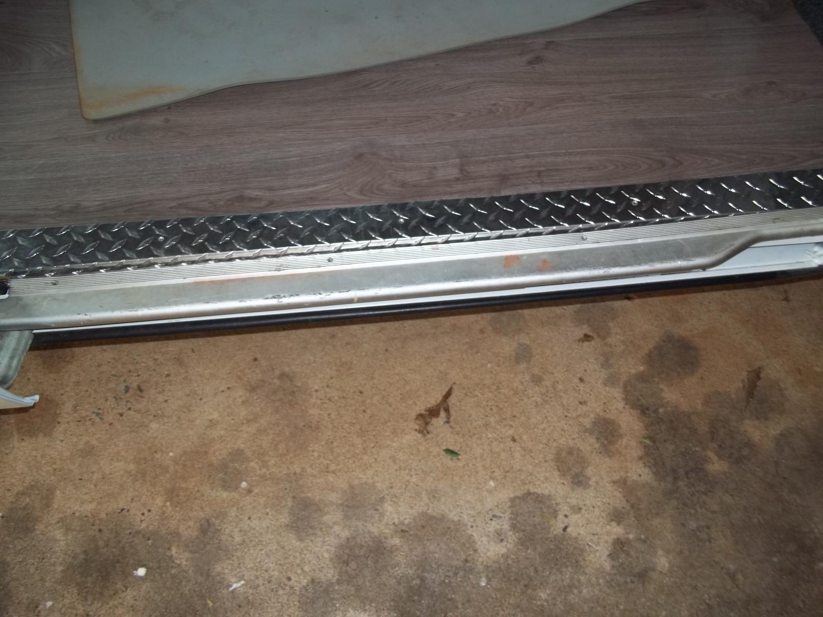

Custom threshold I made for the laminate floor. The leading edge will fit neatly under the existing aluminum threshold.
Now I am going to have to get the wire wheel out and buff the OEM threshold so that it looks good enough to fit with the new threshold.

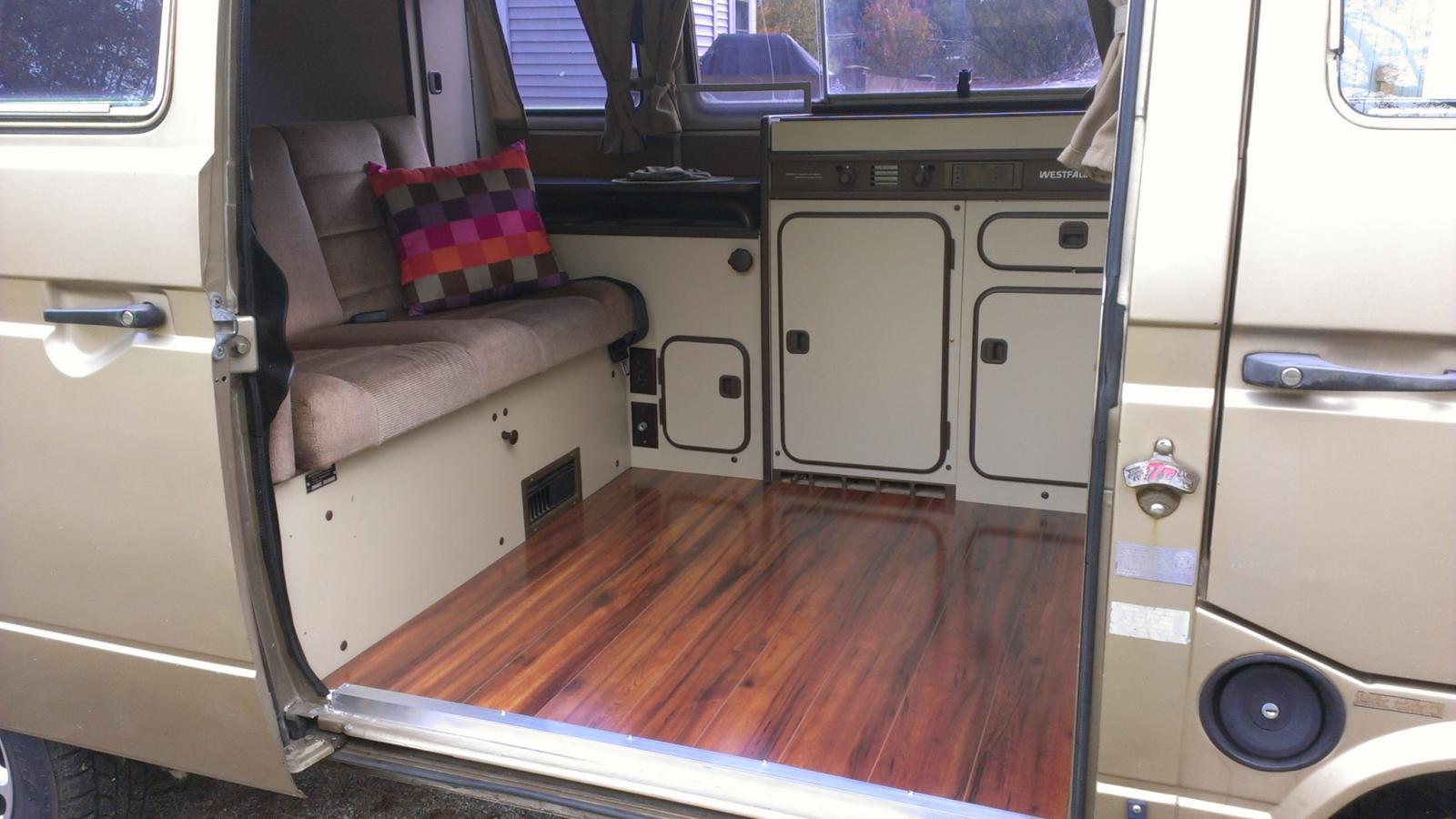

newfisher
Joined: January 05, 2012
Posts: 1764
Location: The wet spot--Oregon
newfisher is offline
PostPosted: Wed Mar 11, 2015 4:37 pm    Post subject: Reply with quote
Heres mine following the blacked/tinted theme I have going. Its a plastic snap together flooring from Home Depot Allure is the brand.
Tossed in a sew fine charcoal 9 piece kit while I was at it.
