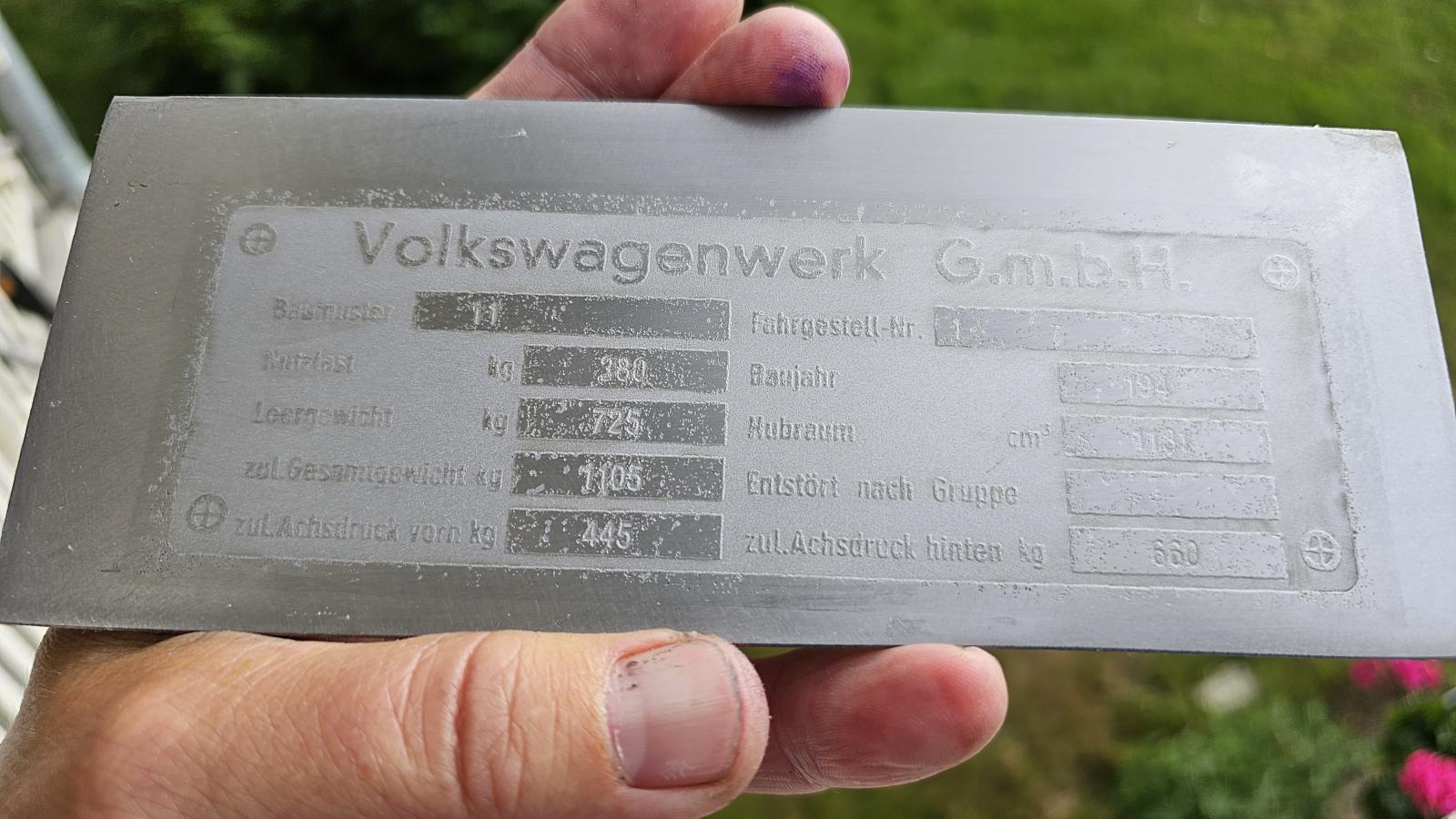

Here my first try for the early ID plate. Smile needs some more work, the process has so many parameters.

Mika,
Showing promise keep it up!! I'm sure you will figure it out. They did it before with low tech procedure Smile

That looks good Mika, I will hold off any further progress in the UK on the grounds that you will make an excellent job in the end.

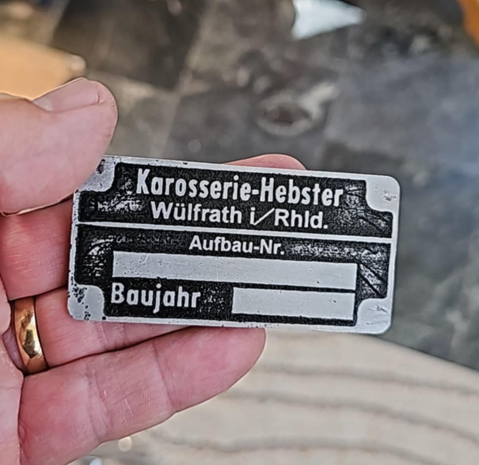

Going to do some testsamples of these etched and black coloured soon in aluminium. Are there any info what years the different weight rate come from?

PostPosted: Thu Aug 07, 2025 10:30 pm    Post subject: Re: Replacement 1947 to 1949 ID Plate Available- What Quality? Reply with quote
Yes, I know they were steel originally. Was thinking that aluminium is easier etched. However I managed to only get a first kind of good transfer of the negative print on a steelplate...
So, this is my first attempt on steel. Might try another later...

This is an issue that has never been fully resolved, and there is somebody in Sweden trying to have them remanufactured at the moment, without any luck.

PostPosted: Fri Aug 08, 2025 11:24 am    Post subject: Re: Replacement 1947 to 1949 ID Plate Available- What Quality? Reply with quote
Yes. He's been in contact with me too. We'll see what comes out from this.
This first test was not bad for my purpose as it does have a genuine patina look. However I can understand the demand for flawless plates too I know more soon when I experiment some more.
When I get the final finish on that first test it might be a perfect pair to this...

PostPosted: Sat Aug 09, 2025 12:45 pm    Post subject: Re: Replacement 1947 to 1949 ID Plate Available- What Quality? Reply with quote
New attempt..

PostPosted: Sun Aug 10, 2025 9:23 pm    Post subject: Re: Replacement 1947 to 1949 ID Plate Available- What Quality? Reply with quote
Not perfect but better than my first try. Just need to still polish it some more and I'm happy with it..

Martin Southwell

Are you going to round off the corners?

PostPosted: Mon Aug 11, 2025 2:41 am    Post subject: Re: Replacement 1947 to 1949 ID Plate Available- What Quality? Reply with quote
Yes. This is just precut for now until I finish it.
