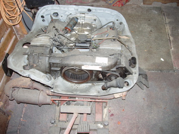

PostPosted: Tue Jun 23, 2015 2:06 pm    Post subject: Reply with quote
type I or II style

PostPosted: Tue Jun 23, 2015 3:32 pm    Post subject: Reply with quote
Something funny going on there, the VIN is for a standard microbus, yet you have a truck Confused From the metal surrounding the engine and the disc brakes I'll say it's really a 71 that someone's swapped VIN's on, be careful.

PostPosted: Tue Jun 23, 2015 3:34 pm    Post subject: Reply with quote
Something is not right. The decode says it is a 7 seater micro bus. When clearly it is a Truck?

PostPosted: Wed Jun 24, 2015 4:54 pm    Post subject: Reply with quote
Are you using the VIN off the Bus, or from the paperwork? That looks like a Euro spec or Canadian Single Cab. Paperwork shows Transporter.

PostPosted: Wed Jun 24, 2015 9:34 pm    Post subject: Reply with quote
That M code description applies to multiple models, when on a bus it means vent in slider, but when on a doublecab it means vent in door, that M plate is for a stationwagon so disregard the truck stuff.

PostPosted: Thu Jun 25, 2015 7:48 am    Post subject: Reply with quote
What is teh actual VIN for this vehicle? You don't have to give the whole thing -- just the first 4 digits will suffice to determine model and year. Check to see if the VIN on the dash matches the one on the M-code plate, and most importantly, the one in the engine compartment.

PostPosted: Tue Jun 30, 2015 9:58 am    Post subject: Reply with quote
where in the the engine compartment plate located. i found a number on the motor. vinplate on dash and door jam and m plate so far
first for of the vin is 2212
door jam plate also has date 07/71

PostPosted: Tue Jun 30, 2015 10:41 am    Post subject: Reply with quote
71/72 still have the vin stamped in the engine compartment right? To the right of the motor, just before the battery.
The original vin should start with a 26x. Also the butt looks round so my bet is for '71.

PostPosted: Tue Jun 30, 2015 12:13 pm    Post subject: Reply with quote
motor number i got h224025
vin number found on the driver side dash and door jam
started with 22122

PostPosted: Tue Jun 30, 2015 1:22 pm    Post subject: Reply with quote
That's a 71, I can see the raised area where the number will be beside the battery just aft of the aircleaner, the number will start with 261, whatever numbers are up front are for a stationwagon, sketchy.
